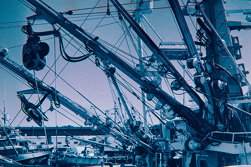

I created cyanotypes by semi-stand developing color negative film with Rodinal. Specifically I shot Kodak Gold 200 film expired August 2001 at 1/2 the box speed. Developed in Rodinal 1-100 for 1 hour with 3 inversions after 30 minutes. This is what I got after reversing a scan of the negative. The negatives did look quite dark.
attachment.php
