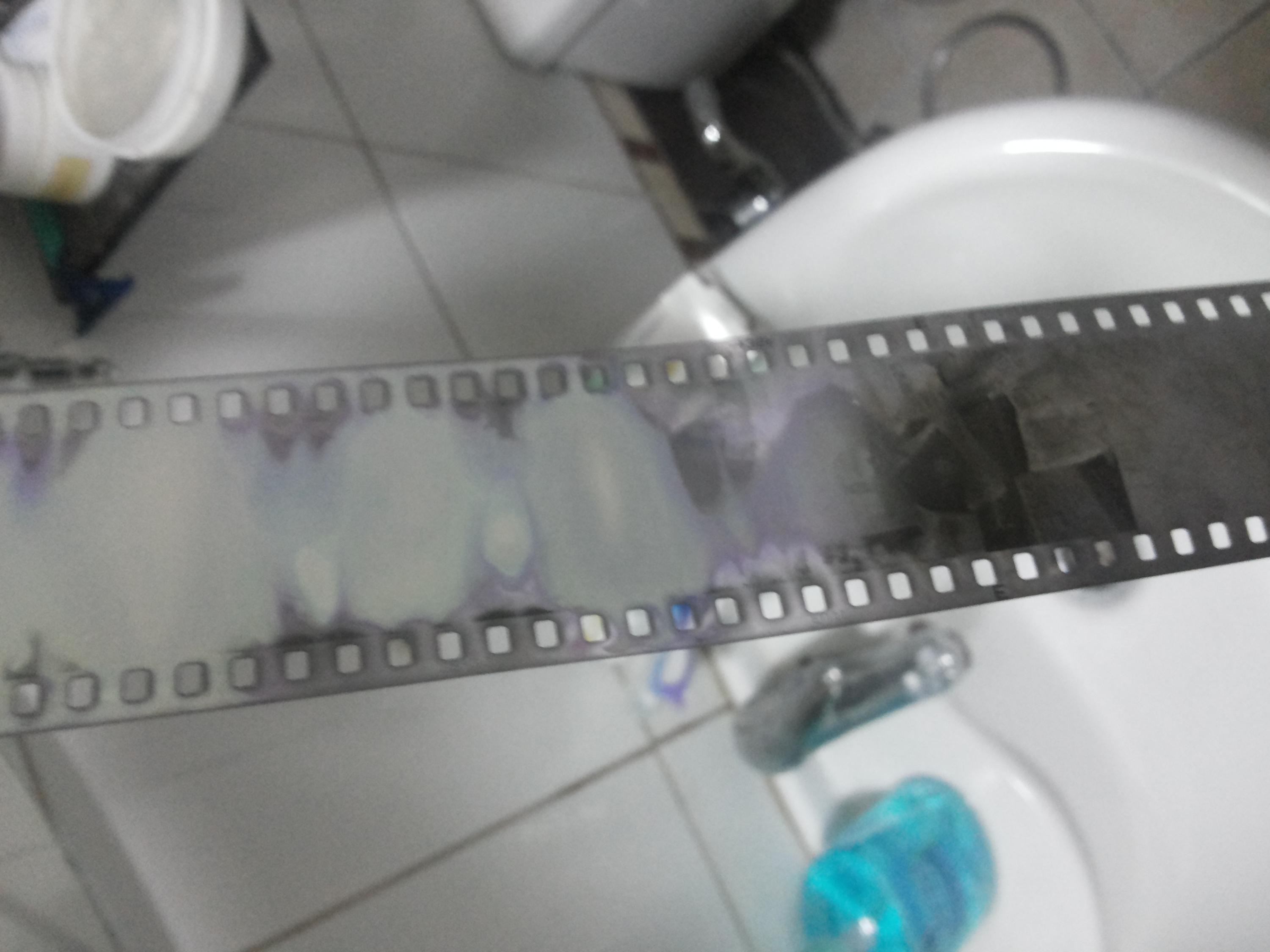

Hi all, I'm a very new BW film user and I've just finished developing my third roll. However, there's a major problem: this happened to the third and second roll:
I assume this is a problem with the film loading onto the reel? These undeveloped parts happen after around 25 or 26th frame. I'm using a plastic tank and reel. I stand develop for an hour with one minute rotation at the first and 30 minute mark using 1+100 Parodinal since when I tried to use traditional developing, my negatives came out very thin. I use vinegar stop bath. The fixer, I forgot.

Yep. That part of the film stuck to another part of the film, so the developer didn't get a chance to work on that section. Happens to the best of us - just be more careful loading next time.

Marks are definitly from the film touching itself, not allowing the developer to reach those spots. Like Vincent, I believe you should learn the basics of processing before delving into alternate procedures. If your negatives came out thin, the problem could be underexposure or under development. The way to check for this is to look at the factory markings on the edge of the film. If your negs are thin, and the markings are normal, that is under exposure, If the markings are weak as well as the image, that is under development.

Thanks everyone for the advice. I have a feeling that my reel is only for 24 exp film. The film becomes difficult to reel in after a certain point. Is that possible? Are there even reels only for 24 exp film? I'm sticking with Parodinal because D-76 is hard to get in my country. Parodinal is available and I can make it at home. I'll stick with standard developing using the Massive Dev Chart times.

Most plastic reels are for 24 or 36 exposure. They almost all become difficult to load all 36 frames. I will add here that you need more practice loading film, so keep shooting and loading, it will get easier with practice. There are many threads about your problem with loading, heres one to get you started.

Lots of people have real problems loading plastic reels, some go to stainless steel.
If you have left a film in a camera (which employs reverse wind on the take up spool) for a long time it can acquire a reverse set or memory and be very difficult to load onto a spiral.
You have to feel that the film is moving readily when you move the spiral to load film, if it jams and you use more force it will probably jump out of the groves, with the results you have demonstrated.
I keep one thumb on the film letting the film slip under thumb to monitor a for jam

I'm sure your reel will accommodate a 36 exposure roll, BUT if you are just starting out I would highly recommend starting w/ 24 exp film. It's just easier to get loaded w/ no hassels when you're starting out. A few things to keep in mind: cut the leader squarely, then round off the edges of the film where it starts into the reel w/ some scissors. Just a little will help. Also, when you're loading the film (I assume you have plastic reels), make sure you aren't squeezing them tight during the rocking back and forth action. It's really easy to do. Make a concerted effort to pull the reels SLIGHTLY apart when rocking the film onto the reel. Sacrifice a roll to do this outside of the change bag. A lot. And load the film onto the reel initially outside of the change bag, then put it into the change bag carefully. If you have a Paterson tank, don't forget to put the other reel ON TOP when you load the tank.

Make sure the reel is perfectly dry before you load the film. This is especially true for plastic reels. If there is any moisture on the reel grooves it will cause the film to stick at that point.
The film should go on with only slight force all the way to the end.
If the film seems to stop at the same point each time (before it is fully loaded), there may be a crack or other defect blocking the film from advancing.

It is possible that your reel is not totally dry when you try to load the film and this will cause a lot of problems. I recommend that you use a hair dryer on the reel in order to ensure it is dry. I would also recommend that you practice with a spare roll of film loading the reel several times until you get a real feel for the task. I have never heard of a reel for 24 exposures and I doubt if there is such a one. Loading a film is a bit like learning to drive, so many pedals to control and then suddenly it all seems so easy.

I didn't see it suggested here, but it will be well worth your time to trash a roll of 35mm and use it as a dummy for practice loading in the light. If you have a problem then, you'll be able to see what it is and work out a way to correct it. Once you can load comfortably in the light, try repeating in a changing bag or dark room until you feel comfortable there. Once you feel comfortable with a style of reel, stick to it. I tend to prefer metal reels, but I also don't shoot a lot of 35mm (a lot of people find the plastic reels easier to load with 35mm, and I'd generally agree).

Everything's fixed now. It turns out that yes, the rolls weren't being fed in right now because the reel was wet. I dried it off and a 36 exp roll slides right in. I did standard development using Massive dev chart times and the roll came out great. Thanks for all the advice!
That is good, congrats. If it ever happens again, cut the film when it gets difficult, and yes, lose a frame, better than losing lots of frames. I like Stainless Steel, Nikor, Kindermann, Hewes, because you can even load them wet and I never have a problem with them. I think some reels, at least SS do come in a 24x size, and I would get rid of those rather than find out in the dark its a problem.
