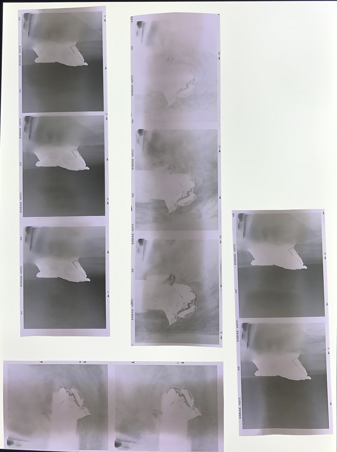

Hello, I shot a roll with a 10 stop filter and after developing got some poor results back. I believe this is called fogging, correct? I read a thread started by Greg Davis about a similar situation but wanted to post pictures of my negatives since I think mine are much worse. Sorry if this is a newbie question, but some help would be appreciated. Thanks in advance!

Some of those 10 stop neutral density filters aren't very reliable, in that they aren't very even.
Is that an optically printed contact proof sheet? If so, try printing it darker.
Can you show us the negatives themselves - a cel phone pic with a backlight works okay.

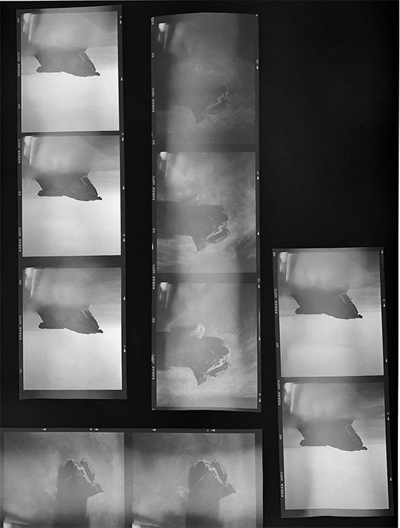

The filter is b+w, so that's probably not it right? And yes that is a cell phone pic of the negatives on a light box. Thanks.

Those negatives look like they might not have been completely fixed.
If you do your own developing, I would suggest re-fixing them and re-washing them.
They also appear to be a bit under-exposed, but that is a separate topic of discussion.

Incomplete fixing! The fog you are seeing is unfixed silver halide (i.e., the unexposed part of the emulsion that was supposed to be dissolved away during fixing/washing). Refix in fresh fixer as soon as possible and keep the negatives in the dark until you do so the unfixed portion does not print out and leave silver fog behind when you do refix.
This could also have been caused by the film not being in contact with the fixer during fixing (touching tank or itself). The fact that the image developed alright leads me to believe that you were using exhausted fix or simply did not fix long enough. However, I may be wrong here; it may simply have been misloaded on the developing reel. If that's not the case, then in the future, use fresh fix and pay attention to the capacity and shelf-life given by the manufacturer.

I just developed a roll this morning with fresh fixer and all is good. Thanks for the help! Can either of you tell me what it is about the look of those negatives that made you know it was a fixer issue vs say a light leak. Just so I can diagnose it myself in the future.

Under fixed negs have a milky / cloudy look to them. As MattKing requested above, the negs as they are not the inverted image, and there fore you can see the under fixed area on the negs.
It is hard to describe, but under-fixed areas look like a coating on top of the negative, whereas fogging looks like a part of the image.
The under-fixed areas also look a lot like undeveloped film.

There may be a fixer issue but besides I am puzzled by one corner in most frames that looks like the paper was not tightly wound on the spool on one edge letting in light???
I wouldn't jump to conclusions regarding the B+W filters they are amongst the best around under the Schneider brand umbrella.

I've been shooting more long exposures the last few days and can't seem to get rid of that. I shot two rolls yesterday with duvetyne over the camera which has minimized that a little bit, but it's still faintly there.
I shot a roll where I mixed half long exposures and half normal exposure times and that light leak only showed up on the long exposures, so I think that eliminates the problem occurring during development.
I must have a light leak somewhere, but the weird thing is I just got the camera and backs CLAd...

6X9 negatives? Time to break out the tape & sealing seams on the camera. Is it a folder maybe?
