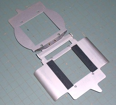

Hi all after a few emails and form filling I have managed to source a 6x6 neg carrier from Mr Cad, just have to mask off so I can use the 6x4.5 negs which leads me to the question what is the best way to mask off the carrier please??
The carrier came next day from Mr Cad and it is a Rollei one so that is great, now to build the darkroom.
I use black construction paper, taped on with scotch tape. Shown is masking of an Omega 6x6 carrier. I remove it for 6x6 negatives.
