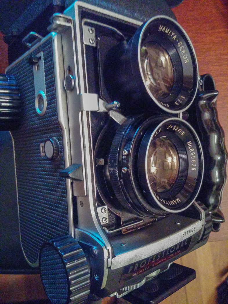

Not sure how to describe this. I have a Mamiya C220 Professional with a 80mm f2.8 lens assembly that is missing the linkage between the aperture dial and aperture setting. Does anybody have an idea where I could find this part. Or maybe even better, does anybody have such a apart. As the photo shows the screws are there. Someone in the past must have disassembled this and forgot to put it back on or used it for another lens. Any help greatly appreciated. Thanks in advance.

damson, I have a lever from a chrome 135mm lens that looks like it will work fine. It is not exactly like the one on my working 80mm lens, but looks functionally the same.
Send me a PM with your address and I will mail it to you. It looks like you are missing a screw where it mounts (only two shown in the photo, should be three total). Let me know, I probably have that also.
