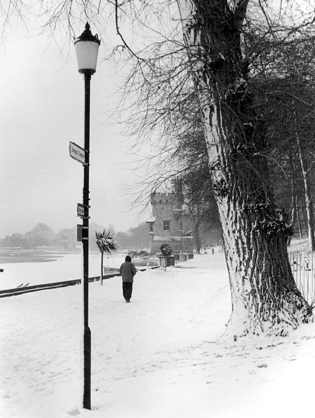

That's a good question and one I don't know the answer to.
The last time it snowed here, I used some Ilford SFX film but without the IR filter - just because it's all I had.
Some of them in my gallery. This is my favourite:
Steve.

Nice image Steve! One of my goals this year is to play more with SFX -- I never really seriously considered it before when there were more infrared options, but it seems like there aren't that many choices left.
