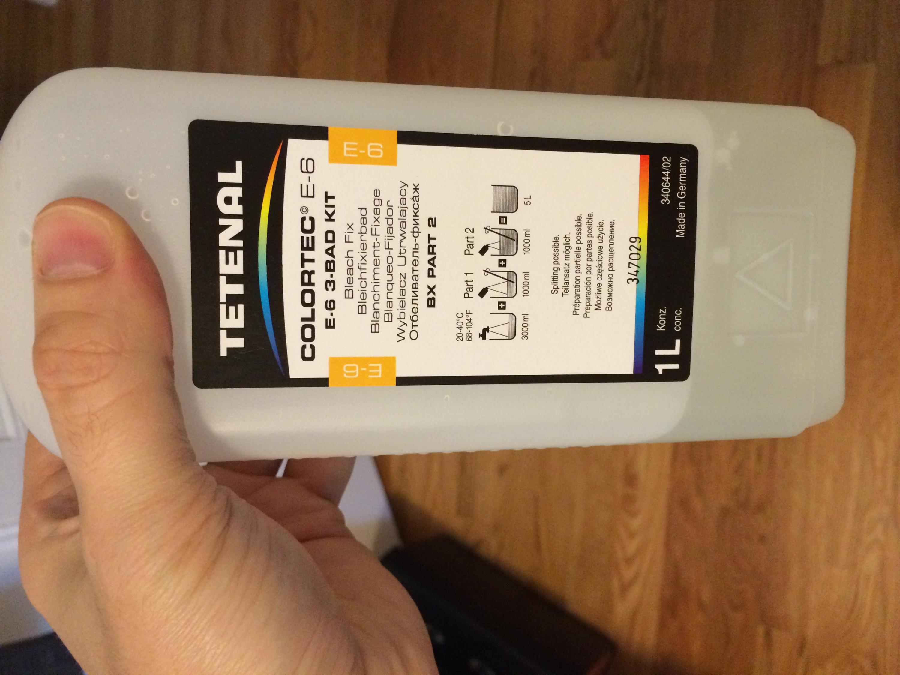

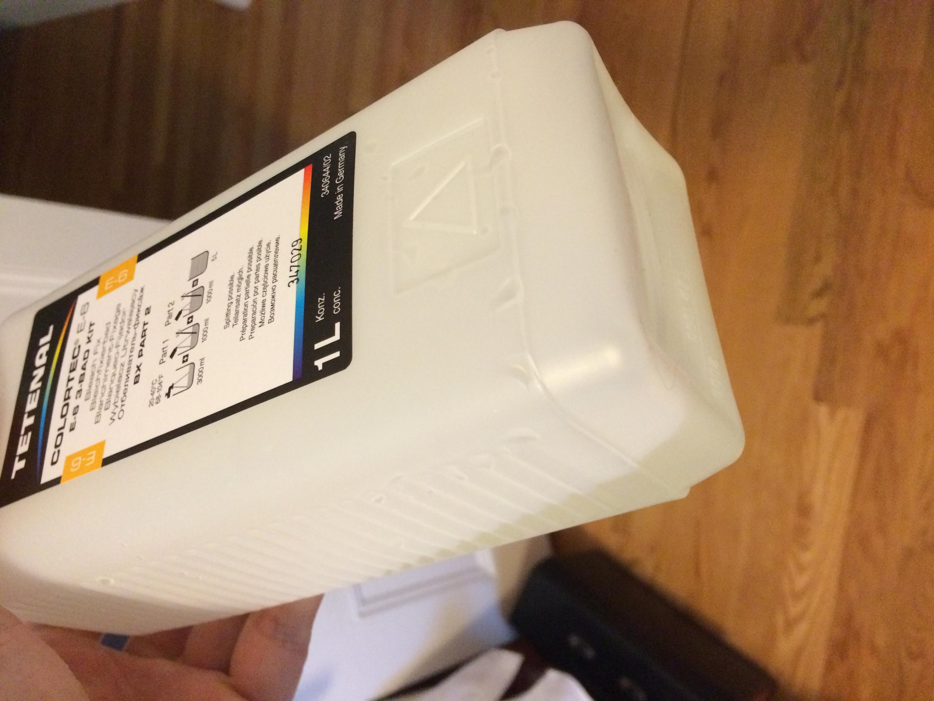

Freestyle agreed to send me a new 1litter E-6 kit. It got here yesterday, The blix part 2 bottle looks very much the same as in my previous post. I don't get it. Freestyle is a reliable source right ? Am I seeing this wrong ?
look at my previoust post here :

That's definitely not right. I took a few pictures of the blix part 2 bottle from my kit, it should be liquid with no deposits. I've ordered it a few times from Freestyle and haven't had this issue. Although, with my first tetanal kit the blix part 2 was the first to go bad (looked like your pictures) but that was after I had it opened for several months.

Thank you so much. Mine definitely doesn't look like that. I can't believe they have sent me two bad kits in a raw ....

Sadly, Tetenal's BX2 has a serious shelf life problem, and Freestyle may have some old inventory of this product. Not good. I'd say contact them and ask for an explanation. The good thing is that BX2 is always the first component to go bad, and since it goes bad in a very visible fashion, you can be reasonably sure that the other parts are good as long as BX2 looks good.
