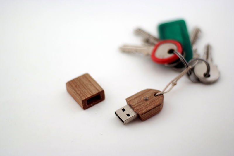

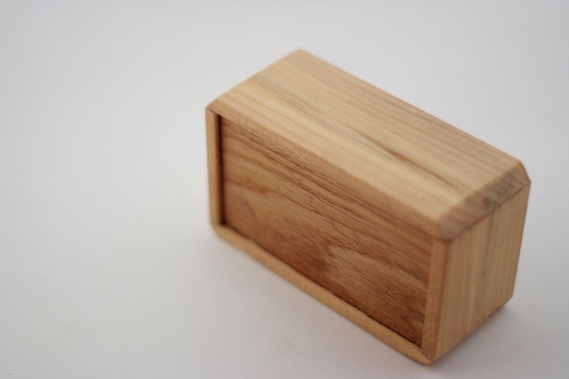

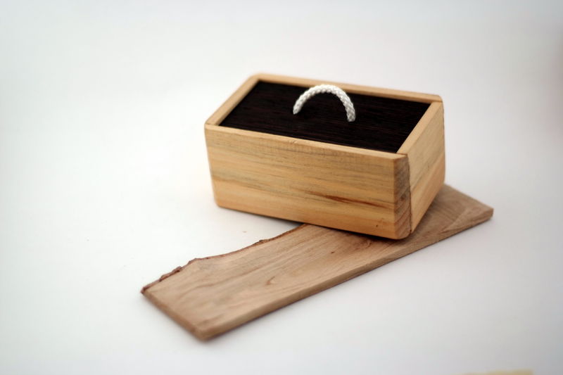

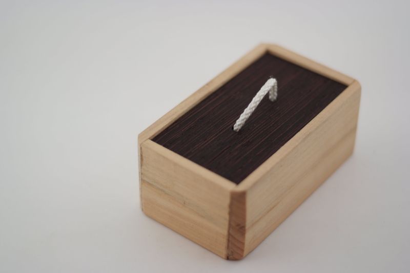

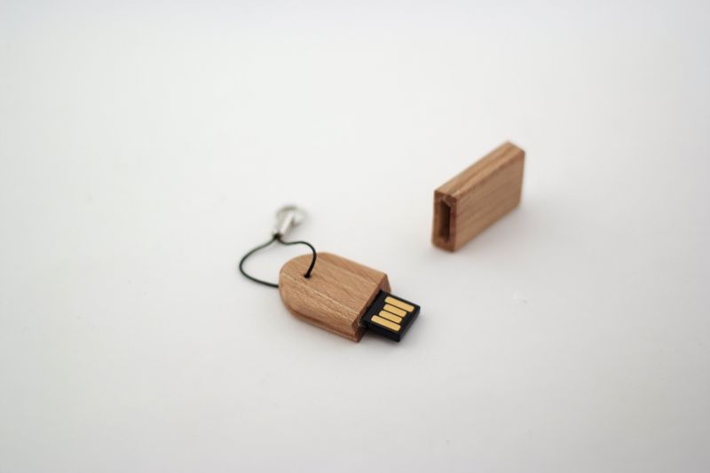

I simply like the Zero Image concept: the cameras seem lovely, they seem to work rather well, and seem worth investigating. I thought about buying one for quite some time: however, the price and shipping being what they are, I thought I could as well make my own, since I do have some limited woodworking experience. Attached are some of my DIY experiments :smile:
So, I'm still studying other people's designs in order to decide how to solve some problems (e.g. how the camera is to be closed, etc.).
