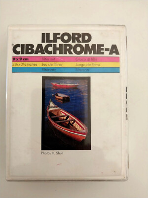

Is it this one? i think i have saw it before on a Youtube tortorial before, the youtuber didn't say the name of the set, but looks like this.

The Unicolor 3x3 inch filter sets are fairly abundant on eBay for about $20.

I think so. I’d have to go digging but those look familiar.
If you really get into color printing though you’d be better served with a dedicated dichroic head or enlarger. i think dichroic heads were made for the Focomat. Whatever works though. As long as you are enjoying yourself.
Make sure you keep those filters clean.

A Cibachrome filter set wouldn't be the best choice - as it will be oriented toward printing positives from positives - but it may be possible to use one, as a close to last resort choice.
