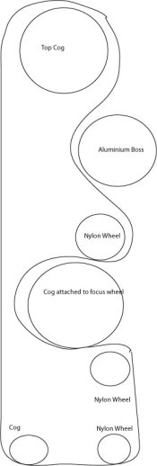

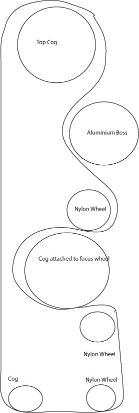

I've tried Odyssey, bought the manual etc. but I'm still having no joy. I have a free standing 504 and in order to get it in the house had to dismantle the base board and the base board stand. This meant that the chains in the drop bed base became disconnected from the lens and neg stage focussing wheels. I've put the chains back in what appears to be a logical order but there's just too much play. Does anyone have a floor standing unit that can have a look at the way the chain is threaded through the various cogs and wheels.
The only details in the manual are for the cables in the actual column not the chains in the base.
I just went into the darkroom and checked out the R/H side (looking from the back).
The chain comes up the left side skimming the panel and loops left to right over the top cog. This cog has an axle that on my machine comes through to the front above the base board. (Clockwise)
After coming clockwise over the top roller it goes to the left of a solid bush. (anticlockwise)
Then it drops down to go around a plastic roller on the RH side of the roller. (clockwise)
Then it drops down around a geared cog anticlockwise.
Drops down and then goes around another roller on the RH side (clockwise).
Then it drops to the floor and the set of rollers in the foot.
I know this is difficult but if you print this out and stand behind your enlarger this is what you will see on the right side as you look at it.
Mick.
Thanks Mick. That's exactly how I've got it! The strange this is in the manual it says that to tension the chain turn the screw clockwise that goes into the side of the solid bush. You have to loosen a screw at the front first, the one that has a slightly elongated hole. However because the chain goes anticlockwise around the solid bush, turning the screw clockwise the slackens the chain.
The other thing I need to check is for wear on those nylon wheels.
Well unles the drop board base has been up and down like a yo yo on heat, I doubt whether the nylon wheels would have any wear and tear.
My own unit saw work for close to 20 years in a commercial lab, the drop table assembly is as tight as you know what!
Mick.
anticlockwise with respect to the front or the back...? Could it be frame of reference problem?
Sparky, The only way you can see the layout is from the back. Here is a very crude drawing of how mine is threaded.
Right hand side viewed from the back (this is the lens board stage)
