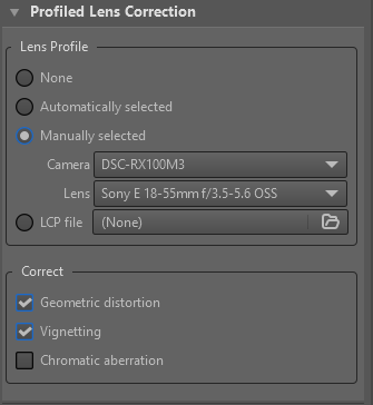

I recently purchased a Sony Cybershot DSC-RX100 III with a sharp "Vario-Sonnar" lens, but the RAW (.arw in this case) images are severely distorted, and "Correct camera distortion" in Photoshop Elements doesn't work well, so I need another program for this, that has the distortion profile for the Sony Cybershot DSC-RX100 III. A search gave no good results, and a plugin for Gimp just made the program crash. Any tips in the right direction are welcome.

Give RawTherapee a try. It's free, so all it takes is downloading it and seeing if it does what you want. I use it rarely, but as I recall it does have some distortion correction functionality.
Heck - let's just fire it up and check - here's the cameras it has profiled lens correction for:
It also has a whole slew of profiles for Sony lenses. Here's what the dialog looks like:
In addition, there are also several manual corrections in the same menu area.

I played around in RawTherapee and it works well. I downloaded Imaging Edge Desktop, but it asked to download another exe file that had chinese characters, and it didn't feel safe.
