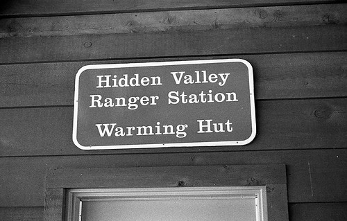

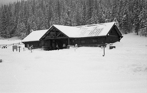

guys, thanks a lot for your responses and advices. Film grain of your photos does seem to be pretty fine, which is not characteristic of mine.
Please see this, which was exposed at EI 160 but developed in HC-110. http://www.flickr.com/photos/19thavenue/3546031902/sizes/l/in/set-72157606500890856/
This one was exposed at EI 400 and developed with RHS: http://www.flickr.com/photos/19thavenue/3271204485/sizes/l/in/set-72157606500890856/
Did I screw up on something that prevented me from obtaining a clear film base? I suppose the a clear film base is vital to get a good scan, and I have found that scanning and post processing Retro 400 is a much easier task than R3.
Thanks a lot again

Especially the low light scene should be outragious for the R3 film. It has an extended red sensitivity to 700nm and it should give you the full iso rate speed under these (artificial) lighting bulbs.
I suppose this is 35mm (??) but it looks like the film has been fogged. Maybe one of the reasons your film has not a completely clear base. And by clear base I am meaning 0,02 log D. (= real clear!)
You have to load and unload R3 in subdue light due to it's clear base because otherwise you will have a light piping effect. But this can only happening with the first 5 images. This film looks like it's fogged - pre-exposed. There is no real contrast and you have grain.
Something is wrong........

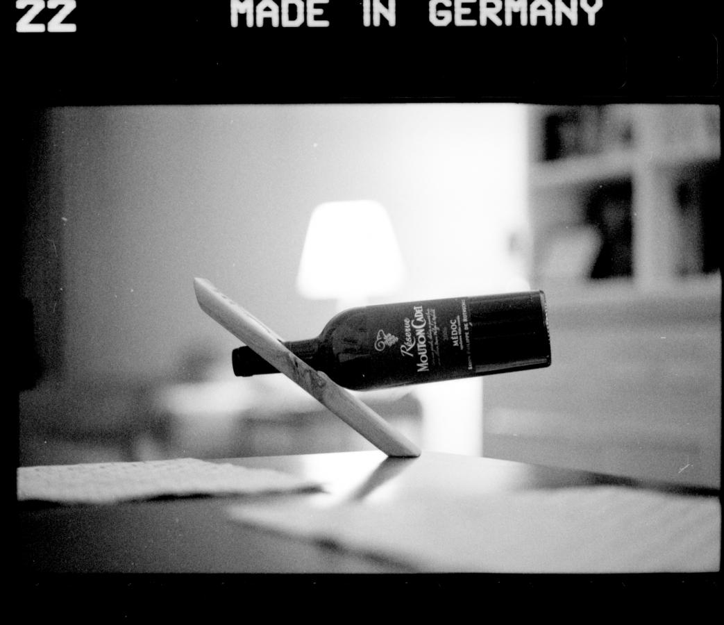

RobertV: Thanks again. Those two shots were indeed 35mm film. I want to say all, but at least most of the R3, as well as other rolls of films, were loaded and unloaded under shades, if not indoors. I can attest to that piping effect that you mentioned. See the attached example. But very luckily it didn't spoil as many frames as you mentioned.
Yes that's the phenomanae.
