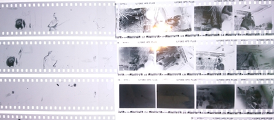

For reasons that aren't worth explaining, I'm on the road with a single-roll Paterson tank, a changing bag, a bottle of American HC-110, and a whole bunch of rolls of AristaEDU 400 shot at 3200. I'm well aware that that's nobody's favorite combo, but that's what I've got. My goal is to recover those latent images before I have to fly.
I learned that I have a problem when I guessed at what I thought would be a reasonable development time, and got completely unusably thin negatives. For that, I tried dilution A (1+15) for 11 minutes, 20s initial agitation + 3 inversions every 30s. The images are basically lost. The leader is fully darkened, but clearly thin when held up to a light. This tells me: "needs more development time."
I also had some HP5+ rolls, also at 3200, which developed very nicely with the same process for 9.5 minutes. So the developer is good.

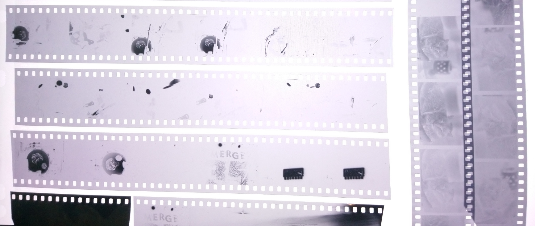

I shot a test roll of Arista and cut it into 4 strips:
  • first, I tried nearly doubling the time: 1+15 for 20 minutes. They look pretty much equally thin. Still completely unprintable. This was a surprise, I thought doubling the time might over-develop.
  • second, I tried semi-stand: 1+99 for 50 minutes, with 60s hard shaking at the start and at the halfway point. This looks more or less identical, practically no image recovered. Again, if there was anything in the shadows I would have expected it to come out.
The other two test strips are sealed awaiting better ideas. So... any better ideas? Otherwise I'm going to try 1+15 for 30 minutes and semi-stand in 1+31 dilution.
I ensured at least 6ml of HC-110 concentrate in all attempts. Semi-stand was exactly 6ml, the others were 36ml. All rolls are brand new, though I note that Arista doesn't print expiration dates??
I fear that it really didn't get enough light to even produce a latent image, but I have seen images around the net indicating people have successfully pushed Arista/Foma 400 to 3200. I get that it will be crazy contrasty, which is fine, as long as there's... ya know, an image.
The attached images give a rough comparison. It looks slightly better than reality after the cell phone processing... in person, I struggle to tell there's anything in some of these frames. The first is the three Arista attempts, the second is Arista vs HP5+. When only looking at the Arista you might think "yeah, there's maybe some image here", but compared to HP5 you can see that truly nothing came out. These are same camera, same place, same settings, same lighting.
Thanks!

As rebranded Foma, I have shot Foma 400 at 800 and one time at 1600 but never at 3200. My best guess would Dilution B at 20 mints, agitation. To make sure you have an image you can add another 5 minutes or so. If you have light tight darkroom you can try a test buy scarfing a strip of film, lower it into the HC 100 bit by bit every 5 mints for 6 strips and see where you can an image. With a 3 stop push you not much in the way of shadow details so look for highlights.
koraks
Nov 29, 2018
22,696
Europe
That's it. You're SOL.

While not suitable for darkroom printing, surprisingly thin negatives like yours can be recoverable via hybrid process. You didn't mention what you are going to do with them.
I think this might be the real answer to why people are claiming it works to push. The shadows are not entirely clear, they're just unbelievably light. A good scanner might be able to recover quite a bit of image. Unfortunately, I only do traditional printing, so I'm not going to have such luck. I do have an LED enlarger head, so maybe I can decrease the power enough to eke out a little detail.
Ultimately, I went with the most aggressive of my four attempts: 1+31, 50 minute semi-stand with with 1 minute of hard agitation every 10 minutes. It's certainly not good, but the images... exist.
This film must be "thin" even in the best of cases. The leaders, which are fully daylight-exposed, are light enough to see through. Not sure if it can get darker in some other developer formulation. For my purposes, I'm going to consider Arista/Foma 400 as unsuitable for use in the traditional darkroom.

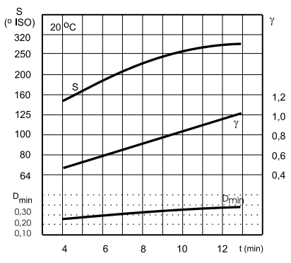

this is the datasheet graph (for d-76, the others have a different curve but they all flatten towards 320ISO), there's no way it reaches 3200.
Or, better: you can probably have some faint image if you read the shadows and are generous with the light and you use a scanner and a generous amount of PS curves.
It may be, however, a good thing if the wanted look is blocked shadows and high contrast, nothing wrong with that.
Plus, iirc hc-110 generally gives small contrast in the shadows and high on the highlights, the opposite of what's needed to push a film. Maybe it's better to look at some stand development hoping for compensation by exhaustion?
