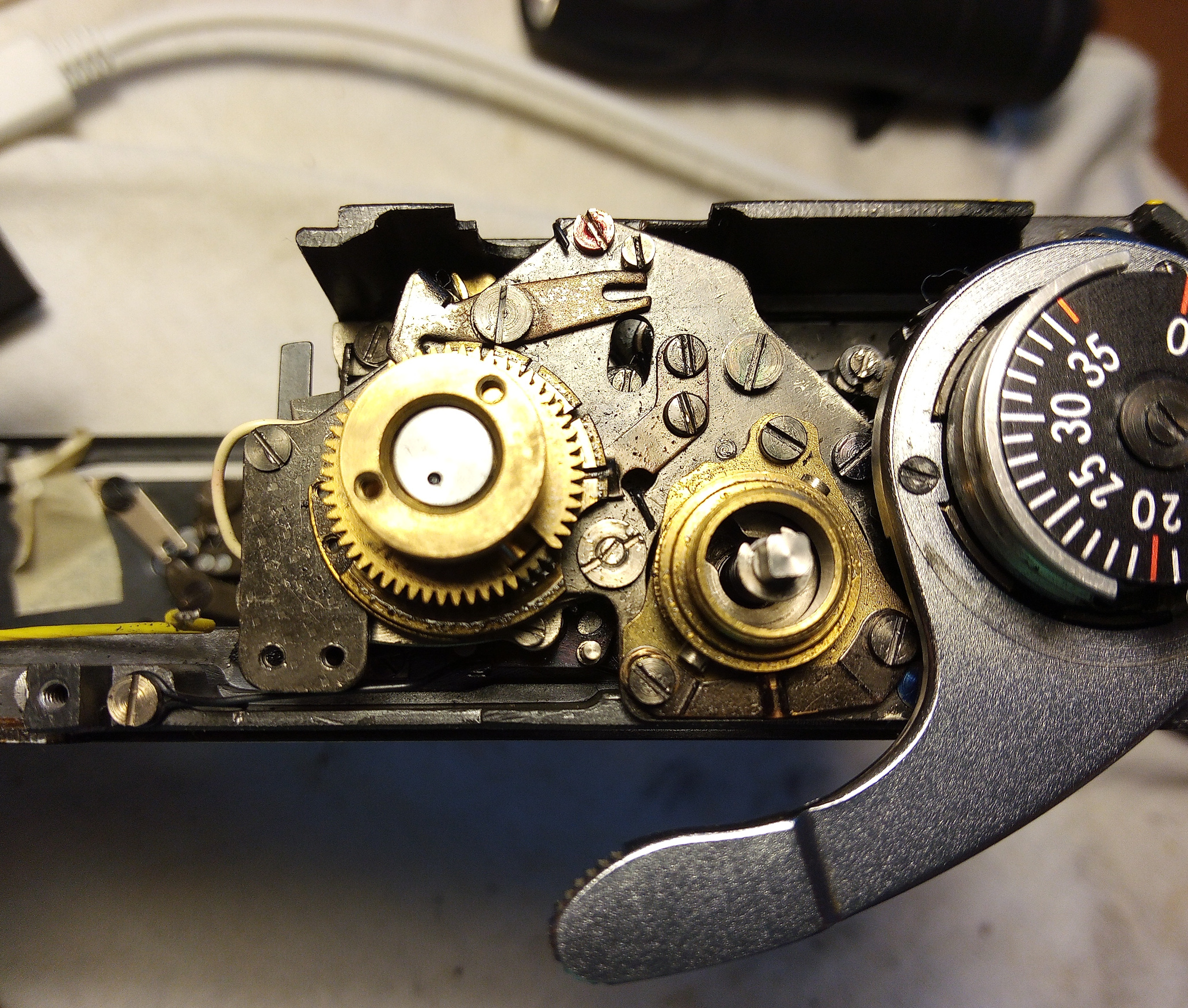

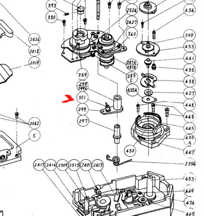

After quite a bit of study and practice on a parts camera I am coming close to the end of a complete disassembly, cleaning, repair, and lubrication on my good Nikon F. The quality of work is every bit what I'd hoped for. I've managed to lick a particularly stubborn problem concerning shutter speed calbration and am very happy with the accuracy of all speeds but one. The 1/4 second is closer to 1/6. The manual states there is a calibration adjustment point for the 1/4 second speed. But I'll be darned if I can find it using the manual. I can't seem to get my bearings on where part 301 is in the actual camera. Can somebody please take the photo of my actual camera and mark it up as to where this adjustment is? Please no comment on 1/6 being only 50% off. Before I started, 1/4 second was accurate, and didn't stop being accurate until I adjusted the 1/500, which in itself made every other speed including 1/1000 practically dead on the money. That is were 1/4 went up to 1/5.9. If I can find where that 1/4 second adjustment is, all I need to do is tweek it half a hair. Thank you.

8x10 Format
