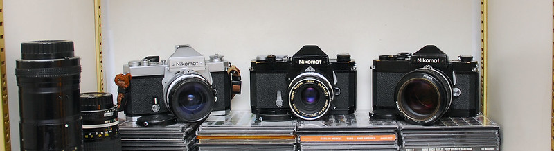

I actually once deleted the hot shoe from an FT2 to turn it into an FTn that accepted newer batteries.
Here's how it looked:
All three had the FTn style nameplate. The chrome one was a stock FT2. The modified FT2 in the middle, and the FTn was stock, except for the advance lever and self-timer lever, which came from the modified FT2 body. Other than the different shutter release collar, the black lens release button, later shutter speed ring, black topped depth-of-field preview button, threaded PC socket, and the trim ring below the rewind crank, it looked almost exactly like an FTn. Only other difference was the slightly chunkier prism housing on the top cover.
