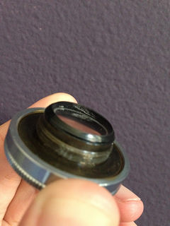

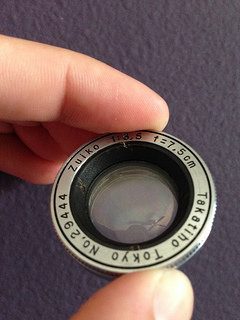

Hi Everyone,
I just joined this group after finding a Mamiya Six IV at a thrift store recently. I'd been looking for a reasonably priced MF rangefinder for a few years now and was thrilled to stumble across a pretty pristine Mamiya Six. The only red flag I've had with the camera is that the lens seemed a little hazy so I went ahead, shot a test roll and sure enough got back some hazy images. Upon inspecting the lens it seems like it does have some fungus and may not be salvageable through cleaning.
I'm hoping someone here can confirm my suspicions and dispense some advice. Since the lens is threaded and not built in, I'm also hoping someone might recommend a compatible lens to replace it or offer up a Mamiya Six lens from a parts camera that is in good condition.
Thanks in advance for any help,
Corey

Your pictures are so small I cannot tell much about the lens other than #3 looks like haze from oxidized materials found in the lens and barrel. If it is a single piece of glass the haze should wipe off with standard lens cleaning techniques.
If it is an air spaced two or three element cell then you will have to separate the elements, clean each one, and reassemble making sure to maintain the original spacing.
Lens barrels are made of soft metals and putting uneven pressure on them makes unscrewing retaining rings difficult.
Zooming my browser up to 200% and looking at your picture #2 the rear element should unscrew from the main barrel allowing you to access the inner surfaces without altering their original spacing.

As another poster mentioned, it's hard to tell what's going on from those tiny photos. If it's haze from off-gassing lubricants, you should be able to make some progress with basic lens cleaning techniques. Sometimes the haze will be quite persistent, in which case I've had some success with very mild abrasive cleaners like silver polish (I've used Flitz - be gentle!). If on the other hand it's actually fungus, hands-down the best thing I've used is moisturizing hand cream. I know it sounds crazy, but it works - apply generously, wait five or ten minutes, remove and clean as normal.
In either case, if the glass has been etched you're out of luck. But there's a reasonable chance that you may be able to clean it up using the methods above.
