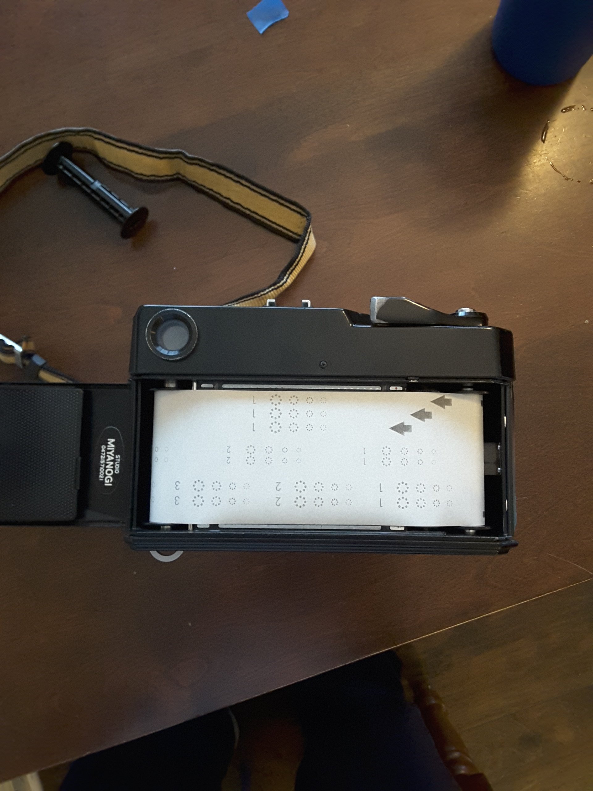

you could load backing paper, and advance until it stops (hopefully at frame 1) then open the back and see which frame number on the backing paper is visible. I think for 6x9 it's the number closer to the unexposed film spool. I think.

It should stop at the 1 and this should put the 6x9 '1' on the backing paper in the correct position (check for film tape on other side of paper, or mark this spot on the back. Frame should be start maybe an inch past this). Now wind paper back, do a frame 1 to frame 2 wind. I seem to remember about 1-1/2 strokes?? Whatever this is, it should be consistent frame to frame, except each frame should take a bit less winding than the previous frame.

I don't know for sure which number is the 6x9 number, or where it should stop.
This is where it stopped. Can you tell me which is the 6x9 number, and where the stopping position should be?

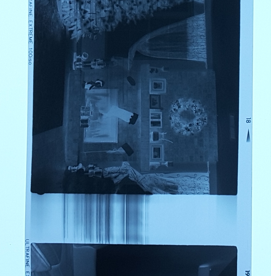

I thought so, too. I just got the film dry, and the last couple of frames have scratches. The rest are perfectly fine. Can this be related?

I'm not sure those are scratches because they're black but I'm also not sure what else to call them. They look almost like light leaks or a partially open shutter during advance?

Ohhhh, I know what it is. I used the B setting, and the advance lever closes the shutter. I need to cover the lens or change the shutter speed to close it, instead. You have a good eye!
Well, I don't know if the wind-on mishap is enough to worry about. If there are broken teeth in a cog somewhere, it seems like I might have issues. I'll try my test roll a few more times and see what happens.
