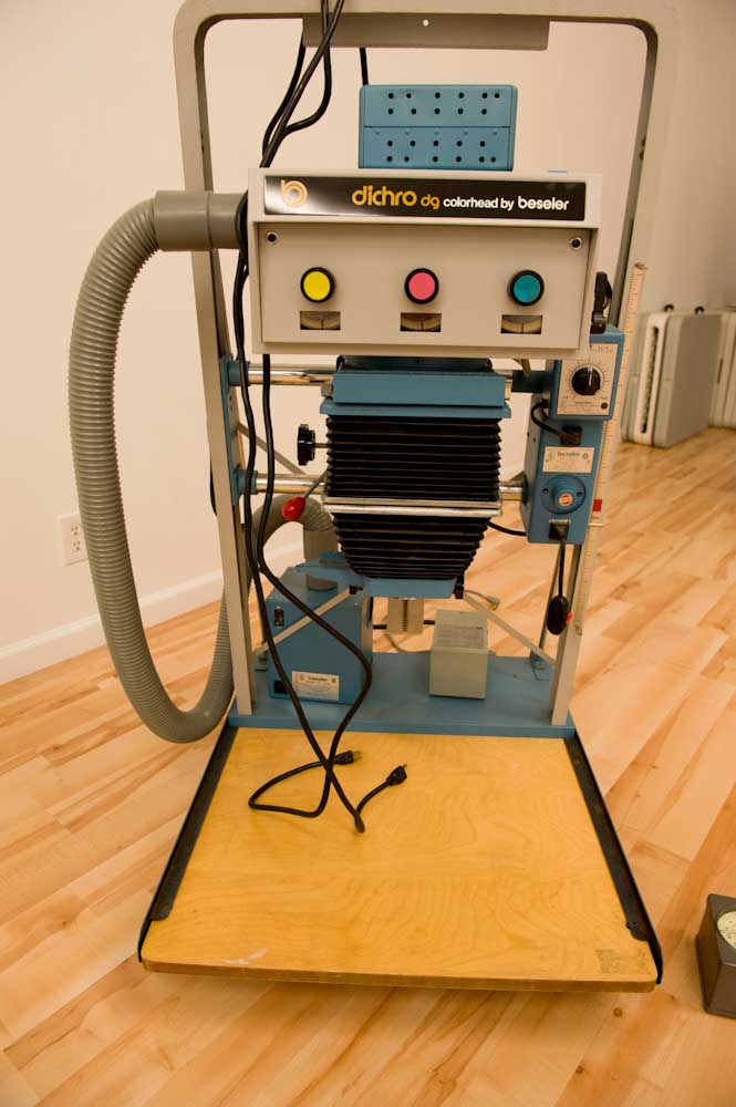

Ok Newbie here. Be easy on me.
Bought this and have questions.

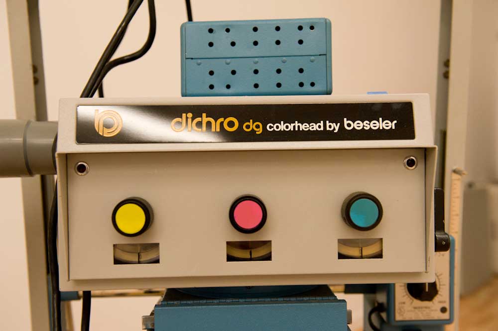

It looks like this is a newer head on an older enlarger.

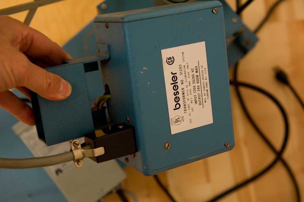

The box between the transformer for the cold light head looks like it is designed to mount on some other type of unit. Do I need to rig it up for this one?

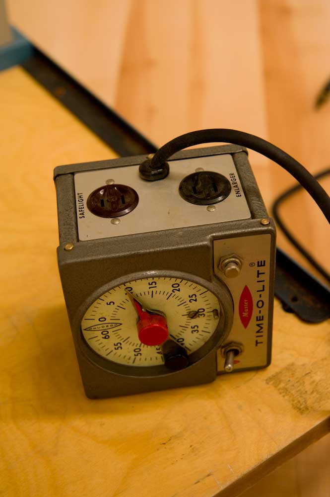

The timer unit has 2-prong outlets and the head has 3-prong plug. OK to use with adapter w/o ground? Does the timer usually need to be used with safelight to shut it off while exposing?

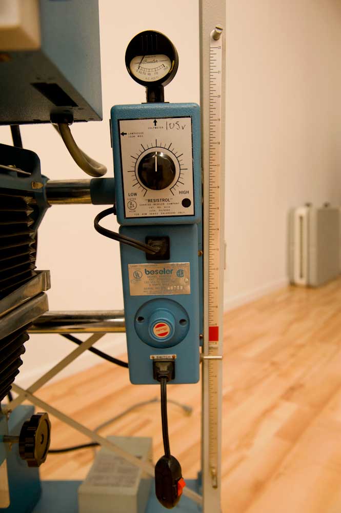

Controls at side of enlarger look like they only work with old style head. Only thing still useful is the control for raise/lower?

You have a diffusion head with color dichroic filters. The bulb runs off the 24V power supply. The variable "resistrol" is for a different head.
If you plan on multigrade printing you can use the built-in filters.
You need a lens (same focal length as the "normal" for whatever format you are using) and a negative carrier.
If the enlarger was intended to be grounded, I'd use a different timer (assuming you house is wired correctly). If you don't have grounded outlets in your house it may not matter.
The 'safelight off' function of the timer is a convenience thing.

Adapting the plugs to the timer is no problem. If you want, you can ground the adapter to the case. That's what the wire's for
The controls at the side of the unit are for a condensor head. At the top is a voltmeter, beneath it is a resistrol which allows controlling the brightness of the bulb.

New question regarding head distance to film
This enlarger is missing the scale on the side of the enlarger for the distance between head and film for various film sizes.
I was getting no light at the corners of prints and figured out that the distance needed to be adjusted. Does anyone know what the approximate distances should be for 35mm, 120 and 4 x 5 film? I am hoping someone has this combination and can give me something to start with.
I am guessing that the original head scale might not be as accurate with the color head, or they just lost the scale strip.

With the color head - a diffuser head, crank it all the way down. The top bellows should be fully compressed with the bottom of the head ending up just above the negative carrier. Only the condenser head requires various adjustments and the scale...
