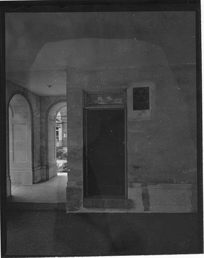

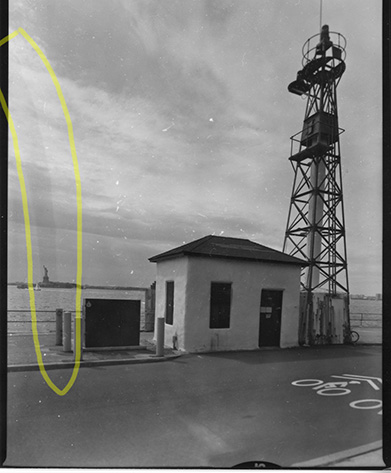

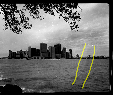

I'm getting what looks to me like uneven development on my 4x5 negatives. In case it wasn't visible in the scans, I drew roughly parallel lines on some of them. These are scanned contact prints. The other two looked okay. I use HP5 in HC-110B for 5 minutes. Am I agitating too much? not enough? Are the sheets hitting each other? Agitation was +/- 90 degrees from vertical, with rotation in the film plane, followed by tapping a tank corner on the counter. I was doing other things but roughly agitation every thirty seconds with fifteen continuous seconds at the end.

Those tanks (and the Yankee) can be harder to get even agitation with and you are more likely to get issues with such a short development time. Some people process without the lid on using them like a mini deep tank lifting the neg holder for agitation.
The trick is gentle but effective agitation, too much and you get surge marks, but a higher dilution would help enormously.

Are those surge marks? Would loading fewer than 6 sheets help?

It's difficult to tell what caused the unevenness but it's probably happening at the filling and initial agitation stage. Because the time is short the development starts very quickly.
Some people fill the tank with dev then add the loaded film holder agitate then put the lid on & work in the light. I use a Yankee for some films and the lids don't seal so agitation is even harder.

If you insist on using a Combiplan, or any other tank of its kind, a good 5 minute pre-soak will help eliminate these streaks from the chemistry flow. Filling the tank and then putting the carrier in the developer in the dark is a solution many have found helpful. Frankly, I hate the things.

Those marks look like the classic problem of not agitating properly enough in the first 15-20 seconds of development.
