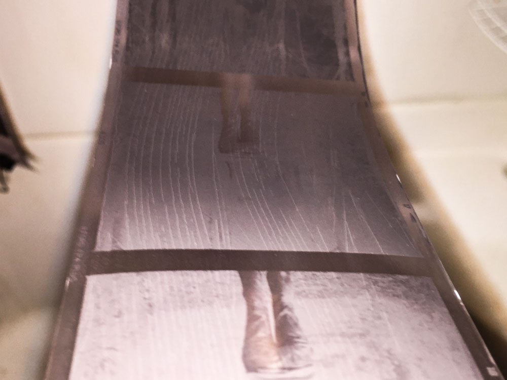

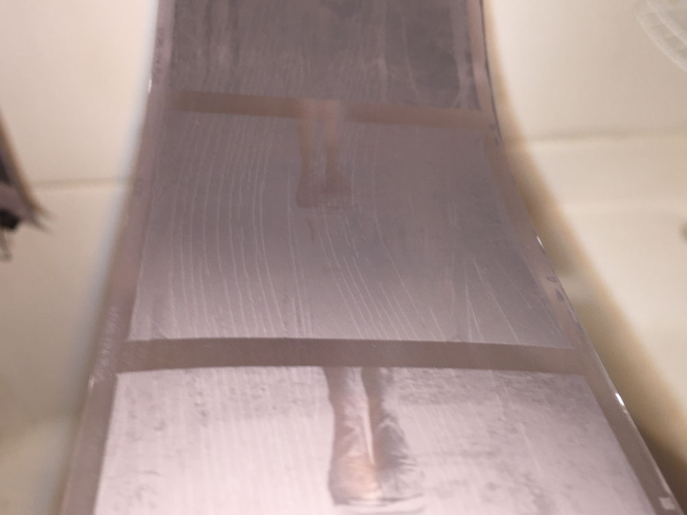

So I developed 3 rolls of 120 FP4+ today in Ilfosol 3. The first roll I developed I had loaded 2 weeks ago into a Paterson tank, but company arrived early so I never got to run it that day. It sat out at room temp until this afternoon. That roll came out fine today. A couple days after that roll was loaded I got in a Nikor stainless tank and a handful of Nikor stainless reels. Both of the rolls I ran through the Nikor tank wound up with these undulating scratches down the length of the roll. They are in a wave pattern so I don't see how they could have come from the camera. They were developed with the same chemicals, dilutions, temps, agitation, etc as the roll in the Paterson tank today. The only difference was these two rolls were pulled directly from the fridge, loaded onto the stainless reels, and developed right away. The two "Nikor rolls" were run separately as well, so whatever happened popped up twice. Has anyone seen anything like this or have ideas what it could be?
For reference I used to use steel rolls in the past (Hewes), but during a move I had to sell the darkroom I had at the time. The purchaser wanted my steel reels too and as I was shooting only 35mm at the time, I let them go. Prior to loading today's reels I did one test load with an old junk roll and it was like riding a bike. I had no issues at all loading the 2 scratched reels, so don't see how loading could have caused the scratches.
The first pic is a straight photo and the second is contrast enhanced to better show the scratches.

Someone more knowledgeable than I will chime in shortly, but I suspect you loaded the film too soon after pulling from the fridge. Either stress to the cold emulsion when loading, or problems with the differences in temperature between the film and developer. It may even be something else related to loading the reels - did you use any sort of guide/device when you loaded the reels?
Are these lines, or actual disturbances to the emulsion?

Thanks for chiming in. I used no guide and had no problems seating the ends into the spring or winding the film onto the roll. The temp issue was one thought I had as well, but wasn't sure as I have loaded straight from the fridge before with FP4+ onto plastic reels without issue. When I was using steel reels years ago, I did the same process with Plus-X without issue.

When you load a plastic wheel, the film pretty much gets pushed straight in with little to no bending. To load steel reels you have to slightly bend or curve the film longitudinally. It probably depends on how cold the film was.

We keep our fridge on the colder side. If the temp was causing an emulsion cracking, would that have resulted in the wave scratch pattern though? Perhaps the wave is the result of my method of separating a section from the backing and then spooling?

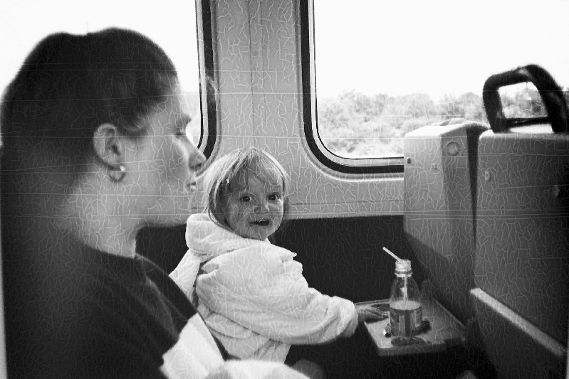

Here is a photograph from a 35m roll I took in 1995 I accidentally introduced very cold water after the 20c developing stage and I remember swearing out loud when I realized what I had just done......Thermal shock the entire roll and amongst it all I can see similar wavy lines to yours.:smile:

My negs have the line scratches, but are no crazing. I stuck a thermometer in my film drawer overnight and it's 37F. It was only about 10 minutes between removing from the fridge, loading on the reel, and then starting developing. My prewash and developer were 68F, while the stop bath and fixer were about 60F (they're kept in the basement). Again, I've had no issues doing this in the past with plastic reels. I have only ever had it happen on these 2 steel reels.

Perhaps static electricity caused the lines? Cold objects can be a problem with friction, the combination causes static charge to be generated. The metal reels conduct electricity plastic reels don't. Remedy? - allow the film to stabilize at room temperature before opening.

I had considered that too as a possibility. However, I would think static would produce exposure issues on the film like a light leak, but these are actual scratches. The film should be ready for scanning this evening and will see if that reveals anything.

If they are physical scratches I misunderstood. Then perhaps the cause is the metal reels, are there some sharp edges?

Why do you store film in the fridge before loading it onto reels? I'm going to guess that curling the cold film lengthwise to load it onto the reels caused stress that then became reticulation cracking when you poured the 68 degree chemicals in the tank. It's best that the film be as close to the temp of your chemicals as possible to start with.
When loading onto plastic reels you don't have to curl the film lengthwise like you did here.

The only problem with the stress theory is that the marks would would be dark on the negatives and not lighter. Stress on the film would cause fogging at the stress points.

Static discharge on a film causes very distinctive star like patterns which the samples do not show.

The scratches/cracks/whatever are on the back side of the film only, not the emulsion side. I did recall that I misspoke early on. The 2 rolls on the steel reels were pulled at the same time. The one that was immediately loaded and developed did exhibit more of the issue than the second roll that was out for a half hour longer before being processed. To me, this helps to add credibility to the temp stress causing cracking of the film.
