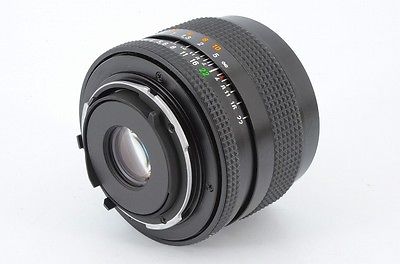

Fellows -- it seems to me you're discussing two different lens mounts. OP says his CZ Distagon 35mm should is in the Contax/Yashica SLR bayonet mount, hence his trying to mount it on a Yashica. Responding poster offers to try the lens on a 1930s or 1950s Contax rangefinder camera. If OP's lens looks like the attached image, it is a Contax/Yashica mount SLR lens, and will not fit on a 1950's Contax rangefinder. It may fit the C/Y adapter if that is an adapter for Contax/Yashica SLR lenses.

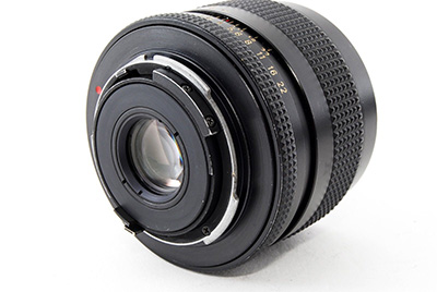

Hi Trask, you are correct - my lens is the Contax Zeiss Distagon T* 35mm F2.8 AEJ and the mount looks like this:
it is not 100% like yours but it should fit the Yashica FX-3 line. Your is probably the MMJ. I'm not sure about how it would fit on older Yashicas or if they can mount with an adapter but I'm willing to try. I'm not familiar with the Contax line of cameras and lens mounts, I'm open to find out more. Thank you
