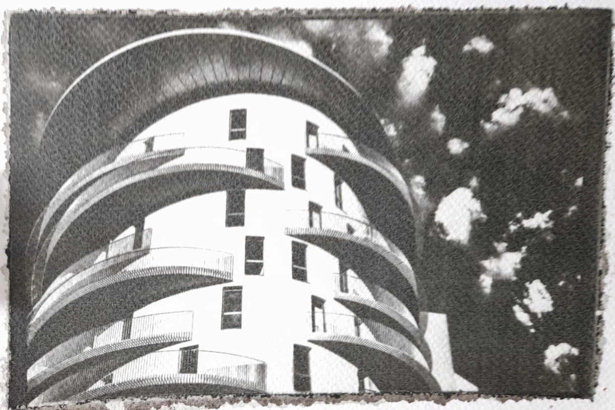

Dear All,
I've just started with Gum Bichromate printing and this is also my first foray in darkroom printing. I seem to be getting decent details in highlights but the mid and dark times are usually muddy and I need to subject the prints to water trickles to bring out some details at the cost of loss of contrast in general. With my UV bank of BL tubes, the exposure of 4 minutes for the first coat brings out 60-70% details and i go up to 4 coats with successive reduction in exposure times. Attached is an image with 2 coats -- lime yellow first coat followed by ivory black second coat. Can you please suggest how to improve upon the limitations am experiencing? Thanks in advance and best regards, Debanjan

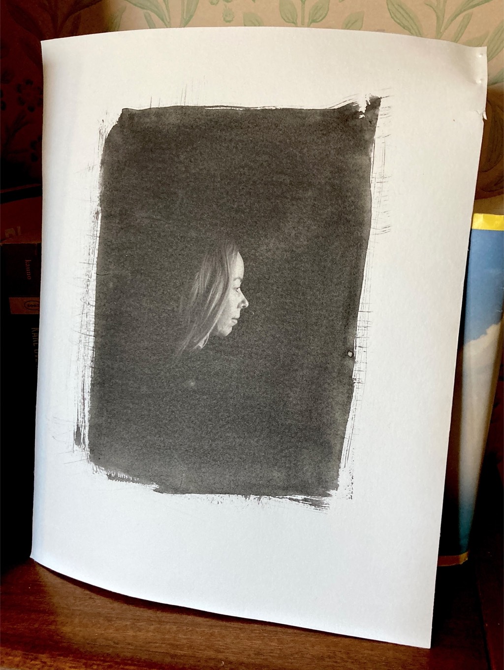

I was on two day course just this weekend on gumprint and noticed the same "issue".
I got one print with a bit more deeper black by making one layer with lamp black with short exposure. I didn't try this but could it increase density of lamp black even more if the mixture would be 1:1 with dicromate + pigment without the one part gum arabic ..

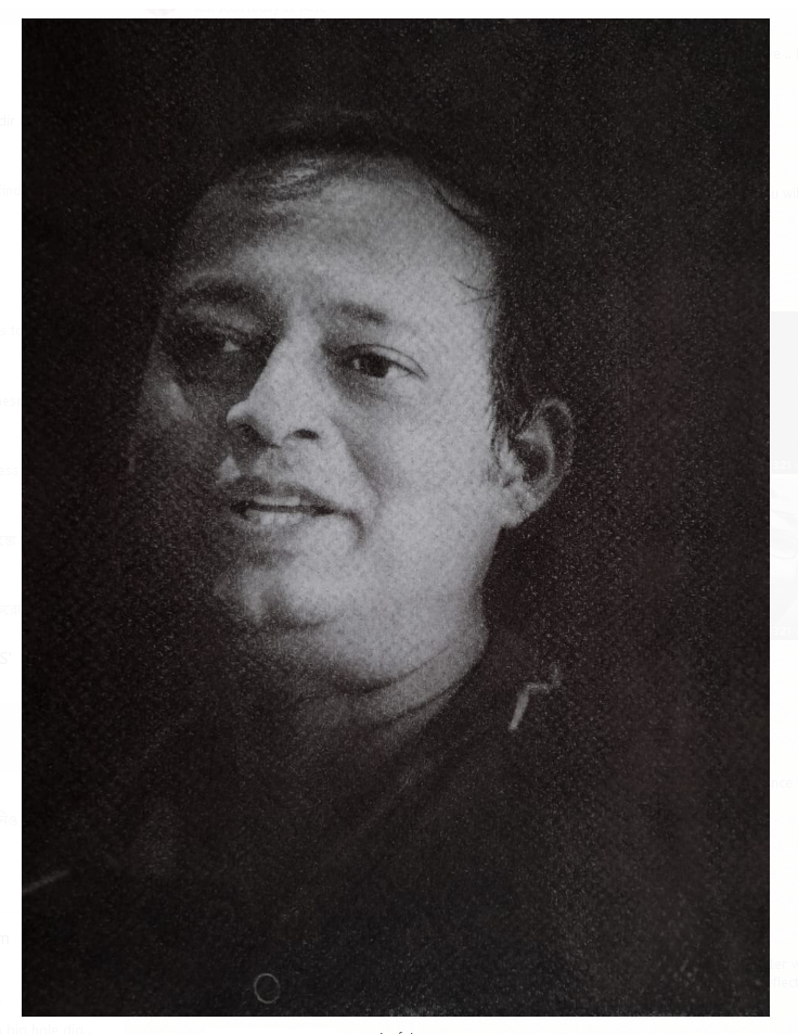

Thank you @koraks and @vedostuu. I did go through the several youtube videos that Bob had shared and they were informative and helpful. I also got the guidance to try out multiple layers with varying pigment / dichromate and exposure mixes to develop the highlights, midtones and shadows. I would say am getting some better results with the said approach. Attaching a sample for your review / comments (straight shot from the mobile - no adjustments). Thanks again.

Yeah, that looks similar to my attempts. I suppose if you build some more layers you'll get more density. And then of course work on the highlight layers as well.
Btw, I remember I ran into trouble with more than 3 layers as additional layers would have poor adhesion. Might have been related to my gum or pigment, I don't know. By that time I decided I didn't want to pursue this process further. Maybe some day.

Here is the print I was talking before. Last layer was lamp black just for the shadows (normal mix, short exposure) - I know my alignment wasn't that succesful :D :
Here is mine single layer with lamp black:

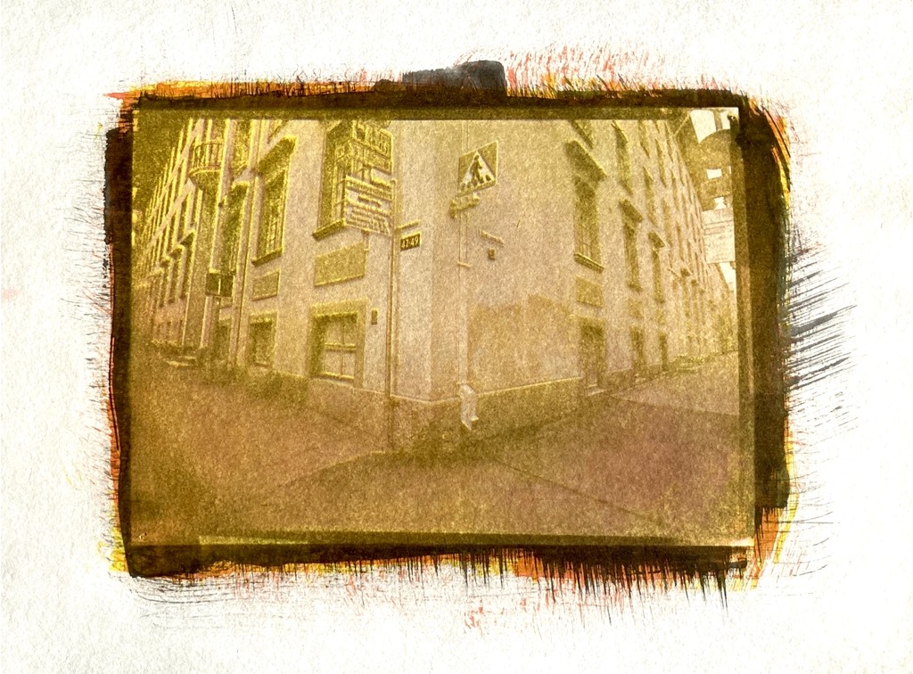

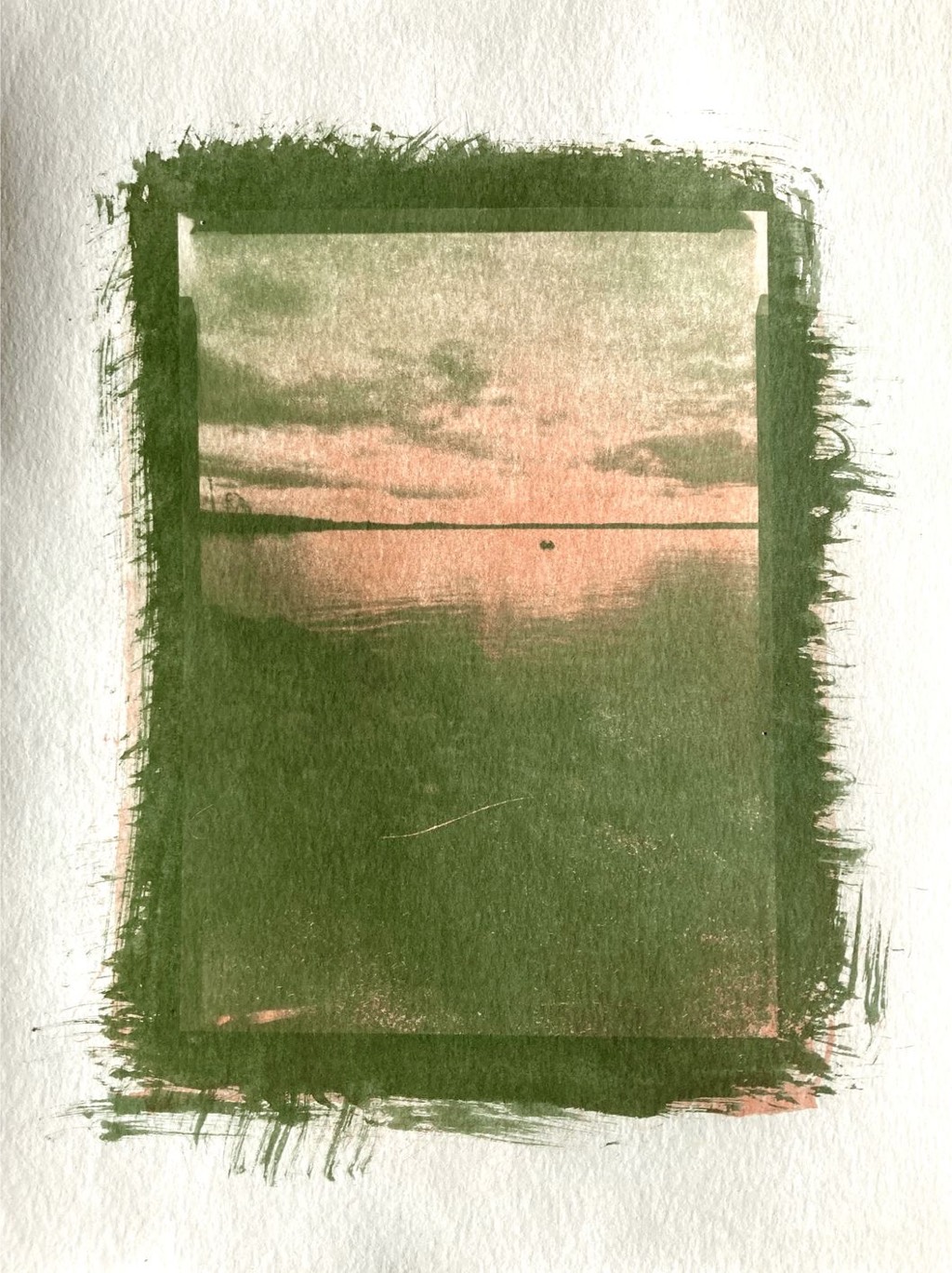

This one is two-layer, the shadows become more darker from applying orange layer for whole print. The orange layer was a really short full (no negative) exposure but still it sticked really hard and I had to spray like maniac to wash it away (only to keep in horizon):
It looks pretty OK'ish on screen but in reality it is way too light to be displayed.

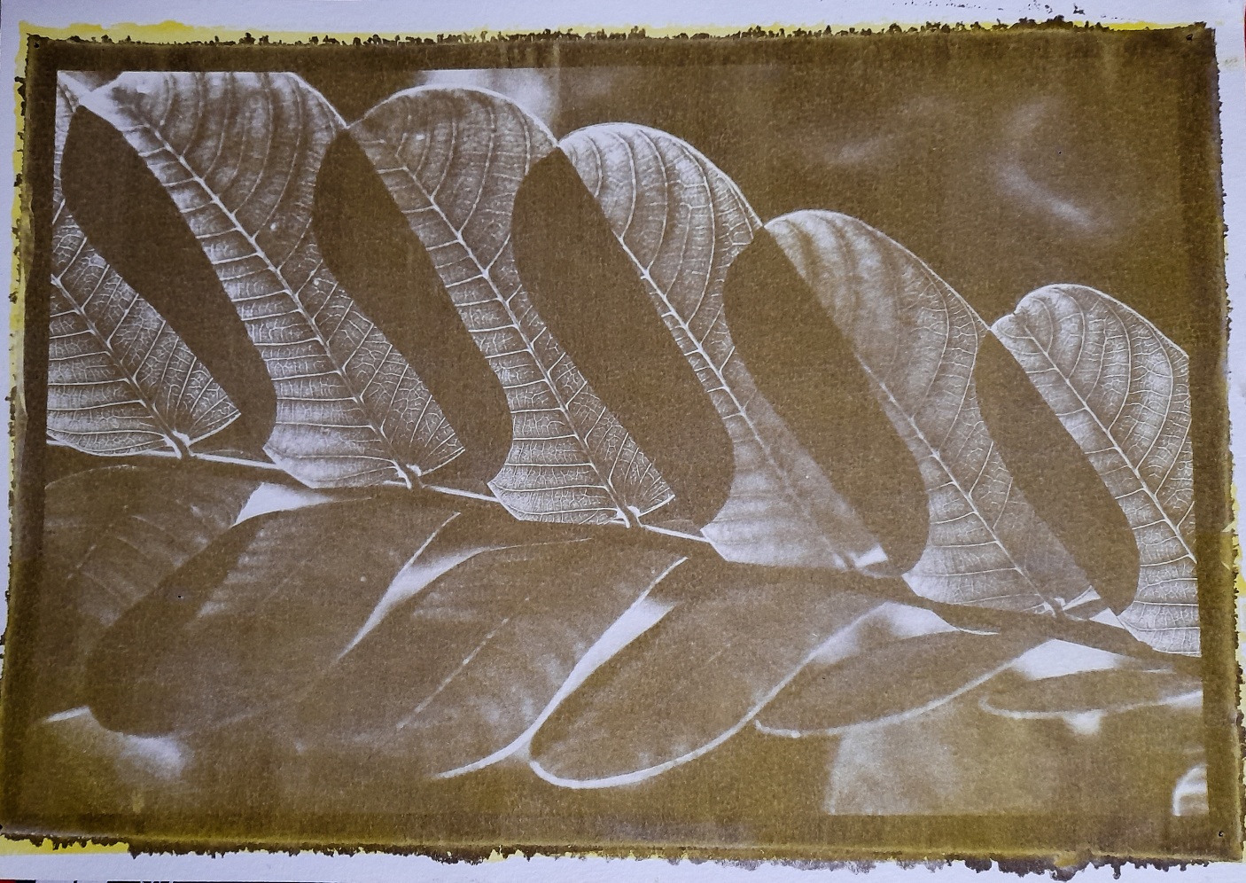

At the moment am using Fabriano Artistico Cold Press (Studio Grade) 300gsm paper .. Hahnemuhle platinum rag is not that easily available but am on the lookout for hot press versions or papers that have a smoother appearance. Here's another example of what I could manage with layering as @koraks suggested
I really like it and thanks for the idea regarding the Orange colour ! Really innovative. Thank you for sharing. Something to try for sure :smile:
Looks like you have nailed it with this one...it's the best I have seen in terms of Dmax and tonal rage. I kind of like the texture - suits well to this process.
