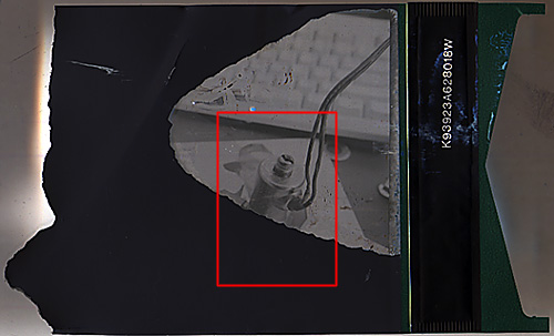

I have a Wing-lynch. It eats solenoids. The solenoids open and close to allow chemistry, water or waste through the system. The solenoids dedicated to the chemistry are of one type ( a type have that I have a small inventory of) the solenoid that allows the water to come through is of another type.
I have recently moved and am now just setting the processor up again. The only chemistry solenoid that has not been replaced has died as well as the water inlet selinoid.
I was wondering if anyone out there knows how to rebuild or recover a solenoid. Pictures can be provided if needed.

Beautiful! I am putting in the drain at the moment so it may be a day or so before I can pull it out and shoot it. I will shoot both types, as I am sure that the chem versions will go eventually and my inventory run dry.
Well, my polaroid 545 took its last breath trying to cough-up the shot of the solenoid (see attached). It is not my week/month/year/life for equipment...
I talked to an engineer friend about rebuilding/repairing these devices. He told me that they are eminently repairable and that where he comes from (eastern europe) it is common practice. Generally it requires re winding the wire. I was rather hoping it was something that could be done simply - say with a small hammer and some gasoline.
FWIW the Solenoids are produced by Norgren Kip Inc. The more common of the two (chem solenoid) is labeled Valve # 2x333, Orifice (love that word) 3/32 x 1/8 and is a 'Standard' 2-way directional valve. The less common (water inlet solenoid) is labeled Valve #2x6 O A, Orifice (ewww!) 1/8x5/64 and is a 'standard' 3-way directional valve. This information is provided should anyone have one of these puppies hanging around the house.

I can not determine from your photograph the physical characteristics of the valve itself ...typically complete solonoid valves are the metal mechanical valve assembly and then a coil assembly that actuates it. What I draw by inference from what you say is that you are dealing only with the coil assembly.
Now solonoid valves are typically purchased off the shelf from a valve manufacturer...it is highly unlikely that Wing Lynch designed and built their own valves.
One of the sources for replacement valves that I would check would be WW Grainger...they will have stores in major cities and also have a online catalog. They may or may not have coils that will mount on your valves. If they don't then I would look to replacing the whole valve assembly. In order to do that you will need to remove the valve completely (not just the coil) and take the valve that you have removed to a wholesaler such as WW Grainger. They will be able to cross reference to a replacement valve.
The characteristics of a valve are these...
Line connnection size...For example this would be 1/8 inch or 1/4 inch Female Pipe Thread...or some larger size.
Valve operating manner...Normally open or normally closed....this is without power being applied to the coil
Coil Voltage...This would typically be 24 volt, 115 volt, or 230 volt AC..it would be possible to have 12 Volt or 24 Volt DC but normally a manufacturer such as Wing Lynch would not have gone to the expense of converting an AC incoming power supply to DC for valve operation.
Valve material...Brass or Stainless Steel. For your applications where photo chemicals are involved opt for stainless steel valve construction.
If you are having frequent coil failures something could be causing this...it is unlikely to have coil failures unless a mechanical factor is influencing these failures. This could be a valve that is sticking in one position, improper voltage being applied to the coil or something of this nature.
If you are unable to locate what you need then there are other solonoid valve manufacturers. Some of these are Asco and Parker Hannefin. A Google search should be able to locate a distributor in your area.
Let me know if I can give you further help. I have worked with this stuff for over 40 years.

I am dealing with the whole piece, coil and valve. My assumption is that the coil is what is going on these things and that the cause is corrosion. The Wing-lynch I own is 20+ years old and the solenoids exhibit corrosion on the exterior when they go and the latest fatality shows corrosion on the interior (valve area) --This was the first one I opened up.
I have yet to replace a solenoid twice in the 2 years I have owned this thing, but the replacement solenoids are also used so I anticipates failure of the replacements.
The devices appeared simple and therefore I thought that there may be a simple way inwhich I could repair them. WL wants 80.00 a piece for the chem solenoids. Which is 80.00 more than I paid for the processor and over twice what similar parts cost off the shelf.
