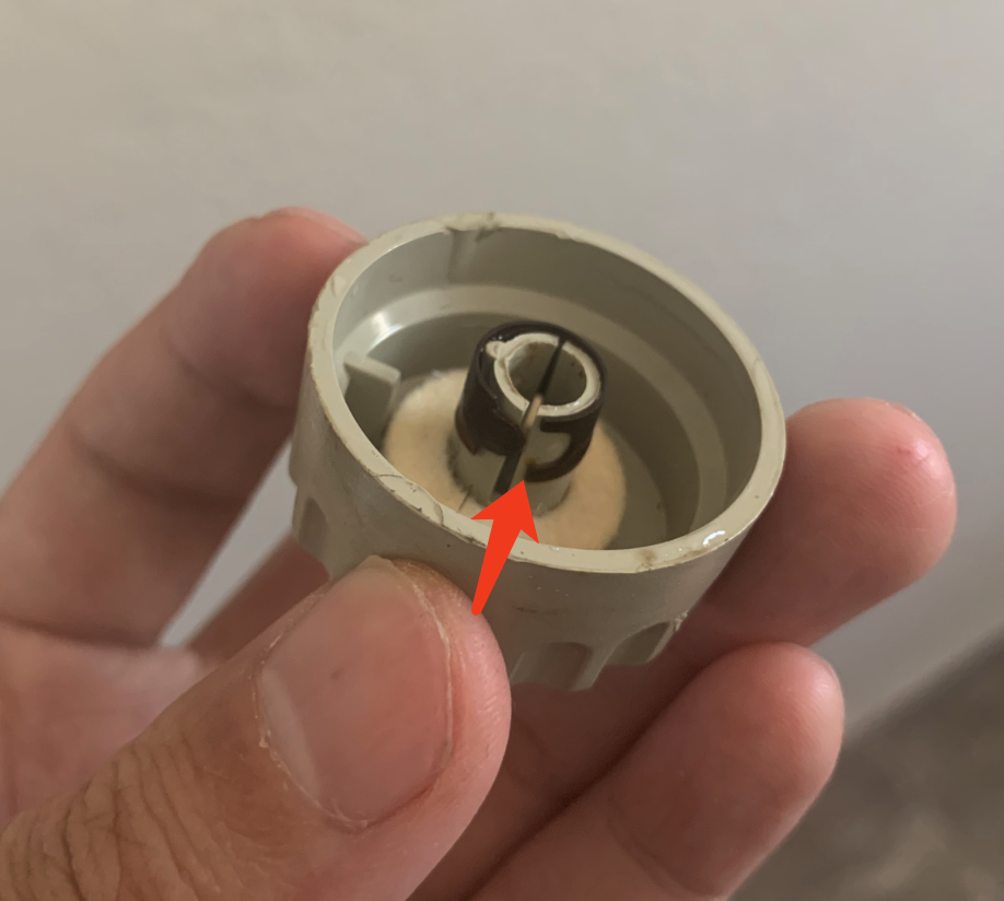

Hi,
I recently bought a CPA2 and encounterred some problems that may need you help.
Problem-1:
The temperature in water bath is not the same as what I set by turning the temperature knob. They have about 3℃ difference. E.g. if I set tempeture knob as 35℃, then the actual water bath tempeature is about 38℃.
Problem-2:
The temperature indicator doesn't light up.
After watching some related CPA2 operation videos on Youtube, I found that it seems my temperature knob was installed incorrectly, then I pulled off the knob and found it has a rusty meta around the core of the knob, then it seems the rust causes the indicator not lighting up correctly. see the photo below.
And my questions are:
1. Is the gap between the head and tail of the metal piece supposed to be there?
2. May I know how to install this knob properly so that I won't have temperature shift?
Thanks!
-) At least in theory the tension within the shaft could be adjusted by changing the angular position of that gap in the clamp. N
Now it is sert at lowest tension.
-) I would not bother with the original knob but substitute with a decent knob with clamping shaft, that can be screwed tight. Just buy such knob designed for that diameter of the potentiometer axle.

If you break that knob, finding a replacement will be very difficult. I'd put it back.

You mentioned "by changing the angular position of that gap in the clamp", does this mean I can increase the tension by reduce the gap between the head and the tail of the metail piece?
No, the gap within that clamp will remain the same, but by twisting the clamp by 90° you might heighten the tension inside the shaft.
But mounting instead a knob as I described is the better solutuion as you not only can tighten it stronger, but also mount and demount it without any axial force on the potentiometer and thus on the circuit board.

Hi,
Thanks!
The temperature control is not a precise measure, merely a guide. There are so many variables such as the surfaces outside the water bath which allow the water to cool relatively quickly. The actual ambient temperature of the room where the processor is will to a great extent affect this one way or another. I worked this out a long time ago and I have calibrated the setting over several hours by setting the dial at just below the working temp and increasing or decreasing it by small increments until I can get a stable 40C. I say 40C although the working temp of the chemicals is usually 38C, this allows for fluctuation during the process when the chemical containers are poured in and then emptied. Because it is not a precise instrument, the best results come from experience, certainly not blind following of the settings. I have been using one since 1991 and have found this to be the most consistent.
The rust around the inside of the knob and mounting post will not affect the operation of the thermostat nor the light. Because the equipment may have had an uncertain history the rust is almost certainly caused by splashes of water or condensation remaining after use. You have to expect this. I think you are worrying over what is a minor problem when you expect it to work perfectly the same as when it was manufactured.
The image of the underside of the knob showing the spring clip with the groove, this is perfectly normal. The spring allows for expansion of the knob mounting post and also to remain secure. If it were a solid ring the expansion could not occur and the knob may become loose or it could not be easily removed for cleaning. (Which it does not seem to have been done.
Tip Clean it and before replacing, smear the metal clip with something like Vaseline and the rust will not re-form. Don't try to remove the clip you will risk breaking the mounting post.
If the light does not illuminate then that is probably a device fail either due to a broken wire or a bulb fail. It can be repaired by removing the cover and replacing the light with a LED cutting the wire to the bulb and soldering on the led. It is no a difficult job

The shaft of the temperature control potentiometer has a flat side, the knob is moulded to fit and the metal spring keeps the tension on the shaft.
Don't try twisting the knob while fitted to the shaft, otherwise you'll break the knob attachment, regardless of the spring.
Try and align the shaft flat and knob before pressing it down gently. Once it's on, you should be able to raise or lower the temp of the water in the bath.
The indicator light should come on when the temp request is higher than the actual water temp. The indicator is a simple neon lamp, so if it's not coming on, then the heating element may have an open circuit.
