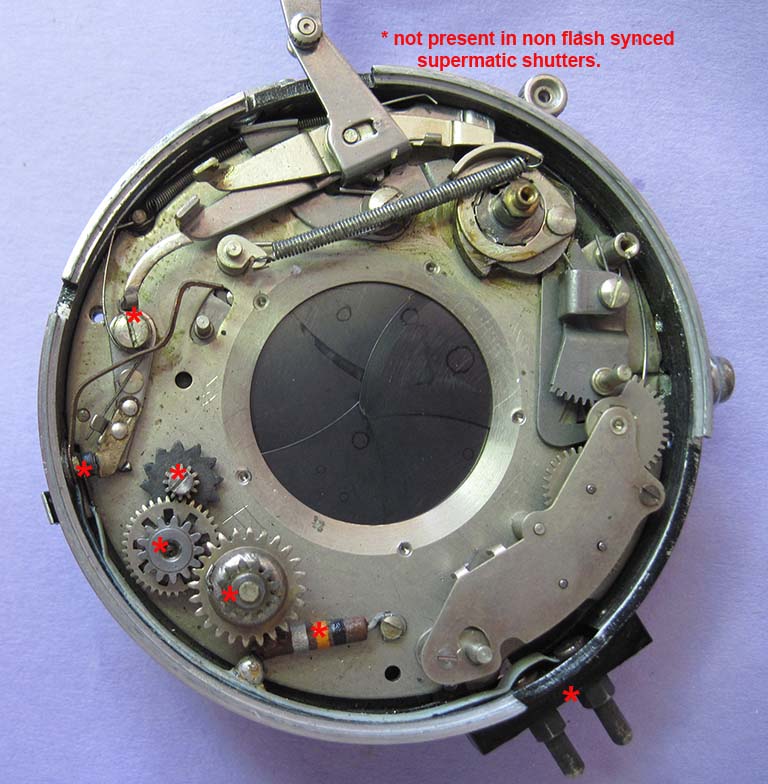

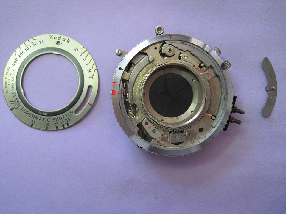

ensure arrow items are NOT under the speed ring

1. Adjust the retard sector travel by loosening the retard gear plate screw(s) so that the retard sector will pass freely under the gear and mesh so that the sector stud is approximately 1/8 inch from the shutter case. Manual says outer edge of the sector but I have found this results in insufficient sector travel. I do not know if this is due to a misprint or not. The sector stud is opposite the press to focus button. Secure retard gear plate and verify retard sector travels smoothly by setting and tripping the shutter, the B&T levers will have to be operated manually to close the shutter.
2. Remove material from the speed ring where the retard sector stud contacts it.
3. Remove material from the speed ring where the pallet stud contacts it.
4. Clean delay gear train.
5. Reduce tension on the main drive spring.
(2-5 is the order listed in the manual)
.001 difference on the speed ring makes a big difference in speeds. Adjusting the 1 to 1/10 speeds may put the 1/25 to 1/100 speed off. Remove material from the speed ring as a last resort. The main cocking spring attach point by the B lever can be rotated on its post. The sector stud can be moved .001 to .002 either side of perpendicular if the sector travel is correct.
On the last few of these I serviced its been a tradeoff to get the speeds 1/100 and slower to be acceptable.

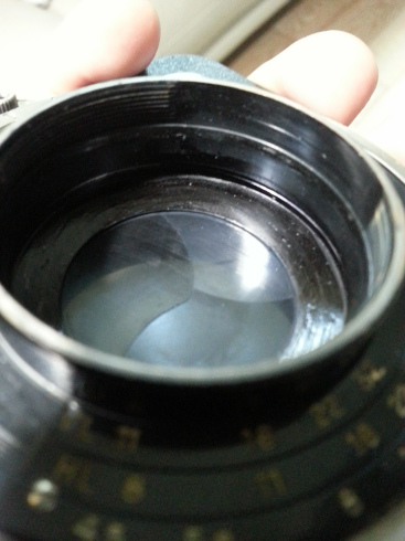

Now I have another problem: My Hugo Meyer Plasmat convertible lens 320mm/220mm together 153mm. Its shutter is jamed. The B is OK, but other speeds exclude 1/200 jamed. The shutter blade open a little (about 3mm) and can not release. I tried to open it as normal compur shutter, but the ring which is attached to the front and adapt to the lens element can not be removed. So the front cover of the shutter can not be removed to open the shutter for maintenance.
Does anyone knows how to remove the adapt ring or other mathord to open the shutter for repair? Thank you very much!

Supermatic: moving retard sector stud toward case increases (slows) speed; moving retard sector toward shutter center decreases (shortens) speeds. Delay pallet stud toward case slows speeds, toward shutter center shortens shutter speeds. Delay pallet stud should be at its travel limit toward the shutter center for the 200 and 400 speeds.

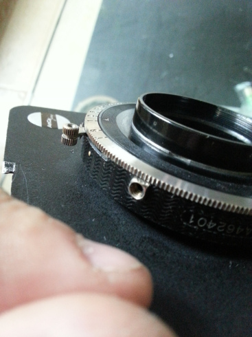

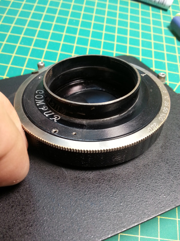

Thank you. I see the standard process to open the compur shutter. But on the Hugo mayer lens shutter, it attached a adapt ring for quick release the lens elements( about 90 degree to change). The adapt ring attached to the front of the shutter so firmly that I can not remove it. The ring block the three tabs to remove from the slots after I turned the front panel. I can not maintain the shutter without the front panel removed. Any suggestion to me?

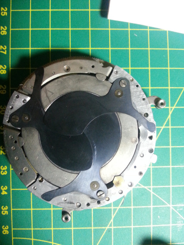

I just tried to open the shutter from the backside. But when I did that to remove the blade shutter, I have no way to continue. The pic is as attached. the first three is the front adapt ring, which cause I have no idea to open it from the front. The last is where I can not continue. I have removed the 3 pieces of shutter blade. But I can not continue. Please advise.

That appears to be the lens barrel or a spacer barrel. It should be screwed into the shutter. They can become stuck or corroded in place.
1. Grip the barrel with a strap wrench and try to loosen it. Be careful not to bend or deform the barrel. You may need to remove the shutter from the lens board and grip it with a second strap wrench.
2. Heat your oven to its lowest setting usually 150°F/65°C for gas or 175°F/79°C for electric. When the oven reaches temperature turn it off and place the shutter in the center of the oven on a rack and let it sit there for 15 to 20 minutes. Remove the shutter from the oven and try to unscrew the barrel from the shutter. Should be standard threads.
3. Seal the shutter in a plastic bag and freeze it. Once frozen thaw and try to unscrew the barrel.
4. Last resort apply penetrating oil around the outside of the barrel at the shutter and allow to soak in for 12 to 24 hours.
