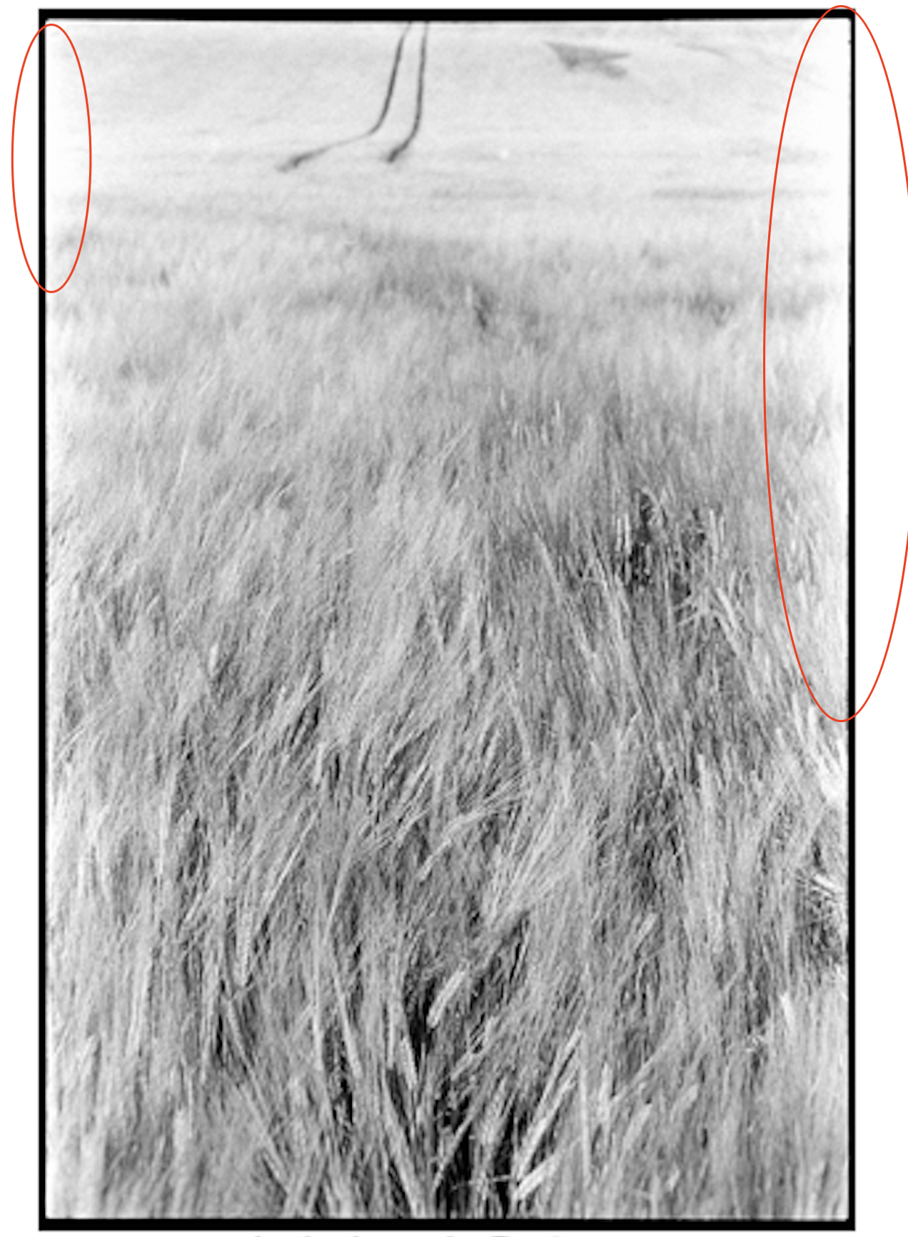

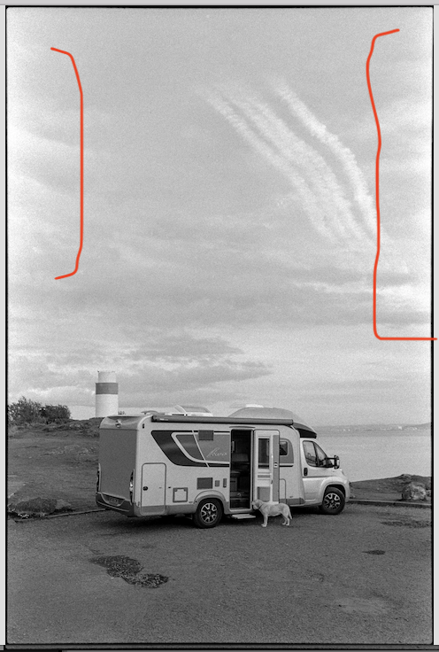

Hi all,
Have been having a real hard time developing my negatives recently. It seems that no matter what I do, all of my negatives come out with 'burned' areas where there is no detail. It happens only in black areas on the negative (bright areas) and often around the edges of the frame, but it can occur in the centre of the frame too.
I shoot exclusively Ilford HP5+. I have a tendency to shoot at 320-250 ISO for increased shadow detail, and have done so for a long time with no issues. But now, it seems that every bright area is burned resulting in a lot of unusable negatives. I initially thought that perhaps I was overexposing too far for the negative to handle, but on the other hand I know HP5 can withstand more than a few stops of overexposure without anything like this happening. The issue has also been occurring on negatives that I know I purposefully underexposed. So I concluded it must have been due to development.
I am using D76 1+1 at 20C, tap water as stop bath, and Ilford Rapid Fixer. I develop for the standard 12 minutes.
Yesterday, I decided to develop a roll and purposefully agitated very little. Once again, the negatives are extremely burned, more-so than I have ever seen.
I'm starting to lose the plot a bit to be honest. Can anyone offer some insight here into what might be going wrong here? I have attached a couple of photos to show what I am referring to (II have purposefully edited them to make the burn more apparent).
Any help would be greatly appreciated.
Cheers,
Adam

Is this 35mm film or 120 and can you show us the negatives? Is it all frames or only some and if only some where are these negatives in relation to the frame sequence i.e. beginning, middle or end?

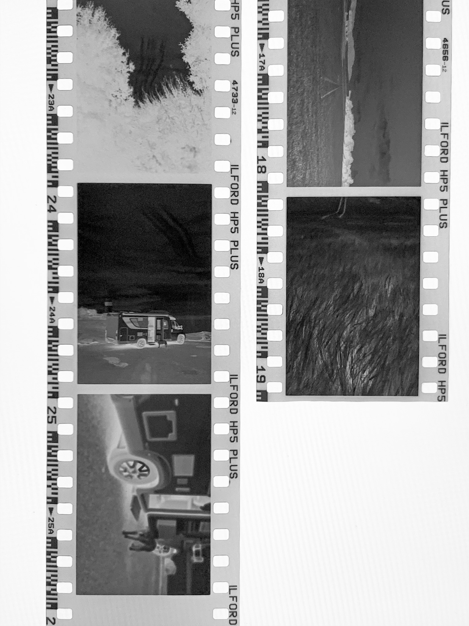

Is this what you were after? I just used my phone.
The negatives are pretty dense but there is not bleeding over the rebates or between frames.

Thanks for posting the negatives.
When I enlarge them on my screen, I see no signs of the problem - there is no apparent increase of density near the edge.
I think your problem is related to scanning.
Based on where this is happening, I'm going to suggest you're getting flare due to scattering inside the camera. That is, the bright part of a sky, for instance, is scattering from an insufficiently black surface near the frame gate and adding density at the edges of the frame where the scene is bright. Clearly you don't have any kind of light leak affecting the rebates or interframe spaces, which rules out darkroom or developing tank leaks. Chemical fogging during development would affect the rebates as well; yours look very clean indeed.

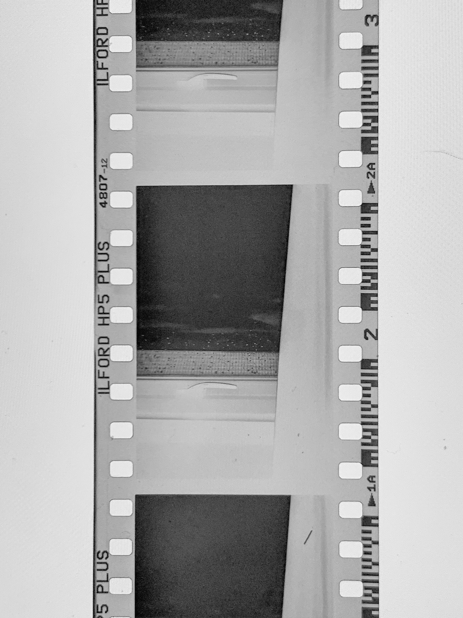

Here is a negative in which the effect is much more apparent. The density follows the shape of the window, to the edge of the frame on the left but in the middle of the frame on the right.
This was shot at 400 ISO and agitated very minimally during development.

I think I should also mention that I have had colour rolls developed by a lab during the time in which this issue has been going on, and they came back clean. That eliminates any issues with my SLR.
That looks like the result of inadequate or insufficiently randomnized agitation.

Take one of the problem negatives, rotate it 180 degrees without turning it over, and re-scan it.
Do the problem areas look the same as before, or do they move.
If the latter, the problem is with scanning.
