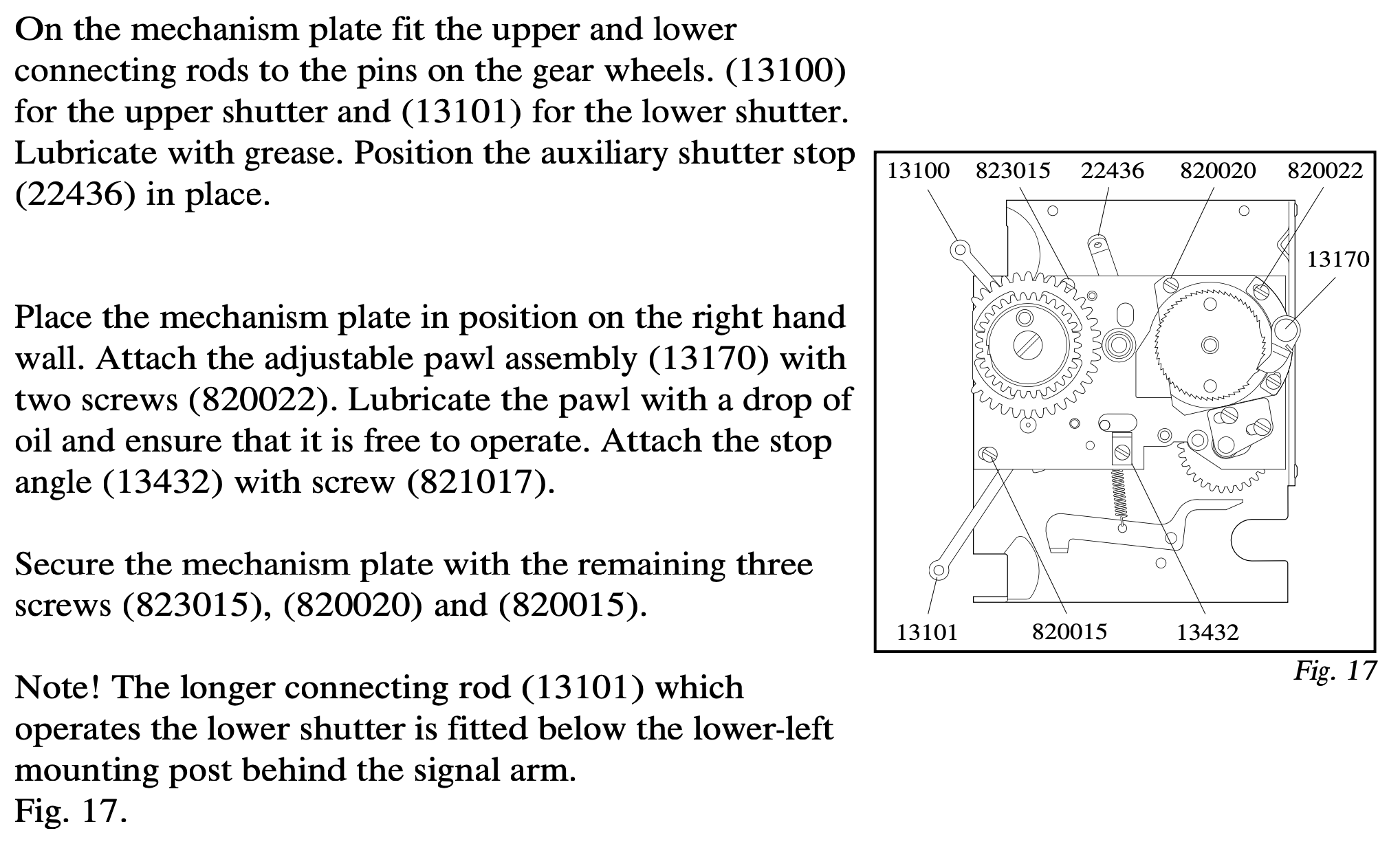

My camera exhibited exactly the same symptoms and the culprit was the disconnected shutter rod. The auxiliary shutter is operated by 3 rods: upper, lower and stopping, and one of them broke loose and wasn't connected to the shutter flap anymore. I would NOT recommend DIY repair unless you know what you're doing.
Here's the relevant diagram from the service manual:
