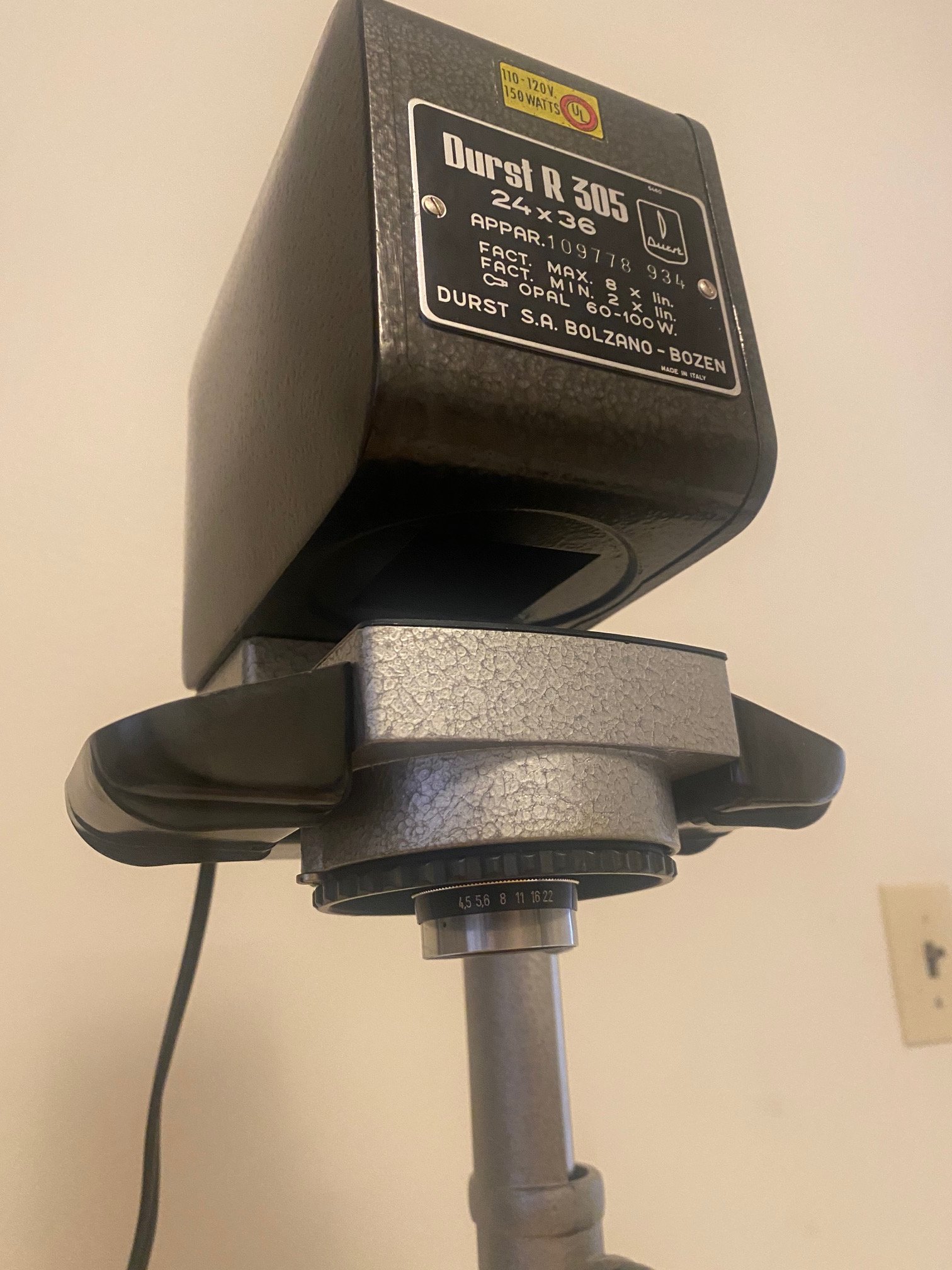

Hello,
I'm pretty much at a loss here. I recently picked up this enlarger and hope it works, with a new bulb. But I cannot figure out how to switch one out! I unscrewed everything that could possibly make sense, yet I still do not know what Im doing wrong. I know this is a rare one, hope someone here has the answer for me!! Thanks in advance

I read that as requiring "an ordinary 60 - 75 watt opal bulb"
That says to me that it is what was then an ordinary household screw in tungsten bulb.

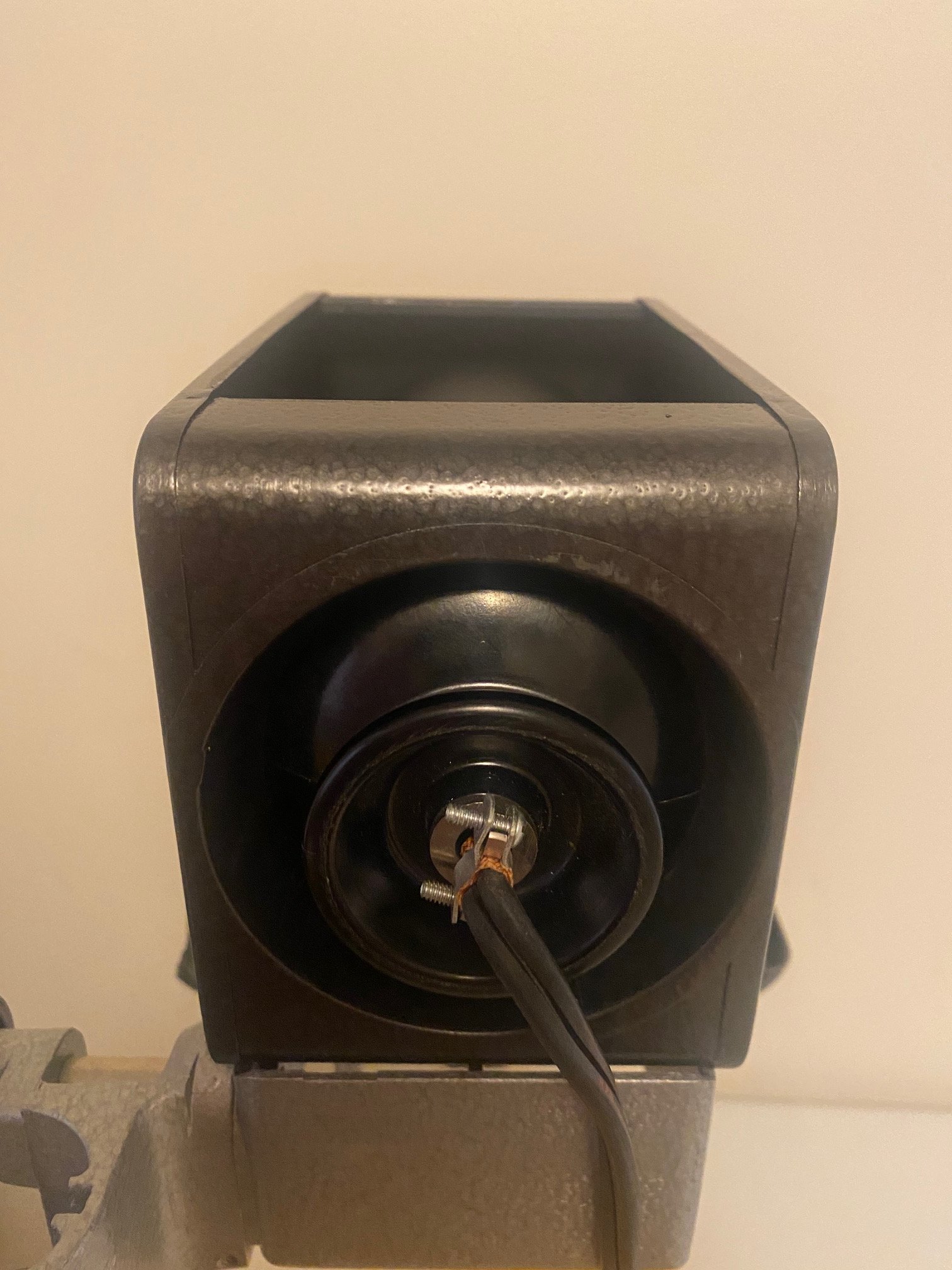

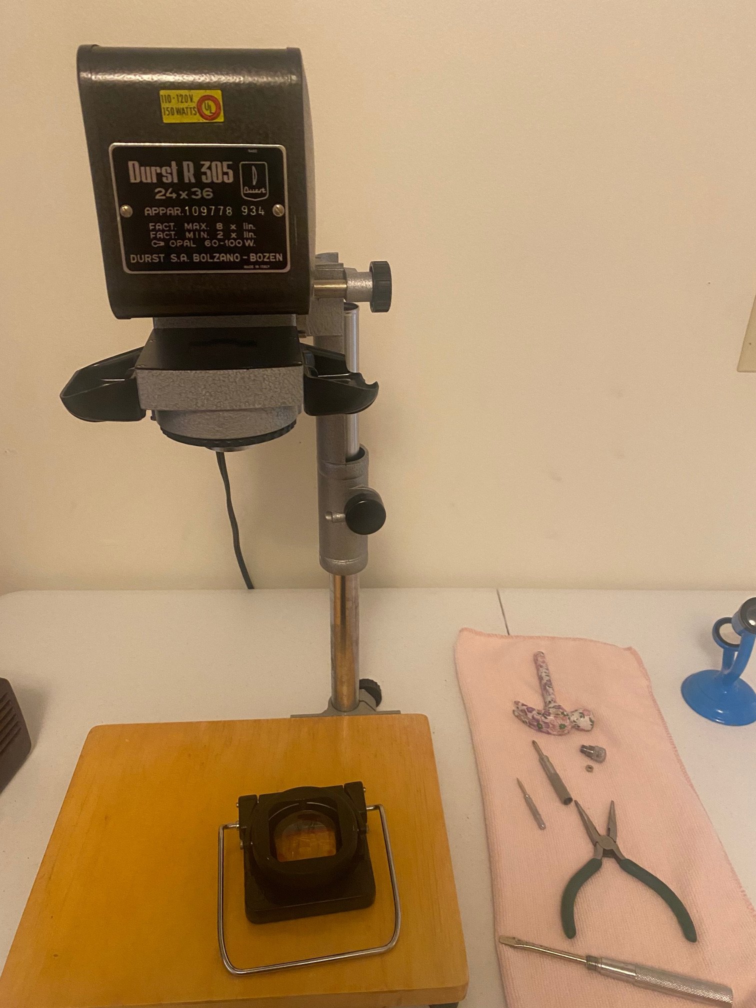

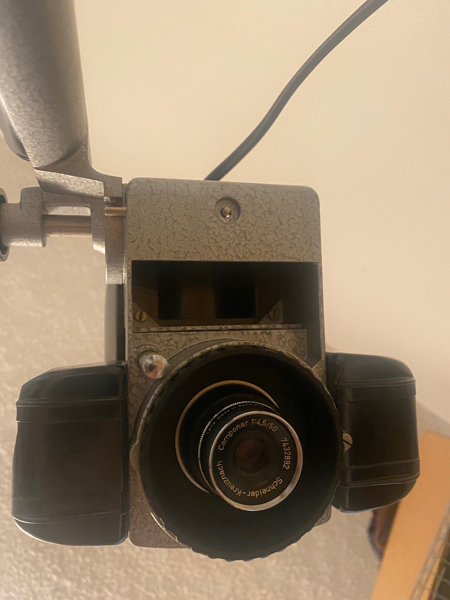

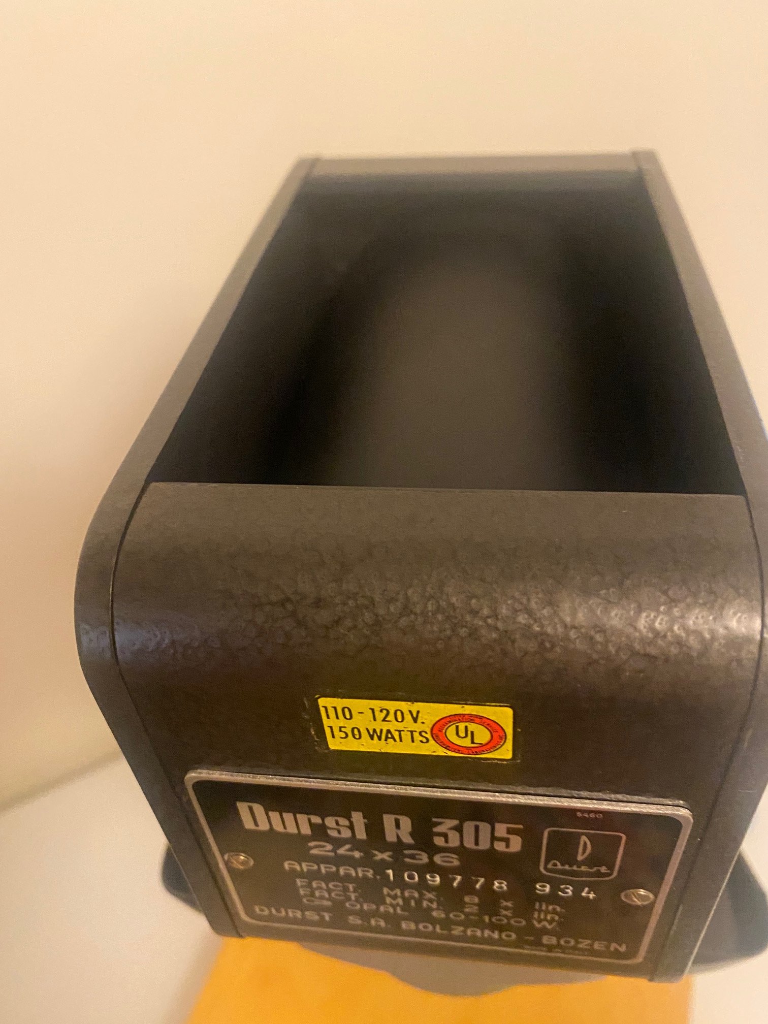

Here are pictures with the lens/neg carrier removed. There is a hole I can slightly loosen of tighten the current bulb but there is not enough space for it to be removed from that hole or another one to be installed. I also took out the screws from the front title plate, but found it only was for that plate. I also unscrewed the screw at the bottom back of the enlarger head (out in the photo) which seemed to slightly loosen the body of the head but not enough to do anything. Also, the cylinder you can see from the top is welded into the front so it does not turn...
It's such a simple model, I feel like I must be missing something pretty obvious ??? Thanks for all your responses so far, I appreciate your effort in helping me out!

Try unscrewing the two screws holding the nameplate on the front in. On the Durst Duomat and on the 609, that's how the bulb is accessed.

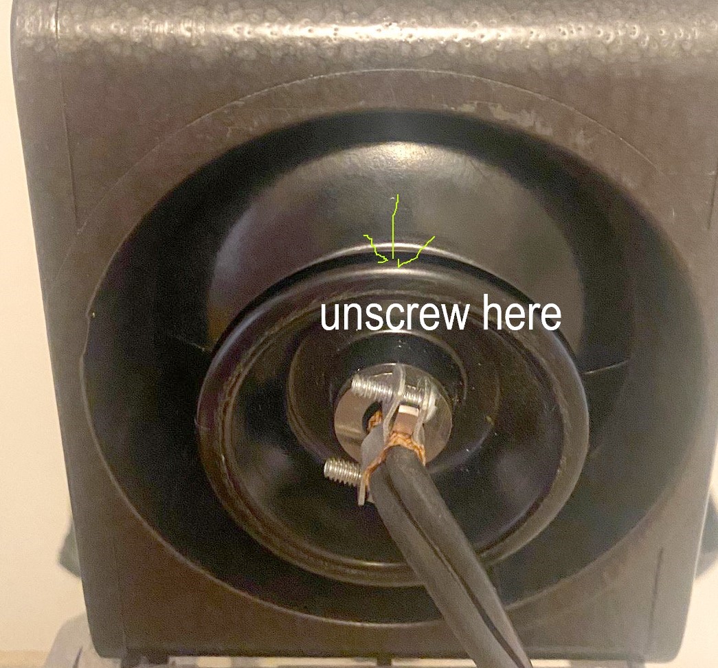

Having the welded construction of the enlarger head in mind and looking at the picture of the socket and the size of the hole in the back of the head I guess that the socket with the bulb can be extracted/pulled/screwed backwards out of the head. Maybe the socket is secured by a screw that you have to loose before, maybe it's fixed in the head by spring force, a bayonet or a kind of thread.

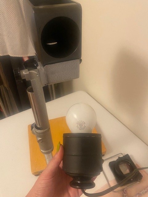

WHEW! So I figured it out! I went back and tugged kinda hard and turned the back piece that has the powercord (unplugged of course) and twisted it out of the welded cylinder piece, and whalllla here she is. Just ordered the new bulb, crossing my fingers she works! Thanks for everyones help, this community is great. Excited for my little at home darkroom setup <3 Ill post an update if it works!

Well done. It sounds like you have come across the diabolical "time-weld" that only involves air and lots of time to stick two pieces of equipment firmly together and that the instruction books always seem to suggest should be a simple twist that a five year old could do.
