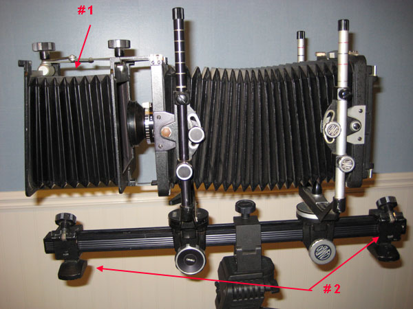

My film background thus far has been limited to 35mm B&W, but have always wanted to try my hand with a view camera. I recently acquired a Cambo 4x5 set-up that was to have included a manual, but the seller is still looking for it (sigh). I'm sure if they don't come through, I will find something somewhere.
Of course, I couldn't let a little think like that stop me from setting it up and tinkering a bit. It included a 150mm Schneider lens, some film holders, various lens boards, what appears to be a sync cord, etc. and an aluminum carry case for it all. There are a few things I don't quite understand.
The first picture (left) is the camera set-up. It appears the back standard is from a different model given it is not black like the front. The 'thing' (#1) I hung off the lens end, is this a lens shade.. I believe I have seen a reference to "compendium?" Also in this picture, does the rail appear to be standard length (it came with a second rail of the same length) and why are there, what appear to be, additional tripod mounts (#2) hanging from the ends?

just looks like an older model cambo sc. the front and rear standards are either from a diff. vintage or else from an accessory standard. See if the bag bellows mates on the front. could be part of an 8x10 sc conversion - as with the GG. I'd guess the part labeled no.2 is a filter holder of some sort. Might mate onto the end of the compendium - or not. the piece of bar stock..? no idea. could be from something else. See if the clamp on it works with the rail. That'll tell you something. Could POSSIBLY be an extension piece. The rail looks about normal to me.

The mount on the aluminum bar stock does fit the rail(s) so I guess I now have no less then four tripod mounts. The L-shaped metal bracket doesn't appear to mate or attach to anything I can see.. yet.

The small bar in picture 2 labelled #3 looks like a travelling bar used where you put both front and rear standards (inc bellow) onto it to keep them together when travelling. Looks homemade but cambo rail can be made from 1" aluminium box rail
Also the silver standard looks like my SC, he black looks like an SC2

Cambo made the parts to fit together. This way you add the 4x5/5x7 in front you get a long bellows 8x10. Or if you mount the samller back you get a smaller format camera. This also means a range of rail lengths were sold.
The extra tripod mounts are for when you use two tripods -) Long heavy lenses are better with a tripod under the front standard and one further back.
