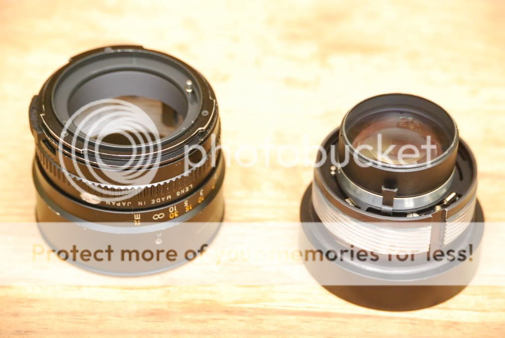

Hi - New folk around here, but long time reader. I got myself in a situation that I need you all to weigh in. Well my lens' focus ring began to move and not actually move the lens mechanism under it. I believe the screws came loose and it was turning with nothing happening. So I turned it a bit by grasping it and the lens proceeded to unseat itself (I entered uncharted territory). I now realize that under the focus ring is the part that goes up and down and below that is the aperture settings, see below.

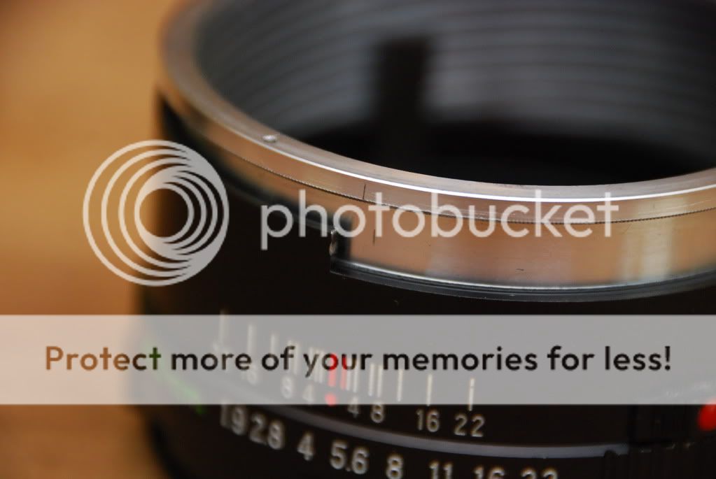

I see there are three screws that need to lock the focus ring into the mechanism (it is some kind of threaded riser) and one screw to make it throw from min to infinity, and I have no idea how high it needs to be (since it goes up and down and I moved it far from where it should be) and where the three pins need to be centered at and if the spot with the two screws needs to be set - at the near or infinity? I do see three spots on the riser that look like the three screws should align to but not sure.
Does anyone know how to put Humpty Dumpty back together again? I have tried for a few hours for no luck and now turn to my trusty friend, the internet to help. I am pretty technical so I think I can do it, but if you wish, tell me to take it in to a pro, it wont hurt my feelings. Thankfully I live in the Chicago area and International Camera is near but I think I can do it myself (maybe not??).

Thanks Curt! I took another 2 hours today and just felt all the parts and such and after a bunch of adjusting, it is back together! It is not 1:1 to what the focus ring says and what reality shows (e.g., when I measure out 3 feet and lock focus on an item at 3 feet and then look at the focus ring, it says something like 5 feet - but I am OK with that, so long as the pictures come out). I figure if it is in focus in the viewfinder, then it will be in focus on the film plane - which would not be the case if rangefinder. So I think I am going to just leave it as is - run some film through it, and call it a day if it works. If it doesnt, I will have it serviced. The aperture cant stop down anymore because I missed aligning that pin up (oh well), but that is no bother to me as I shoot 99% of my shots wide open and it is locked wide open now. I have no plans on selling this rig and find my new issues *charm*, so I guess I shrug my shoulders and just move on, maybe save the money and get some chromes run through the camera & savor the fun of it and not dwell on getting this thing back to perfect state since it took me so long to just get it here at 80% state. If it gets in my way I will have to drop the cash to get it serviced. In the meantime, got my eye on an old expired lot of tungsten 160T calling my name. Wishing you happy photos too and thanks for the advice.

Setting focus at near distance is the wrong end to do it at. Check and set it at infinity.
The focusing ring should be an empty tube with three screws to fix it in position, so put a ground glass at the film plane, focus at infinity and once you achieve that, set the focusing ring.
The score mark should be aligned with the edge to it's left in the picture. That's the infinity stop and the focus ring may have a machined section that gives a "hard stop" at infinity.The fact that it's there says someone has been into the lens before, they don't come from the factory that way.
The helical threads are called "interrupted threads" and they have as many start points as grooves. If, the focus is off by a significant amount, it's likely been assembled one thread off. If it's close enough, and works, leave it be, but at close distance it may just unscrew again.

At infinity the lens assembly should recess all the way into the barrel, go from there.

To all the above who commented thanks so very much! I was photographing today and the focus ring slipped again (I mustn’t have tightened it enough last time I was in the lens) so I decided to have one more attempt at adjusting it before sending it to a technician. Four hours later I got it! I am so happy you all chimed in, I was given the confidence and advice to take this project on and it worked! I might blow through a full roll of film in the next 24 hours just to get it in the soup ASAP and see if I scored a 100%. Jury still out but think I got it - infinity looks spectacular and close focus was looking good - plus the lens didn’t fall off when close focused, which is key (gotta be safe)! I also was able to engage the aperture too and am now able to stop down if I ever wanted to! Gosh, I almost want to buy a beat up rangefinder now and try to bring it back to life?? I might have the bug now...it was really elegant inside that lens seeing all those gears, springs, etc...
