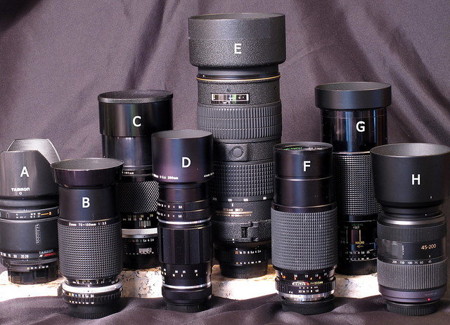

... I need advice on what zoom lens to get for a Nikon F2AS.
When I need a zoom lens for my Nikon F2, I select one of the following:
[A] Tamron 28-200mm f/3.8 - f/5.6 Zoom auto focus (72mm filter)
Slow, variable f-stop; auto focus lens
Wide focal length range
Given to me as a gift
Nice portrait lens
Nice travel lens
Good to use at events with telephoto length limit
Nikkor 75-150mm Series E Zoom f/3.5 AIS (52mm filter)
Fast, constant f-stop, manual focus lens
Low-cost
Good image quality in spite of the low cost
Good travel lens
Good for times when a bigger and heavier lens is not needed
[E] Nikkor 80-200mm f/2.8 D AF-S (77mm filter)
Fast, constant f-stop, auto focus lens that is also a great manual focus lens
Excellent image quality
Excellent for sports and stage shows
[G] Vivitar 70-210mm Series I AI f/3.5 Zoom (67mm filter)
Good image quality
Nikon 35-70mm f/2.8 or Nikon 28-70mm f/2.8
Nice travel lens
Great for one-lens/one-body situations
Great lens for shooting weddings
Telephoto Lenses by Narsuitus, on Flickr
