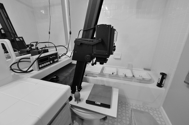

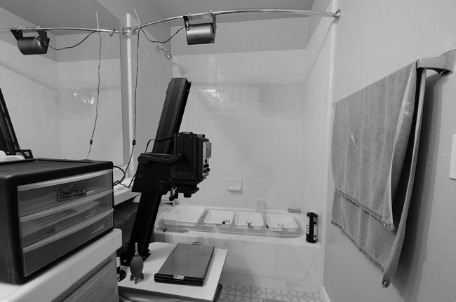

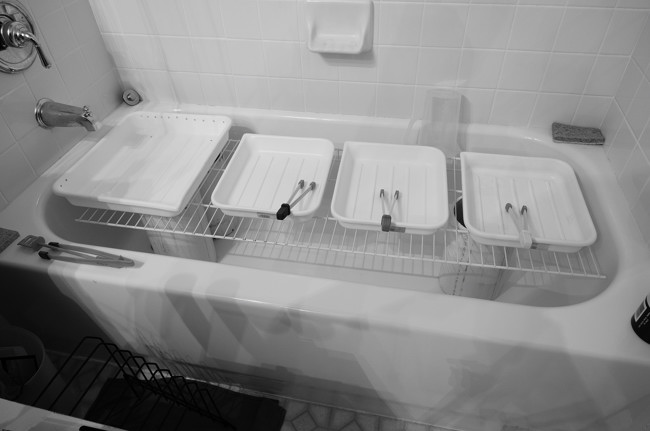

As said many time if you got the cash jump on it.
I have a small darkroom in my spare bathroom. Here are a few pictures of it. It's kinda cramped and a little uncomfortable, but it works very well, has running water, good ventilation(via the fart fan), and I can print up to 11X14. My last darkroom I had a Beseler 4X5 enlarger but it is too big for my current setup, so the 67 enlarger is all I can do.
