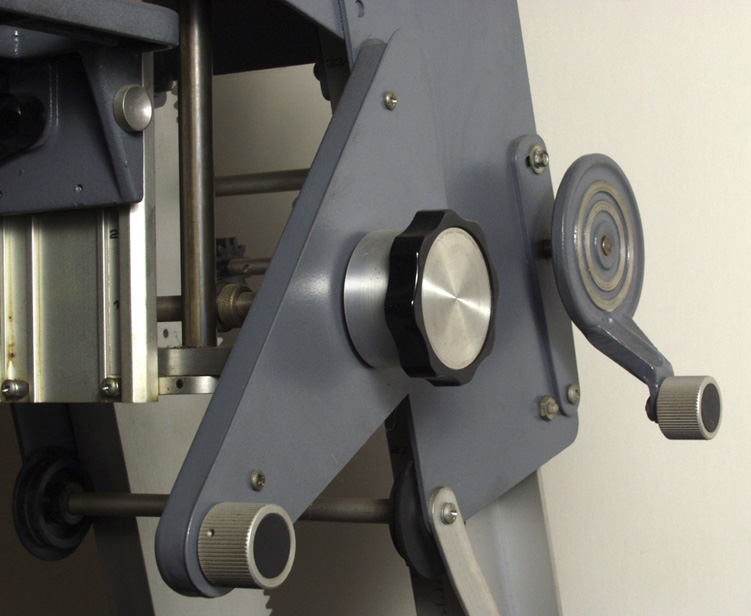

Is the masking accessory large and black with a circular depression in the top that the circle on (most) D series negative carriers fits into?
Like this:
http://glennview.com/jpgs/omega/d/mask/big_1.jpg
If so, there are two sliders on each of two slides, which are used to move four sliding blades to mask out stray light from outside the image area.
As for the manual, do you have a D6 based on the D2 (the "ProLab D6") or the D6 based on the D5 (the "Super D6 ProLab")?
The D2 based D6 has a support column that appears to be two separate girders, like this:
http://glennview.com/jpgs/omega/d5d6/microfocus/big_2.jpg
The D5 based D6 appears to have a one piece support column.

Hi Matt-
That is the masking accessory, and it is the early D6, based on the D2.

As for the masking accessory, you will see that there are 4 tabs - 2 along each of two sides. They slide, and the masking blades slide with them. You put your negative carrier on top of the attachment, and then slide both together into the area where the carrier goes. Lower the light source on top, and the entire unit is held steady.
I use the masking blades to:
1) eliminate light from areas of the negative outside my image area (if I am cropping a negative); and
2) mask outside the negative area, if I am using a glass carrier and a smaller negative (e.g. a 616 negative in the 4x5 carrier).
