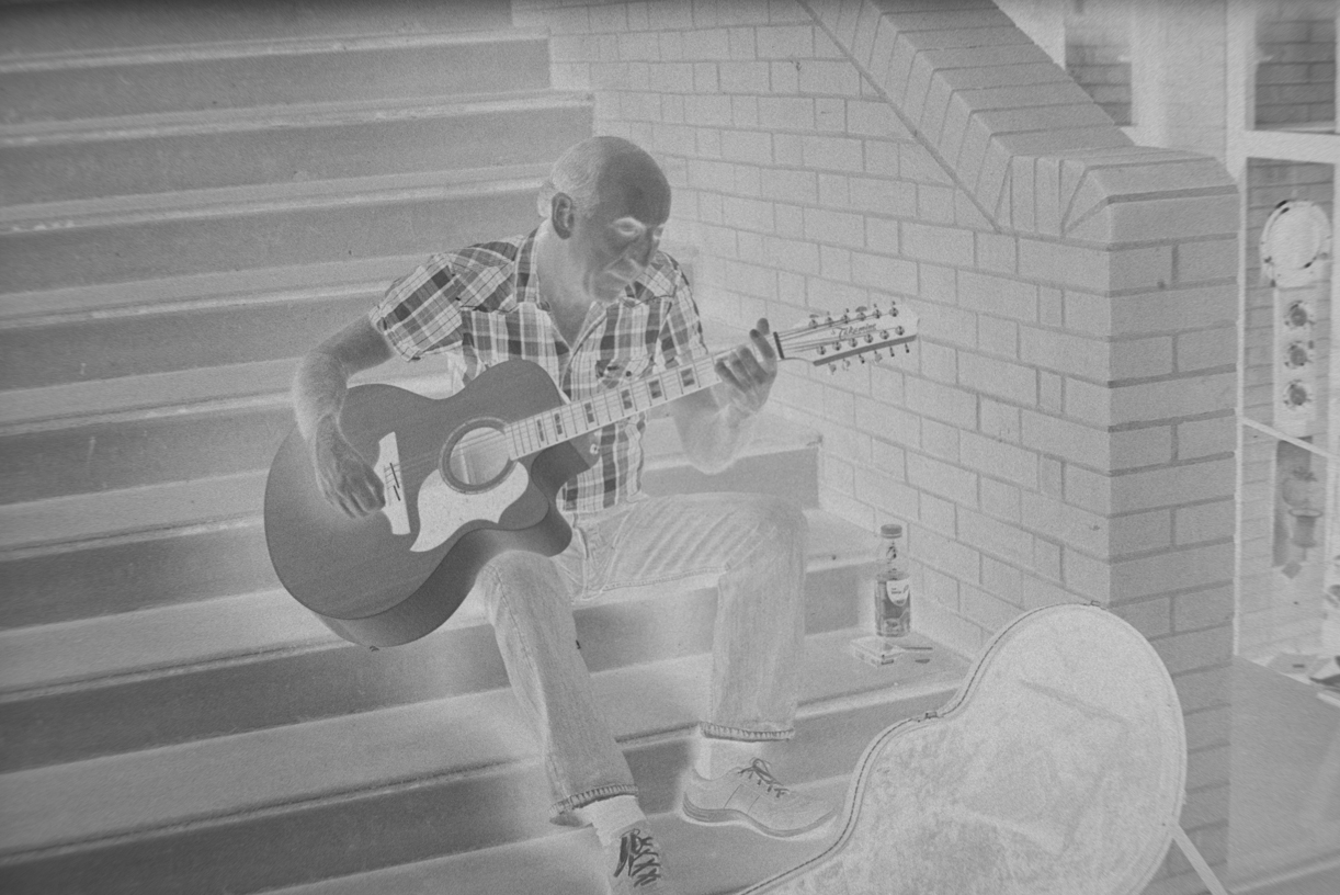

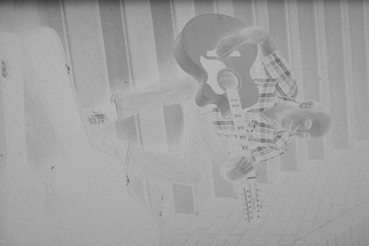

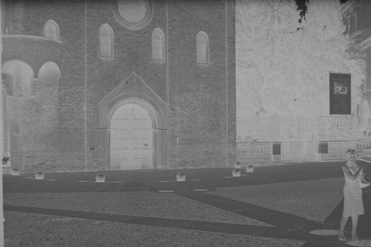

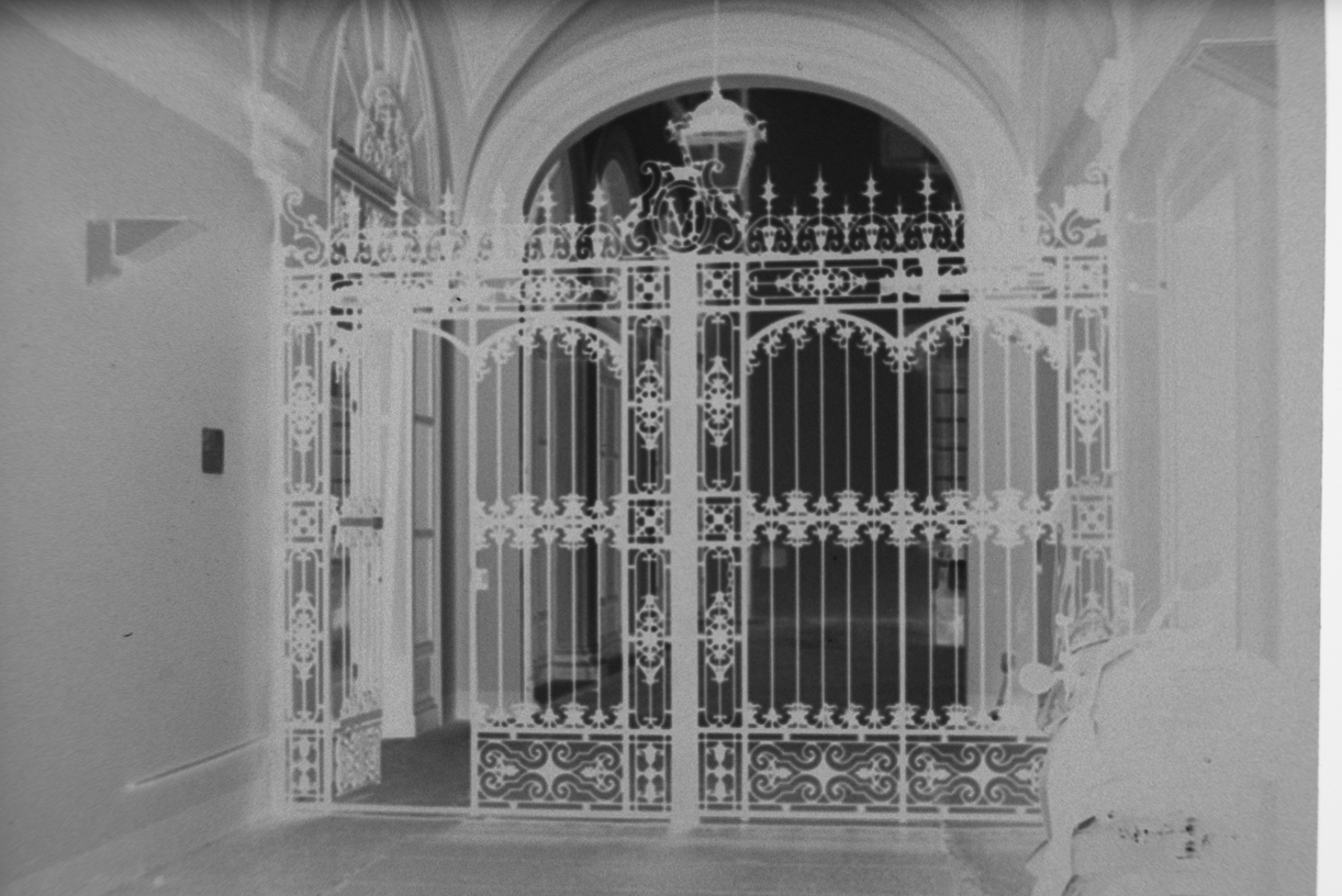

Hi all,
I have been trying HC-110 for the first time.
I had a roll of HP-5, exposed at 400.
i developed it in HC-110 dilution H (i wanted longer time) on a smal 300cc stanless steel tank.
the temperature was about 22 c° (cannot go lower) and time was 9 minutes, normal agitation.
the negatives look not so bad, but the tonal range is very compressed.
I "scanned" some with my D600, using a bellow and 50mm lens, and a TTL flash.
the histogram is centered, but tightly compressed.
What is my mistake? do i have to expose for less ISO, or change developing time?
i'm attaching those scans for your inspection...
thanks,
paolo

It looks under developed to me. At asa 400, try dilution B for 5 minutes to start.

Yeah, just seems underdeveloped. You'll probably be able to easily work with these negs.

You need at least 6ml of the syrup (based on US packaging, which at least used to and may still differ from Europe's) per roll. Dilution H is very dilute, containing only ~4.7ml of syrup in 300ml of mix, so you probably exhausted the developer, resulting in underdevelopment. Either use more solution, or a different dilution like B. The trouble with A and B is that developing times can be very short, so if your tank is limited to 300ml you might want to use D or E, especially in warm conditions.
HC-110 is a nice developer, you should be able to get it to work. Google "HC-110 Covington" and you will find a very comprehensive resource page. It is also available in German translation if that is easier for you.
