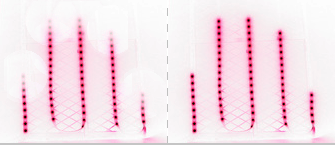

If you get the paper right up to the display, your photogram might look like this. If the display is active (bouncing up and down), it will look like the one on the left. If the display is static, it will look like the one on the right. This is a GREEN LED display:
that is super interesting thanks for that!
