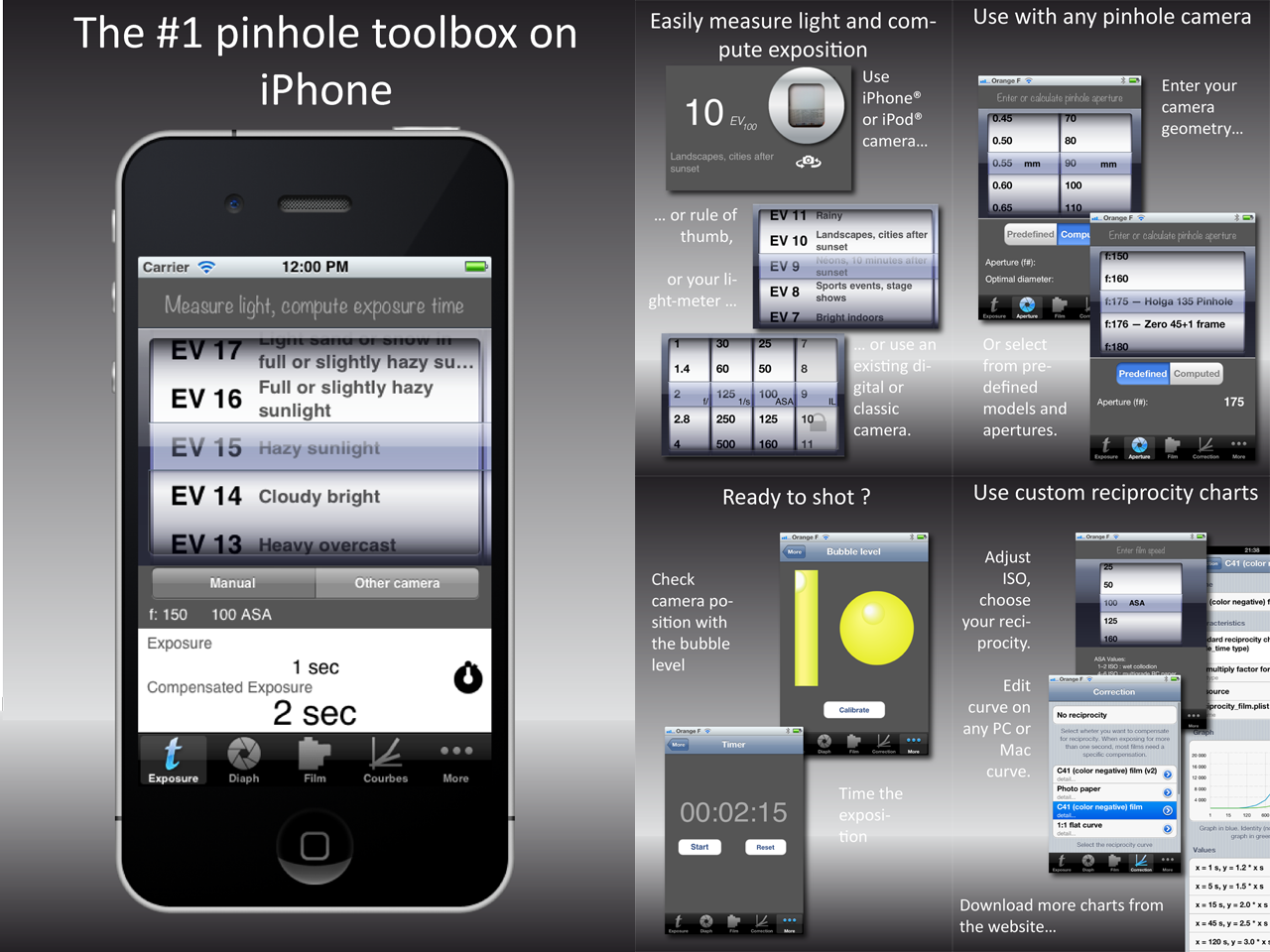

I found a neat little program for the iphone... called pinhole assist. it's $1.99 :smile:
With "Pinhole Assist"
• Compute exposure time ;
• Measure light;
• Enter your camera aperture from the predefined list or compute it;
• Let the assistant automatically compensate for reciprocity of film (correction for long exposures), or use your own curves.
http://itunes.apple.com/us/app/pinhole-assist/id466757473?mt=8&ls=1

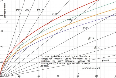

And here is a chart for calculating pinhole sizes (i made it :smile:, sorry it is in french)
new version of Pinhole Assist for iPhone
There is a new version of Pinhole Assist on the Apple Store since yesterday (Feb 27, 2012)
What's New in Version 1.7 (Feb 27, 2012)
* NEW: Bubble level for accurate postioning of camera
* NEW: Timer, for accurate metering of exposure time. Tap timer icon next to exposure time.
What's New in version 1.6.1 (January 2012)
* enhanced stability of the application. All known bugs and crash removed.
"Pinhole Assist" will be your companion to argentic pinhole photography.
• Compute exposure time;
• Use built-in exposition timer and bubble level for optimal shot
• Mesure light;
Estimate light or measure it directly with the camera.
Enter your camera aperture or compute it from your camera geometry.
** Many pinhole camera settings are already included : Zeroimage™, Diana™, Holga pinhole, Ilford/Harman Titan and many more !
Select your film's sensitivity (ASA) and decide if you use reciprocity compensation.
Select the reciprocity curve you want to use.Via iTunes, you can add/edit/delete the reciprocity correction curves. Go to the app Web Site for further instructions.
Tip #1: adjust cell measurement via the iPhone/iPod "Settings" application.
Tip #2: if using an external cell, set its sensibility to 100 ASA.
Light measurement is only available on devices with camera. The manual setting allows you do do estimation with text indication, or use an external cell.
