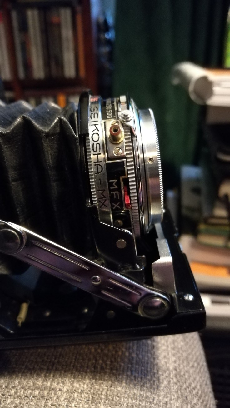

Now, I have a few questions. What does MFX refer to? It's a 3-way switch.

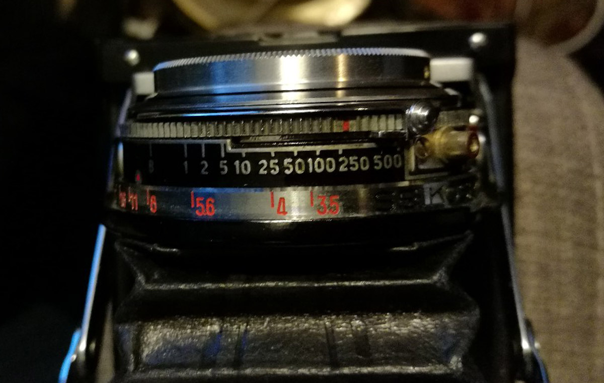

I assume the red dot is where I set the aperture? Currently set to f11.
And I assume the red dot here is for the shutter speed? Set here to nearly 250:

MFX refers to the three available choices for flash synch - use X for electronic flash, F for "focal plane" bulbs and M for M bulbs.

as matt said the mfx is for the flash, i have no clue what the F is for, but if you use an electronic flash you want
it on X ... i believe you have a 5 leaf shutter so it syncs at all speeds..

the dots are for hyper focal distance, so if you want and have the right lighting you set the shutter speed at 250 and the
fstop at 11ish and just focus and shoot ... and yes you have to cock the shutter every shot.
Incorrect (partially). M is for type M flash bulbs which require a 15 millisecond delay, F is for type F flash bulbs which are gas filled and require a 5 millisecond delay, and X is for electronic flash which fires when the shutter is wide open. Focal plane flash bulbs are marked FP, require the same delay as type M, and have an extended burn time.
Type M and F burn for about 20 milliseconds, type FP burn for 50 to 60 millisseconds.
Use 1/30 or slower shutter speeds for flash bulbs, any shutter speed for electronic flash.
