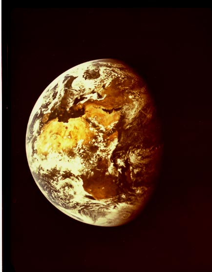

Have you ever seen original flown slides from NASA yourself? I would like to know if they had a color cast back then, or if it is an effect of aging. Even though the slides are stored at 0 degrees C or just below at NASA's archive in a climate-controlled room. They are pretty old now for Ektachrome slides, which are known to age badly unlike Kodachrome.
Yes, I was present when they were processed. In fact, I flew in a Huey back from the cape with the film for rush processing. We had to avoid the crowds on the beach, so I laid on air transport. The cross processed film had color problems that were partially corrected by Life and Nat. Geo. I have a special edition NG magazine for "participants" that is about 25 pages long and has many photos.
Sadly, some are ageing poorly and many have been destroyed in a NASA house cleaning years ago. Same thing with USAF copies. Gone! I have posted some here.

PE, what do you know about the original Blue Marble shot? I read on Wikipedia that it was an 80mm lens on the custom Hasselblad. How fine-grain was this Ektachrome film they were using? It seems like what you'd get after processing would be a black transparency with a blue dot on the middle that would be difficult to enlarge.
Or just how large does the Earth really appear from the Moon?
That shot was taken about 1/2 way to the moon, and the earth filled the sky pretty much. From that POV it was not too blue due to being over the east coast of Africa.
The shot was, AFAIK, taken with the Hassy with a normal lens.
