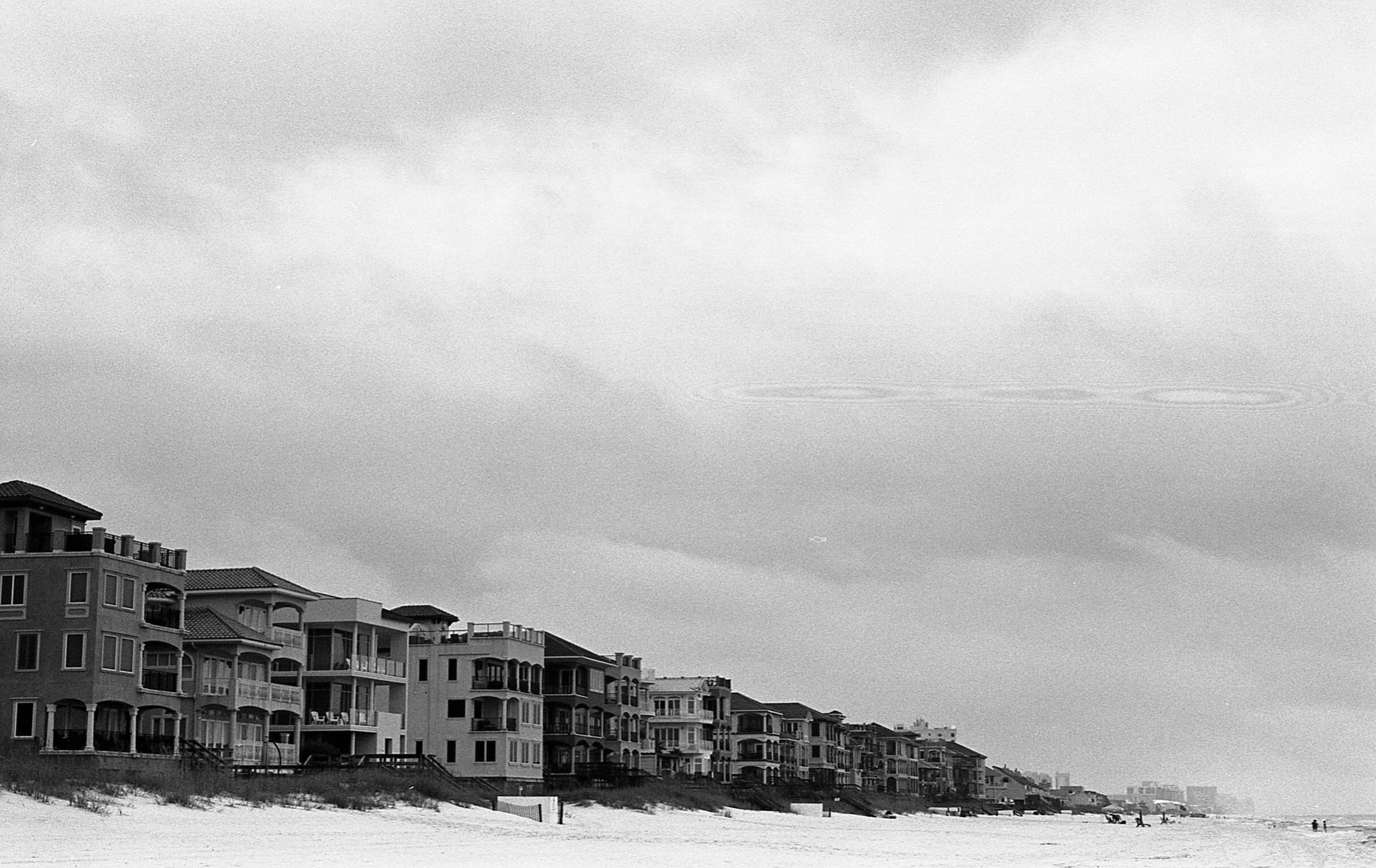

So, I'm still struggling with getting a solid process for drying my 35mm. I'm having issues with getting all the water off. The emulsion side is so tacky that squeegeeing feels, well, wrong. I've read that using hypo may make the emulsion less tacky, but before I add another step, I thought I'd submit an example to see if the problem might be something else -- ie, poor reeling or agitation. So, submitted for your eyes is the following 35mm shot. Notice the streaking on the right, center latitude. This shows up in three consecutive frames, same latitude. Any and all thoughts would be greatly appreciated. FYI, Tri-X developed in Microphen.

Yes. And I didn't even think of a scanning issue! Thanks - you just made my day. I just started scanning. I use an epson v600; mostly just to organize, get a better look before I make prints, and share. If I want a print, I do it the old-fashioned way.
Another vote for Newton rings. Take a look with a loupe and you won't see them. Caused by the film touching the glass of the scanner. If using a flatbed, you can try flipping them over so the curl goes the other way and they should go away.
Scanning issues aside, is it worth it to add a hypo to my workflow? Or sponge? Or just quit fussing?
Done. And yes, the negative is just fine. I feel like a dolt.

The answer to your question is that wash aids should make no difference to drying, and the artifact you see is most likely newton rings - a scanning artifact.

If you scan with the emulsion side on the glass, Newton's rings are less likely - the emulsion has just enough texture that they shouldn't be a problem. And depending on your scanner and some other things, the scans may be better
Huh - never thought of that. And just flip the images. I'll give this a shot! Because the negs are definitely curling so that the center bulges toward the glass (emulsion side up).
