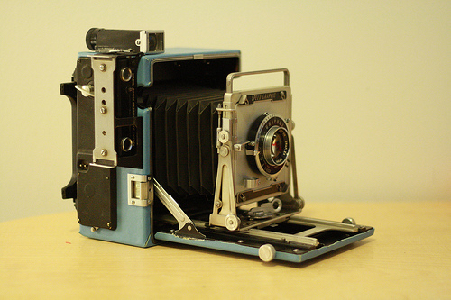

This is mine :D It's a pre-anniversary wide angle Speed Graphic special which was modified during assembly by an unknown workshop.

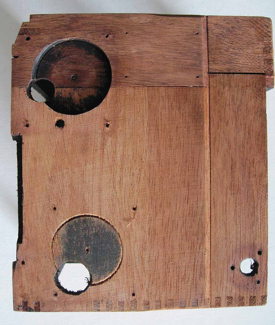

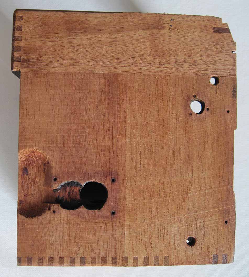

I don't know what kind of glue they used, but...wow. It won't peel off. You can't scrape it off. Using a razor blade won't work because the wood is soft and it's too easy to dig into it. Even the solvents I use for stripping the decals and pinstripes off cars didn't work. Ended up using AN ELECTRIC SANDER to remove it.
Use Steam. Wet a cloth or sponge almost to a drip with very hot water. Place saturated cloth on a section of the body for 3 to 5 minutes. Using a straight edge rigid blade putty knife scrape the covering off. Leaving the wet cloth on too long results in the covering turning to goo and the grain of the wood starts to raise.
2 1/4 X 3 1/4 RB Series B made in 1949:
toolbox
May 7, 2012
18
Montana
View attachment 86603 View attachment 86604 View attachment 86602

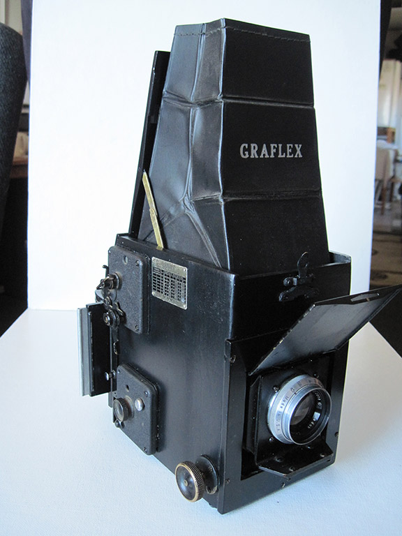

I've one of those (postcard size) Graflex reflex cameras to rebuild, after I've rebuilt a few British SLRs, and a dozen or more shutters :D.
This one's been recovered just needs final assembly after I fitted new shutter curtains - the shutter and mirror box is modular so much easier than Graflex cameras, much more modern shutter design as well (despite being older).
