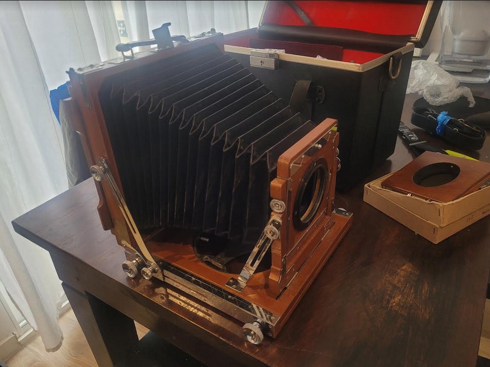

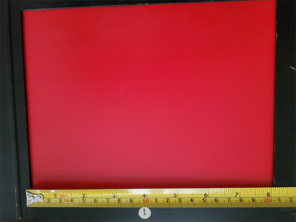

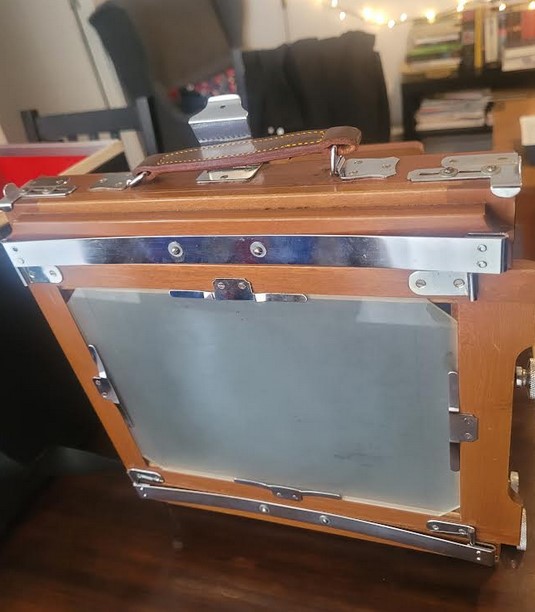

Hi all,
I was toying with the idea of getting a 5x7 field camera somewhere in 2023, but as things happen, I pulled a trigger a tad recklessly on something I saw on the interwebs.
It's a LF Nagaoka, it's beautiful, but it looks like it's non-standard, so I wanted to see if I can get some hints out of the community. Rather than trying to sell it to then look for a 5x7, I would make it operational, but I know very little about LF photography so I would like to understand if mine is a fool's errand :smile:

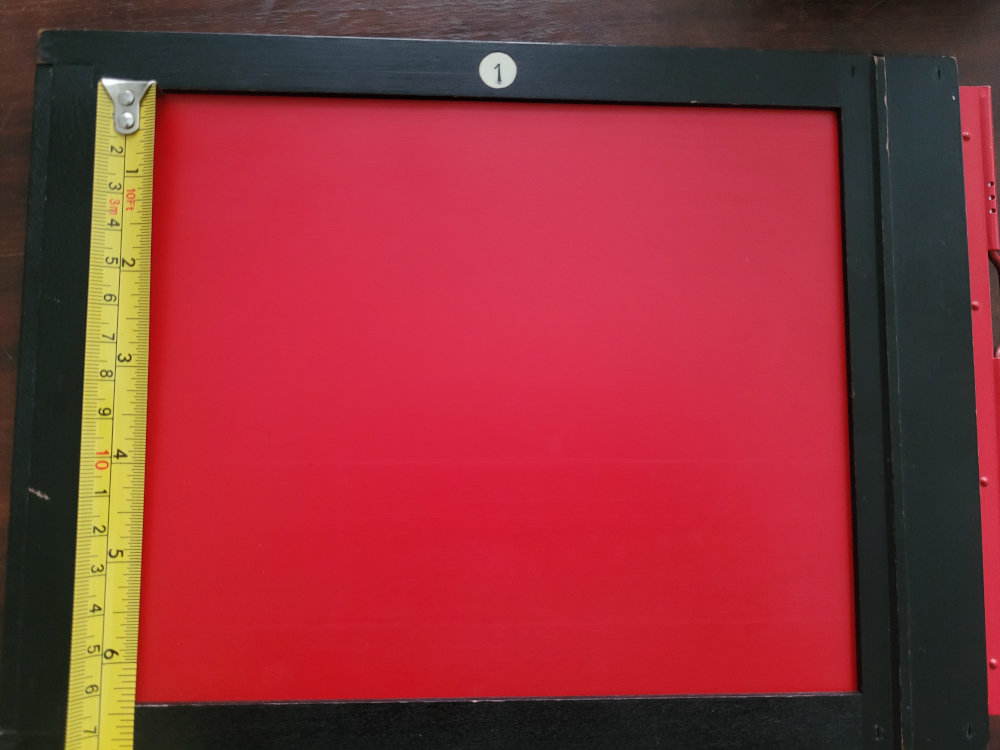

Holder size & negative availability.
Can someone help me to confirm it? From what I found on the web it looks like it is whole plate-ish, but I am not really sure (pics below)
I shoot only B&W and it seems negatives of this size are available only during the yearly Ilford ULF run. Also I was hoping to develop them with something like the stearman press tanks (which I don't have yet), so I suppose I'll have to find another solution
5x7 reducing back - does it exist?
this would probably make things much, much easier (including finding lenses that cover, etc)
Lens plate

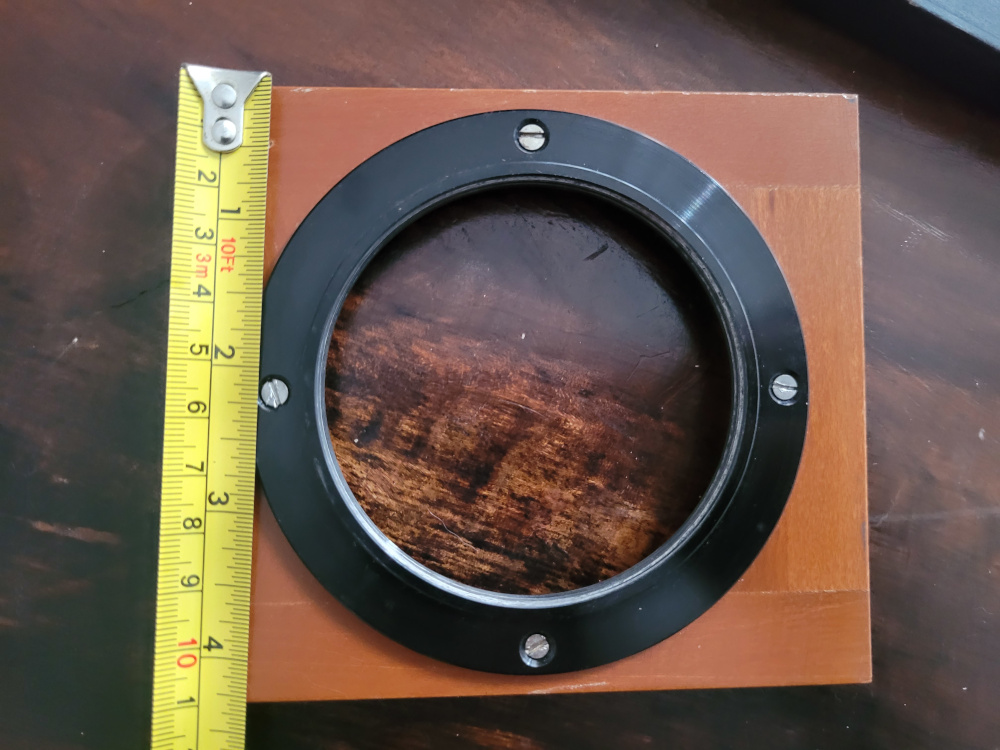

Thats another odd one. The lens plate I got (without lens) is a wooden one roughly 5x4.5 inches, with a thread *roughly* 3 inches wide. The lens "hole" seems wider to what wikipedia suggests as copal's threads, and I am not sure whether some kind of readily available boards are compatible. Any hints?
Thanks in advance! :smile:
Whole plate film is available through the Ulford ULF annual run, it will be expensive. The only countries who made Whole plate cameras were the UK, India, and Japan the latter two making copies of British Houghton cameras.
I had a whole plate De Vere monorail camera with Half plate and 5x4 reducing backs, there were some whole plate film holders with the camera when I bought it 45 years ago, but they were falling apart. You need Internation fit film holders, they fit a spring back, as opposed to the more common, older, book-form holders. I din;t know what make mine were, there's one on eBay, I think it's Kodak Ltd, as it looks very similar to some of my Kodak Ltd Half plate holders.
A reducing back would be easier, as long as it's an International spring back, it doesn't matter if it's Half plate or 7x5, or even 13x18cm, as the film holders all have the same outside dimensions. If you can't find a Whole plate to Half plate reducing back there were quite a few 10x8 to Half plate/7x5 reducing backs. What ever you get may need modification.

I own an 8x10 Nagaoka, yours looks pretty much the same as what I have. I made my own lens boards, same size as yours it's easy if you own (or have access to) a bench saw. No telling what that mounting flange fits, measure the diameter and if possible the thread pitch. I see you have a second lens board, do you know what it's drilled for? If you are handy you could find a cheap 5x7 back and make an adapter to use it on this. I would also contact B.S. Kumar who sells here if he could locate a reducing back for it.

I am fairly ignorant as per the terminology, but the back with the ground glass can be pulled, and I can fit the double-sided film holders between the glass and the camera. Not sure if this is an international spring back though.

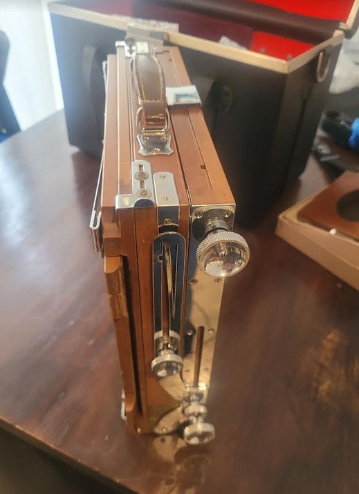

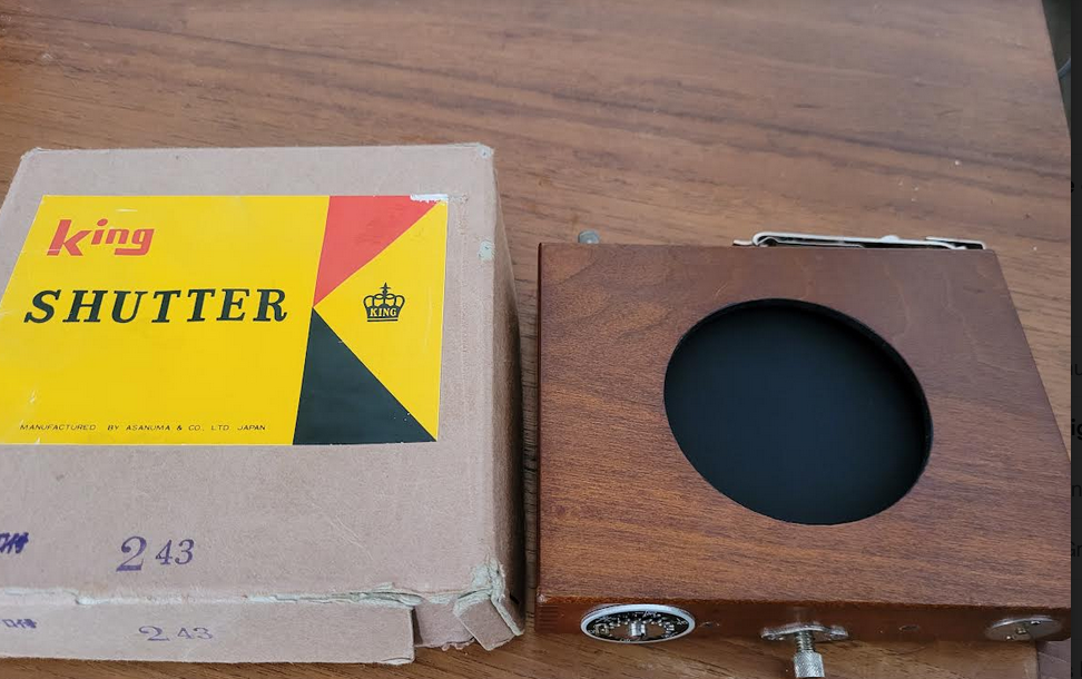

@Rick A - the other one is not a board (pic below), but quite a crafty cloth shutter, spring loaded! It can set times from 1/15 to 1/90 in /15 increments. I've seem some threads on making the boards in-house, I could ask a friend that does some woodworking and see what he thinks

your camera dimensions are standard for the Nagaoka/Charten/Wageesari (sp?) Japanese and then later India marketed early 20th century whole plate cameras. Yours has a spring loaded back to adapt for the Kodak whole plate double darkslide holders although you might have to check the T distance of your film plane coincides due to the variation of Nagaoka cameras with the Kodak standard for whole plate.
These are more common with bookform wooden holders and a latch hinge for accepting custom holders using dry glass plates. The condition of yours suggest that someone has previously modified it to work it for modern film.
You can use any cut down orthofilm (easier to see under safe lamp); positive direct photographic paper; normal photographic paper - not just the Ilford ULF+ or Kodak special cut order.
Your idea to modify a back for 5x7 is a lot of work: a dedicated half-plate back accepting 6 1/2 x 4 3/4 half plate exists for this camera. The whole plate format is a beautiful intimate hand held format for a private viewer within arms reach and holds its own for spatial size particularly for contact print: 5x7inch is rather smaller like a postcard format.
The era of your spring loaded King cloth shutter is appropriate for the camera; I'm sure you can swatch out the flange for the barrel and recreate any of your own choosing, or even add a shuttered lens instead of using a rear Packard style or front / rear Thornton Pickard style. Your shutter mostly resembles the Thornton Pickard style cloth blind mechanical shutters. Your camera is a different aesthetic and mindset from the metric modern camera era and had many iterations over decades, in various woods and forms. The best had tropical hardwoods (don't expand in humid conditions) and lightweight compared to modern field cameras with double extension.
The King shutter is for front mounting on a barrel lens, i's a copy of the Thornton Pickard roller bling shutters. They can be useful.

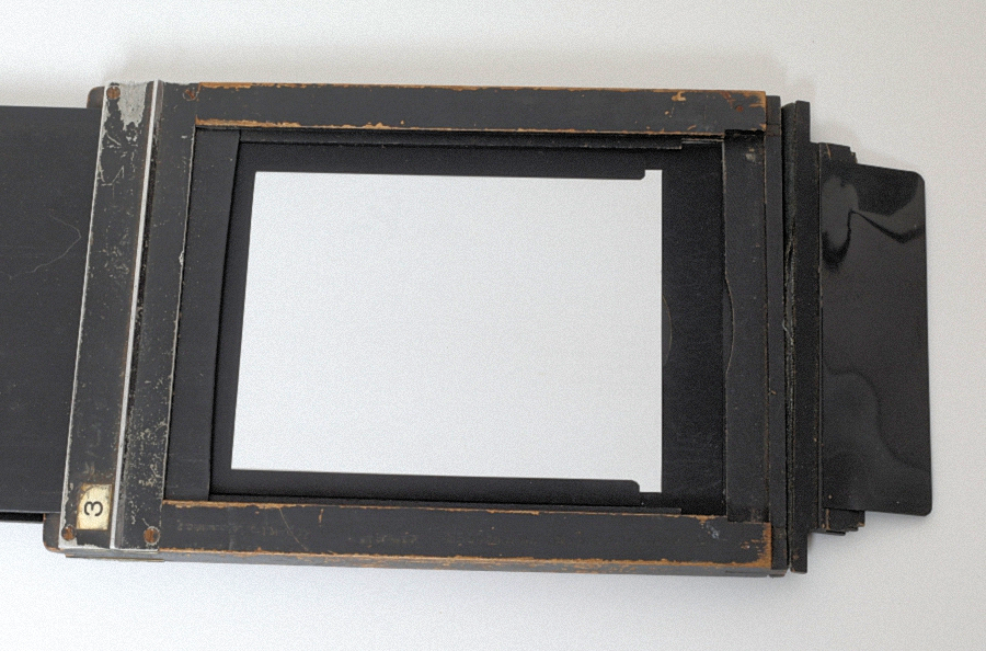

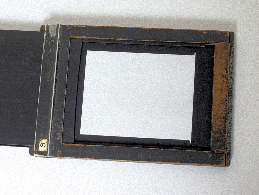

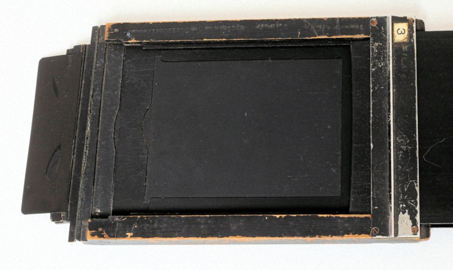

I have some Kodak Ltd Half plate film holders that were modified to use 5x4 sheet film. I need to photograph them for someone else, there's no need to 3D print anything. The method is really neat and simple. They used exposed and fully developed scrap film.
I'll try and take some images tomorrow.
Ian
That would be brilliant! I was thinking of sliding inserts, tetris-style, to reduce the useable area... but the simpler the better!
Here's one of the converted Half plate holders.
This was a film holder, you'd need card or aluminium sheet of the right thickness to compensate for the thickness of the glass. Essentially first there's a pice of film that fits the holder cut out to take the smaller size film, with that slight curve bit cut away to allow easier film removal. Then two guides to slide the dilm under and into place. Finally, there's a piece of old film on the flap.
With thin card to show loaded.
With the end flap closed the film can't slip out once loaded. There was film loaded in one of these when I bought my Kodak Specialist 2 Half plate camera - essentially an upgraded 2D model never made or sold in the US. These holders obviously had a lot of professional use.
It is possible these were sold like this by Kodak Ltd. Anyway it's easy to do.
Ian
