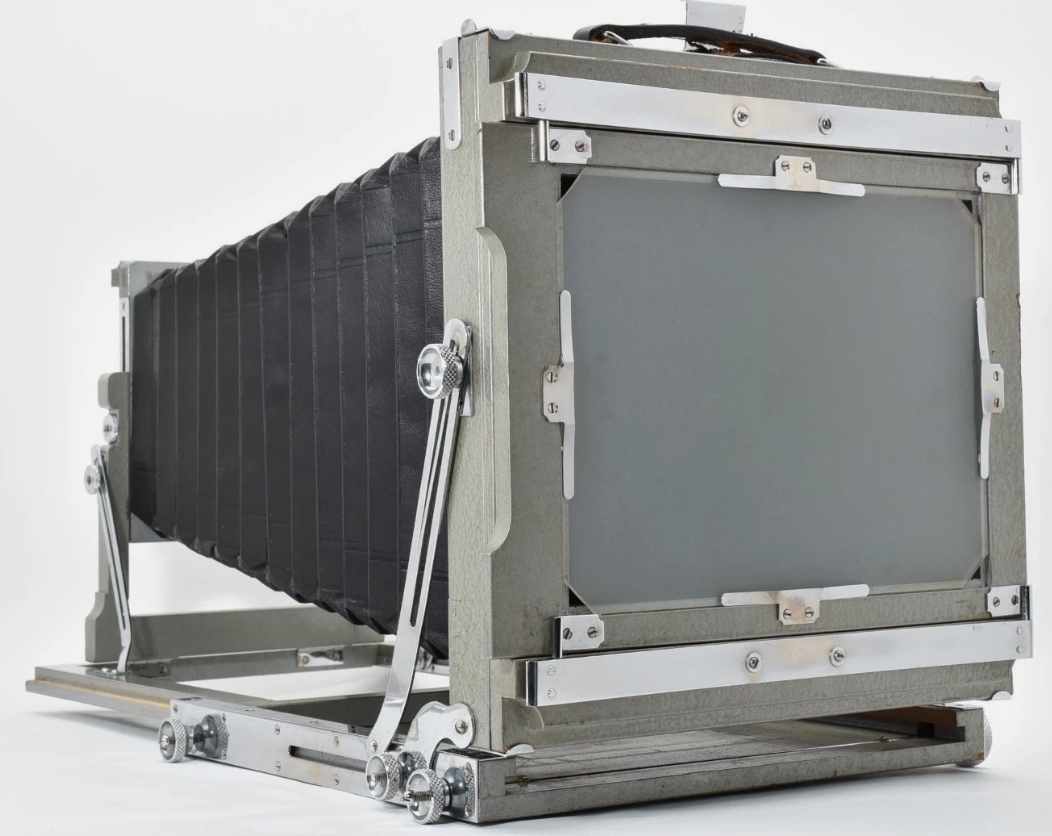

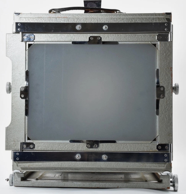

Hi,
is it possible to tell from the photo and this description what size it is?
The camera measures approximately 26 cm both vertically and horizontally.
The frosted glass measures approximately 16.5 cm vertically and 22 cm horizontally.
The diameter of the film holder insertion port on the camera's side, behind the frosted glass, is approximately 19 cm.

No need to enlarge it, whole plate is a wonderful size for contact prints. I should use my WP cameras more often...
Yes, I don't have an enlarger that will enlarge above a 4x5 negative, but I have a WP camera. Also, contact printing rather simplifies your printing routine; a sheet of glass and a bare light bulb are inexpensive!
