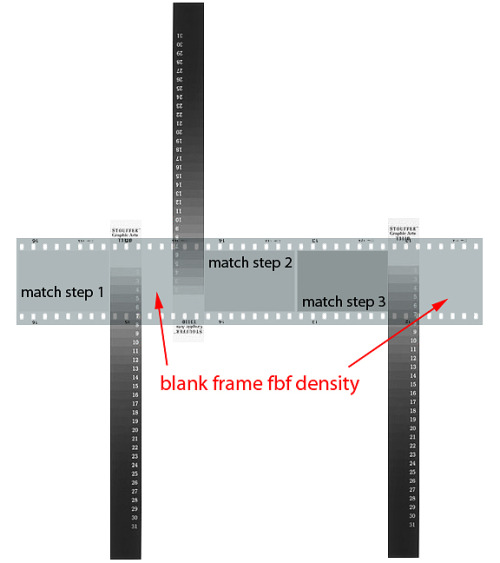

A stepwedge is not hard to use at all. It is basically a transparent gray scale. If you look at the density of your test frame (assuming you have photographed a single toned surface as your test target) with the stepwedge on a blank portion of the film adjacent to it on a light table, you can easily match the two densities. One of the steps will look identical (or very close) to the appearance of your test frame and that will tell you the density you have achieved on the target frame.

Your comment about "eyeballing" vs. a more "technical approach" is understandable, especially if you've only read Ansel Adams or Phil Davis, etc., on the subject of the Zone System. If you are reading a bloated text confounded with page after page of technical info, numbers, and charts, the technique may seem daunting at first. The stepwedge simplifies everything because you don't need to refer to all those abstract things. You can simply compare results visually:
Let's say your fbf density of the film is .07 and the first step on the wedge is .05 density (which is the fbf of the stepwedge). Since the first film frame matches the density of the overlain stepwedge's step 1, it has a gross density of .12 (=.07 for the film fbf and .05 for the stepwedge fbf). However, you are not really interested in the gross density but rather the net density caused by the exposure and processing. The net density of that exposure on the film is .05 over fbf since it visually matches the overlain stepwedge step #1. That is not enough exposure for the speed point and is an underexposure for Zone I.
The second and fifth frames above are blank to facilitate comparing frames to the stepwedge.
The third frame matches at step 2 of the stepwedge. The net density there is .15 (= .05 step 1 fbf for the stepwedge + .10 step incremental increase). There's the speed point frame and the proper exposure density for Zone I.
The fourth frame has a net density of .25 [= .05 fbf for the stepwedge + 2(.10) for two additional steps @ .10 each)]. That's too high for the speed point and is an overexposure for Zone I.

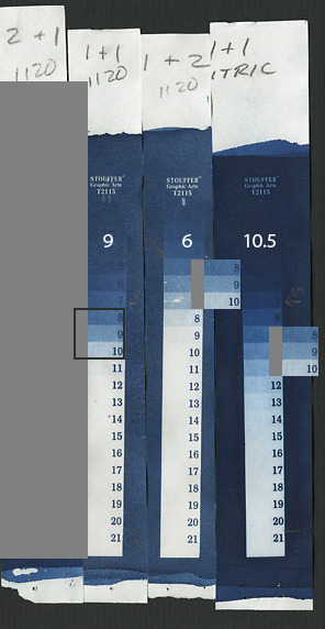

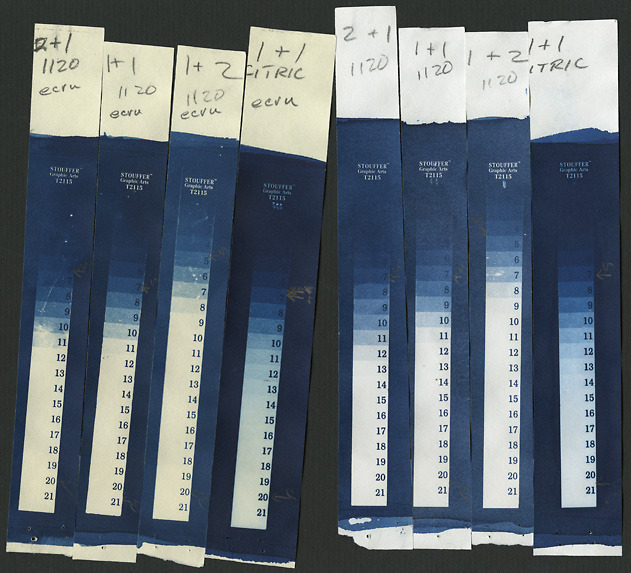

Here it is showing the different tonal response in a comparison of emulsion ratio between part A and B in cyanotype chemistry and 2 different papers, ecruwhite and bright white Crane's Kid Finish. Note that the contrast changes as well as the overall tonal range given identical exposure and processing to each test strip. Interesting that the use of 2% citric acid solution instead of water as a rinse deepens the maximum tone but also causes bleeding in the highlights. It tells me I want to avoid the use of that chemical with these papers and emulsions.
Here I've isolated the same middle gray tone against the various test strips and duplicated the matching area to show differences between treatments. Matches are made at steps 9, 6, and about 10.5 in the different treatments. (Probably easier to see in the desaturated copy.) This tells me that I need more or less print exposure to get a middle gray tone depending on the emulsion composition, processing and paper. (Note I've used a 21-step tablet here instead of a 31-step tablet. Each step on this tablet increases .15 or 1/2-stop with the first step about .05.) I'd need a density of about 1.25 (step 9) to reproduce the midgray tone on the first strip, only .80 (step 6) in the weaker second strip condition, and about 1.50 (between steps 10 & 11) for the last strip condition.
You would see similar effects using different silver gelatine papers or contrast filters, paper developer formulas or dilutions, toners, etc. Once you test, you can determine exactly how you should print a negative based on its negative density range (DR). For example, you might find a certain DR matches the 3# multicontrast printing filter while a different DR fits a #2 filter. The step wedges are very useful things.
