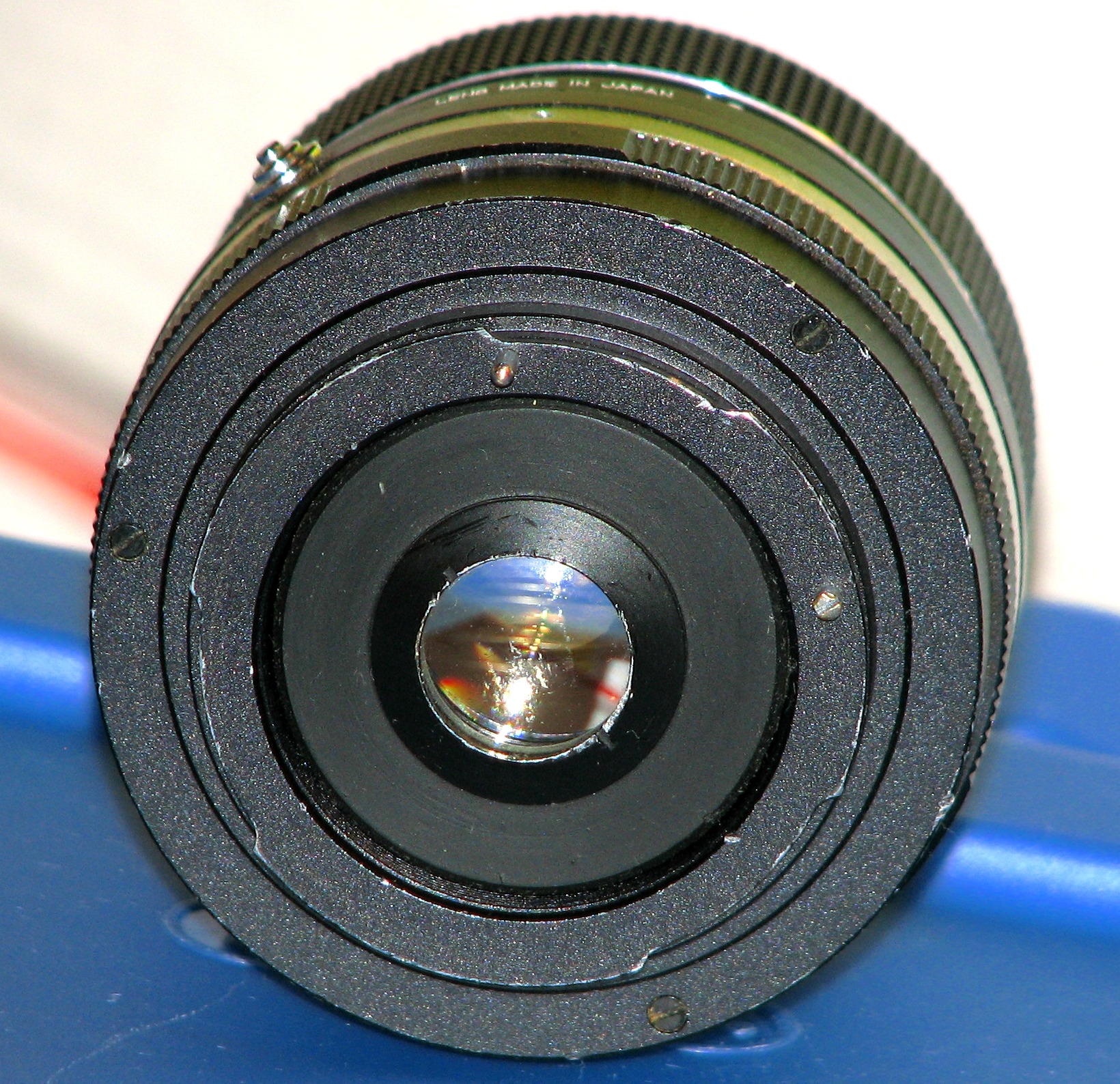

Can someone DEFINITIVELY tell me what mount this is? It is a 35mm Cerenar lens and the pin at about 12 O'CLOCK is for stopping the aperture down. At about 2 O'CLOCK there is a protruding screw. Thank you. - David Lyga

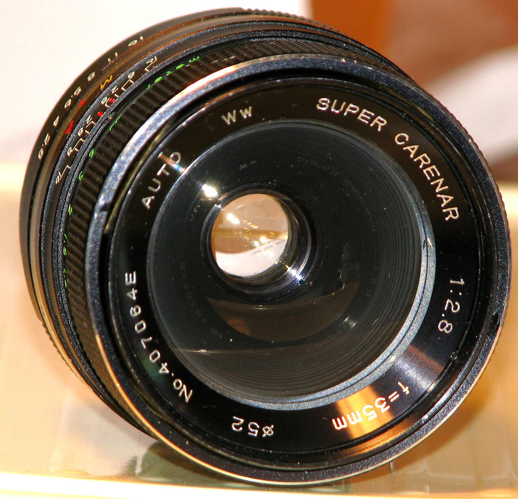

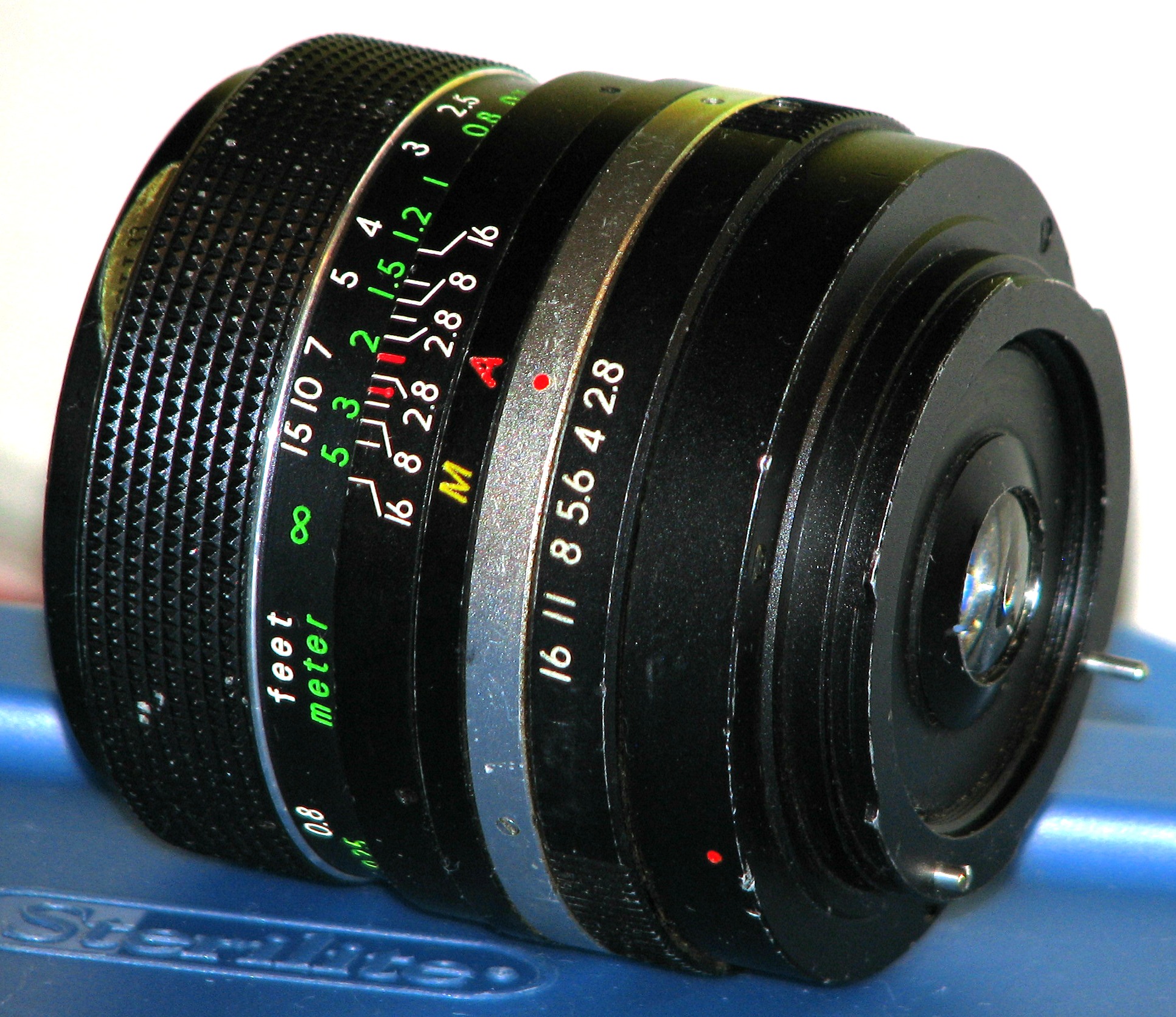

OK, here are more photos. I do know one thing: the mount is NOT Mamiya bayonet, Petri, or Rollei. (I have those bodies and this lens does not fit. Also, I have those lenses and their mounts are different from this mystery mount, although the Rollei is close.)
The third photo shows, again, the stop down pin at 12 O'CLOCK (like on M42).
Why Japan found it so difficult to print the mount name on each lens is utterly and profoundly inexplicable. - David Lyga

I think it's a Rolleiflex mount. You know, the SL35 model.
Sorry David, now you got to get a SL35 body.
ciniframe
Jul 3, 2014
803
Sub 35mm
On second thought I just looked at the back end of a Rolleinar lens and that ain't it. Wow, I'm stumped, what a weird mount.
miha
Feb 15, 2007
2,994
Slovenia
It's an Exacta (Twin TL) mount.
