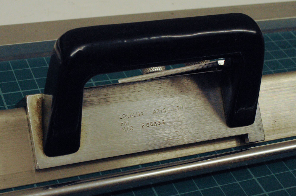

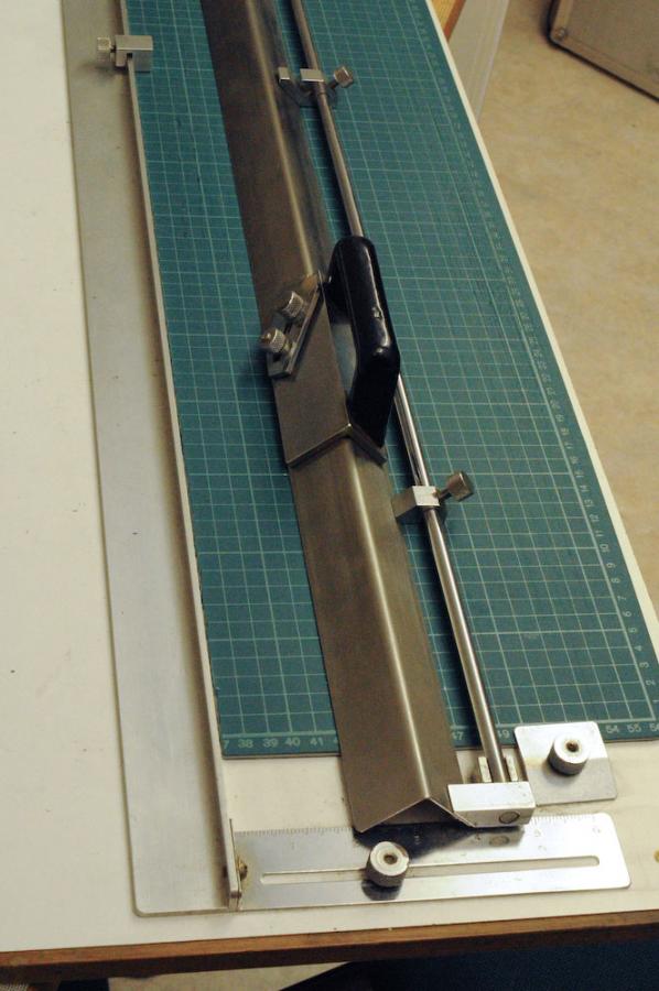

I've always cut bevel mounts by hand with a Logan and a straight-edge, but was recently given the old board cutter shown in the attached pictures.
The person I got it from had no idea how it was used and I'm having problems working it out, never having used one myself before. It would be really useful to me at the moment as I have a whole bunch of mounts to cut for a show.
The only identifying markings are stamped on the cutter itself - Locality Arts Ltd, and a Patent number. It's pretty old, but looks serviceable.
Has anyone got one - or seen one - like this? Any advice on how to set it up for cutting would be much appreciated.

Looks like it should work a lot like the Logan 650 I have. The blade is in the handle mount and the rail hinges at the front so you can slip the mat board and backer under it. The back stop is set for the border width and the side stop holds the mat while cutting. The thumbscrew stops are limits so you can set up a cut and repeat several without having to mark the matboard. It looks like the cut is made drawing towards the sidestop that is mounted on the backstop. In other words you will be standing at the far end in the picture and pulling the handle towards you. You will need to be sure and hold the mat against the back while cutting to keep the cut from pulling out of square.
