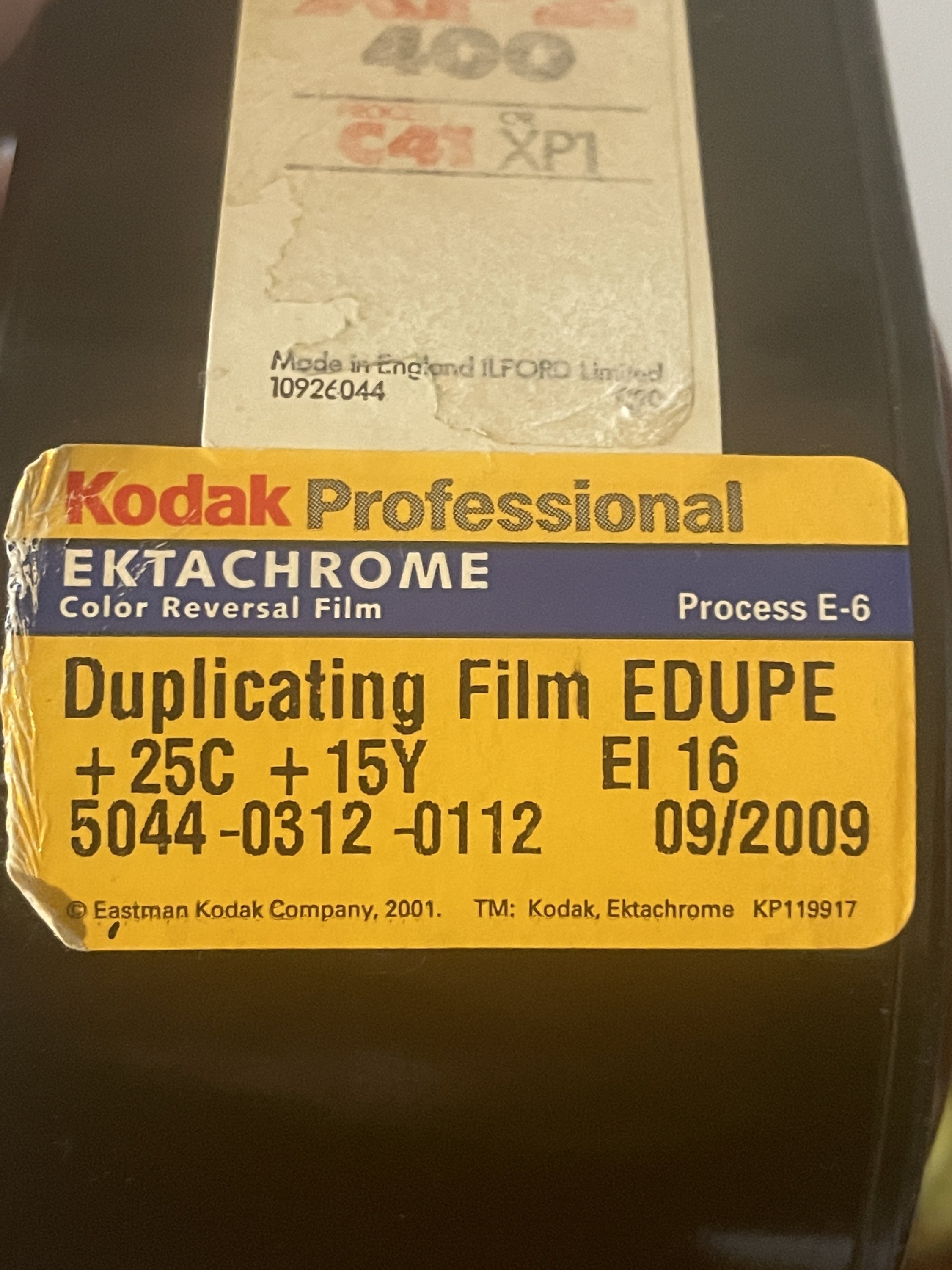

I just picked up an old Lloyd bulk loader which appears to be full of Kodak slide duplicating film circa 2009. The people I picked it up from had no idea what it was so I don’t think they’ve opened it, but I’m wondering if the film would be any good for pictorial use (even if just in B&W). The inclusion of color compensating numbers makes me think it’s an odd batch or something.

It might be usable if it had been frozen the whole time, but out of a bulk loader, not likely. Expect general hue anemia and bad highlight crossover, and that's an optimistic scenario. It was basically a lowered contrast tungsten-balanced Ektachrome, nothing really exotic, but with a specific intended applications, that of slide duplicating. The cc correction numbers were routine, matched to any specific batch itself; nothing odd in that respect. Pretty much worthless for black and white usage - it creates a positive color image.
But if you just want to have some fun fooling around with it, you might start with the given filters and ASA neighborhood of the rating (which will likely have changed, losing sensitivity over time), maybe bracketing exposures in the ASA 8 to 25 range, and then have the roll E-6 push processed for a little higher contrast. It might be appropriate for ghoulish Halloween shots.
But it is continuous spectrum. Otherwise, it would be worthless as a slide duplicating film in the first place. Like I said, it's just a tweaked Ektachrome. The sheet film product was somewhat different, being tungsten balanced and optimized for longer exposure times.

like colour paper of the day, each batch came with compensation numbers, so that labs could confidently start a new batch without having to run a test each roll. take away the old compensation and add the new compensation and you are dialed in.

Give it a try for split-exposure night exposure shots. The typical approach is to make an exposure (maybe 4-10 seconds at ƒ16) when dusk has clearly set in but before artificial lights are all on, followed by a second exposure (perhaps 3-5 minutes at the same ƒ-stop) around 45 minutes later when darkness has descended. It takes some experimentation which will vary with each subject, the amount of exposure each time, and a VERY STURDY tripod. A view camera makes all of this a lot easier, but the basic idea should work with smaller cameras--it would just be a lot trickier. When everything, including luck, is in your favor, the results can be very satisfying, especially the deep blue skies. Years ago, I used Ektachrome 6121 copy film in this manner, but E-Dupe should give similar results. Oh, yes--bring a flashlight!

All you can do is try it... all you'l be out is your time and the cost of processing. However I recall that it's a tungsten-balance film. So use an 85B filter in daylight.

Hard to say, 85A or 85B in daylight. Since there is a greenish offset factor printed on the box, that would suggest maybe the less strong 85A, if all things were still equal. But they aren't. The aging of the film is a wild card.
