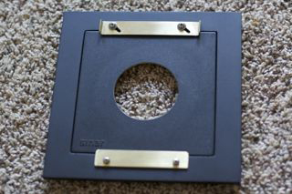

I need a bit of help figuring out exactly what kind of lens board this thing accepts; at first sight I thought it was a Technika adapter but the central hole is the wrong size and the spring clips - here removed - are the wrong thickness; a Technika board doesn't seem to fit it at all. I've been looking at pictures online for a couple days and I haven't found anything that seems to match it. The recessed grooves are 3.865" apart (outside edge to outside edge), the central hole is 2.965" in diameter, and the spacers for the retainter clips on either side are .120" thick and were spaced exactly 4.000" apart. I'm sure someone knows exactly what fits it, but that someone isn't me; apologies for the horrid picture...I had to prop the board on a film canister in order to get the weird groove in the surface to show up.
Pictured: With my luck, whatever fits this will be more expensive than Cambo boards.

Yes, I can do that; it's identical to the back of an undrilled Cambo SC board, which I've shown adjacent for the sake of comparison. The only differences are the size of the central hole and the four tapped screw holes that hold the adapter hardware on the front.
Pictured: They even have the same part number.

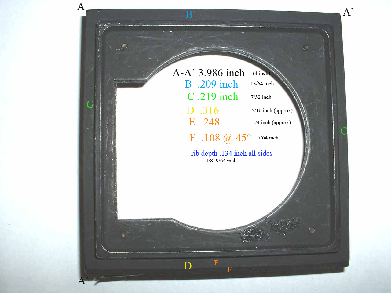

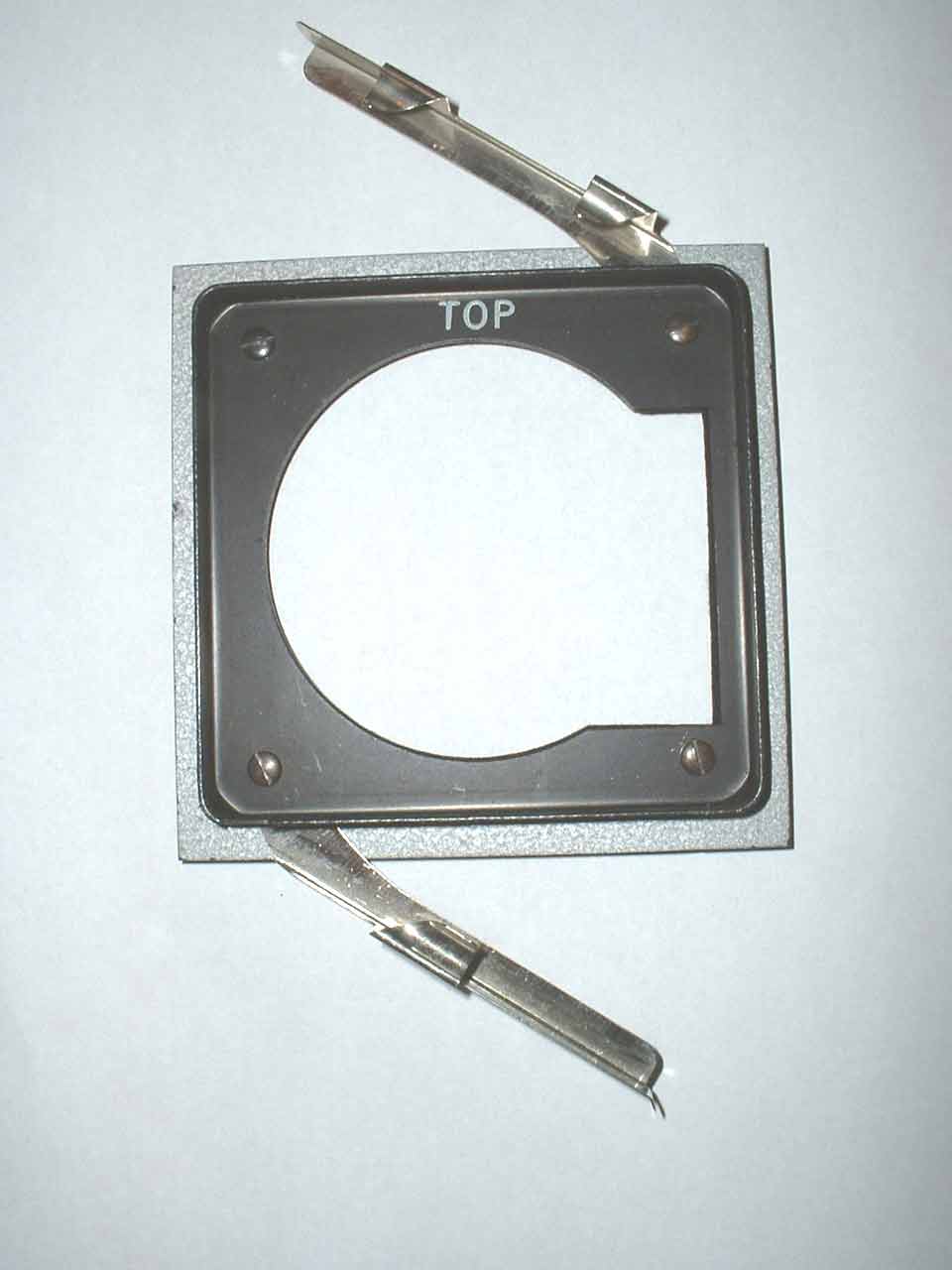

Graphic View uses a 4 inch square lens board. Its board will fit a Cambo but the Cambo board is a few thousands larger than the Graphic View opening and won't work or is a very tight fit depending on the board in use.
Graphic View to Pacemaker 4x5 board adapter front view:
Rear view:

Good to know, and thank you for the pictures! Someone just e-mailed me a picture of the rear of a CC400/Calumet 4x4 board, and it looks like it will fit!
Pictured: It had BETTER fit, that is.
