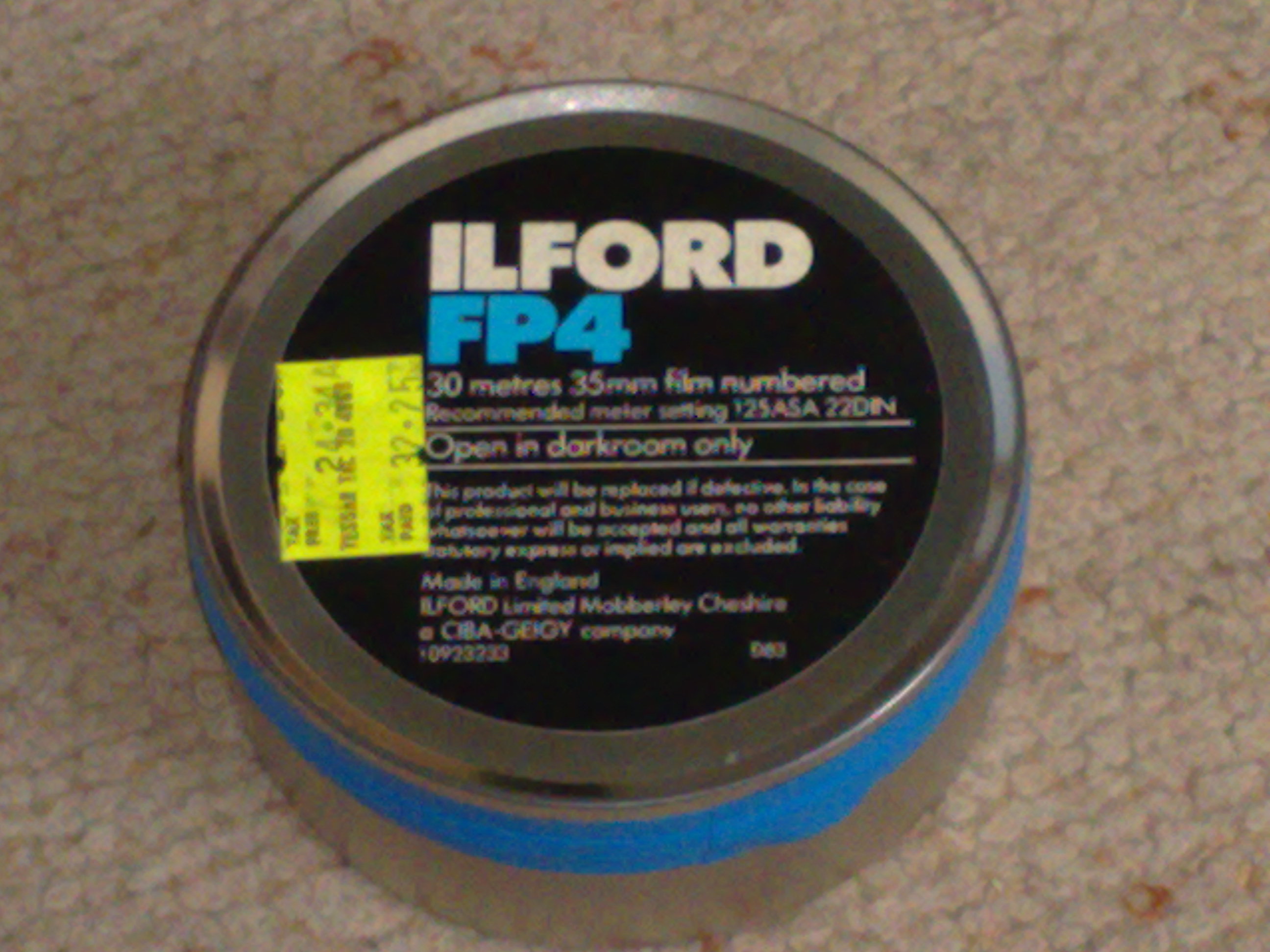

Here is an FP4 tin dated March '89. (Sorry about the poor d*****l image - I took it with my phone). I still have some of this particular film in a daylight loader, which I re-discovered in the top of a wardrobe recently. I have tried some and it is still usable, though I think it has lost about half its speed.
Cheers, Peter.

I belive that is the way that Ilford packed their "private label" stuff back when they still used cans to pack film. (film on a cardboard core) ASA 125 would be FP4.

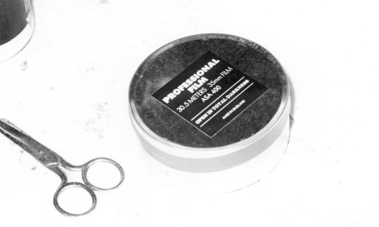

I was going through some negs fro the 1970 era when I came across this one I took just before a bulk loading session, I think the label matches and this was the Freestyle "English Professional" private label film which was understood to be Ilford.
