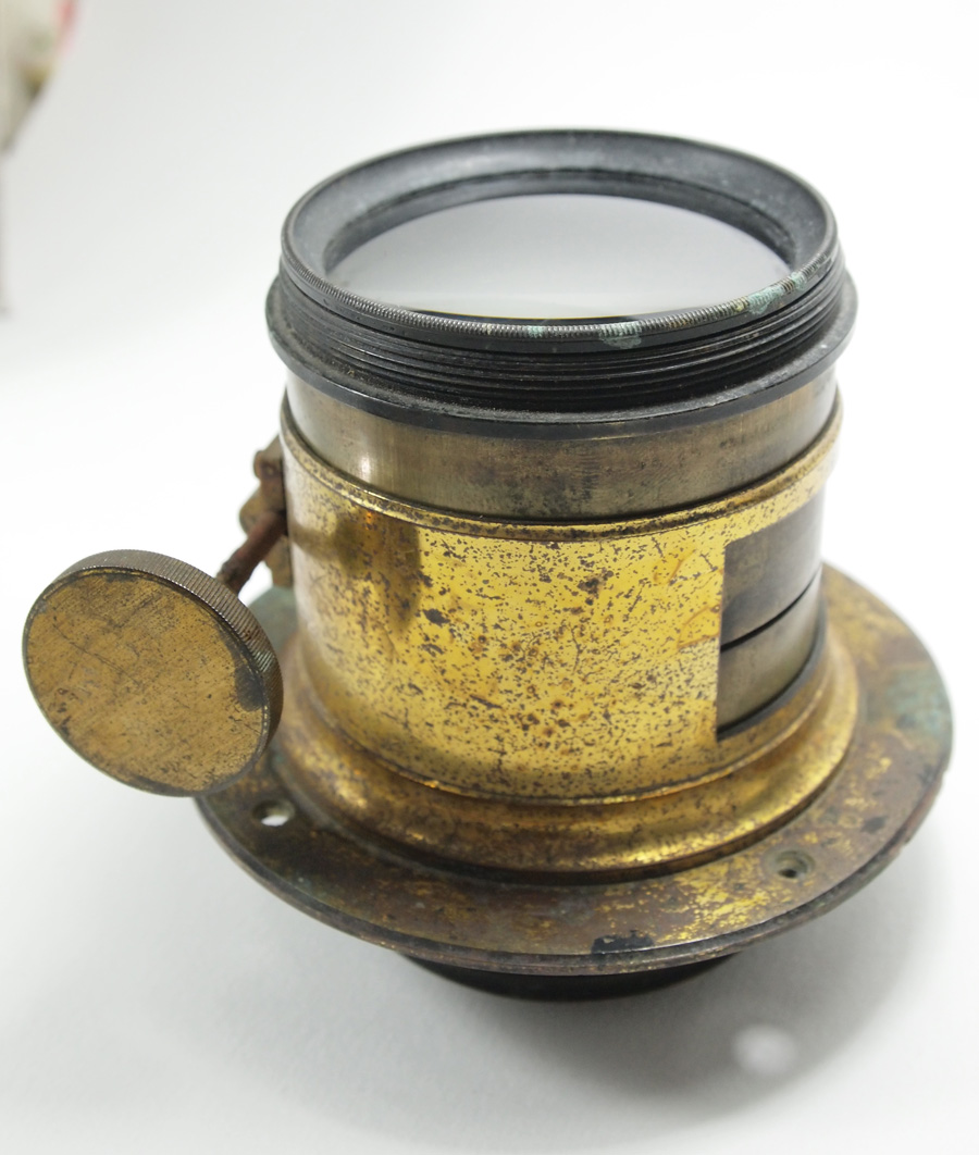

Hi all,
I don't know if it's the right forum, but I would ask help to you, LF brass lenses pundits and photo history exegetes.
Can someone can tell me if s/he know who is the maker/brand of this old camera brass lens ?
Bought on impulse at an Antique fair, the seller didn't know much about it.
and the only visible brand or logo, under the rack and pinion focuser :
I believe this is a cursive L and C and a star...
Thanks for reading !

This likely is a Petzval, but it's not a projection lens. Note that it has a slot for Waterhouse stops. I think it's missing it's lens hood. If you unscrew the front lens group it should be a cement doublet (2 lenses joined together.) The rear should be two single elements with a space between them. If the rear element looks like the front ones, then this is a rapid rectilinear lens. I'm going to take a guess that this lens covers quarter plate.

Some Petzvals sold with projectors etc have a slot for water house stops, I have one. This was because the R-R's largely killed off sales of Petzvals as taking lenses and often remaining stocks were bought by manufacturers of Lantern slde projectors.
Presumably it's a French lens and I'm not familiar with French manufacturers, I bought a small R-R at a antique/Flea market two weeks ago, made in Paris but can't decipher the makers name.

Thanks for your kind reply. There are effectively 4 lenses in two groups at rear and front, and I was thinking about a Petzval lens (or a Pretzel :wink:), the front group is effectively a cemented group.
However, I am a little puzzled with the rear group, which is effectively an air spaced doublet, but it doesn't really match the original Petzval design, as described here : Dead Link Removed
Either this is a Petzval design variant (not Rectilinear, as long as I can tell), or someone reversed the rear group after dismantling it.
@Kent : thanks for your reply, my thinking followed exactly your message, the slot for waterhouse stops designed a taking rather a projection lense, but Ian tell us that was not always true.

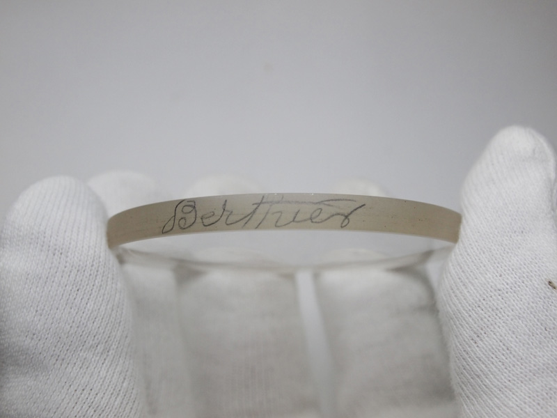

@Ian, @Smieglitz : I can now confirm it is actually a French lens, or at least a lens with french glasses, as I followed the suggestion of Smieglitz, and looked the elements edges, and found a signature at two places ! Just an handwriten name : "Berthier". It's rather a stunning thing to found such "message" on a thing probably more than a century old...
But Berthier don't seems to have been a well known optics makers, I found nothing on it, and still don't know the lens brand.
Many thanks again for your replies.

My thinking is it's a Petzval that someone tried to clean and put it back together out of order.

I'd vote for it being a modified Petzval. As this page from the 1890 Ben. French Catalogue (found Dead Link Removed, thanks to Dan Colucci) clearly states, photographers have pernicious habits of taking lenses apart and screwing them up! There were many variations on the design tried by lens-makers during the 19th century. [video]http://www.antiquecameras.net/petzvallens.html[/video] has extensive material if you're interested.

The design of my lens looks like a little the Dallmeyer portrait lens, as described on the petzvallens page. However i am inclining too for a mistakenly remounted Petzval. The fact that this lens was very clean for its age when I found it is aiming me this way.
A check procedure will be to mount it on a camera and see what I get on the groundglass, but I haven't the appropriate lens board for now.
Best regards,
Raphael
