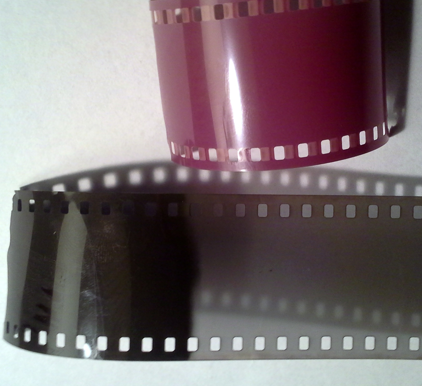

Purchased a bulk film loader from a second hand store with film in it!
Shot a couple rolls but nothing sticks . The developer washes everything out.
The lead of the roll comes out dark but the rest is see through.
Tried the two extreme film speed 15-1600.
Tried different cameras
tried different developer.
Tee film looks like Fomapan but...
Any ideas?
here's a pic
I've not seen purple/pink Fomapan.
It possibly might not be B&W film...but still very strange if nothing comes out on development. If the leader comes out dark, that suggests that it is responding to light and to the developer. Have you ruled out a camera fault?
Tried 3 different cameras. It must be B&W if everything washes out and if you can see through.

From what you describe, the leader (exposed to direct light) is coming out black/dark and the rest of the film is clear. Not even any edge letters or numbers - though some films have none. That suggests that the film is reacting to the direct light and the leader is being developed as expected. There is a chance that it is an ultra slow emulsion, 6ISO such as Kodak Precision Line. If outdated, people expose this as low as 2 or 3 ISO.
Is anyone able to identify the film in the picture? I've never seen a B&W film that colour, but I certainly have not seen all B&W films.

Nothing comes out on the edges. There is a faint frame line on one shot.
I will try to shoot at the lowest ISO I can dial in.
This roll might be 20years old or older
I have some Dektol and a whole arsenal of diy chemicals but why would that change the results.
I am leaning towards Agulliver's theory. looks like I am not getting enough exposure

That color on the unprocessed film reminds me of Kodalith Ortho Type 3.

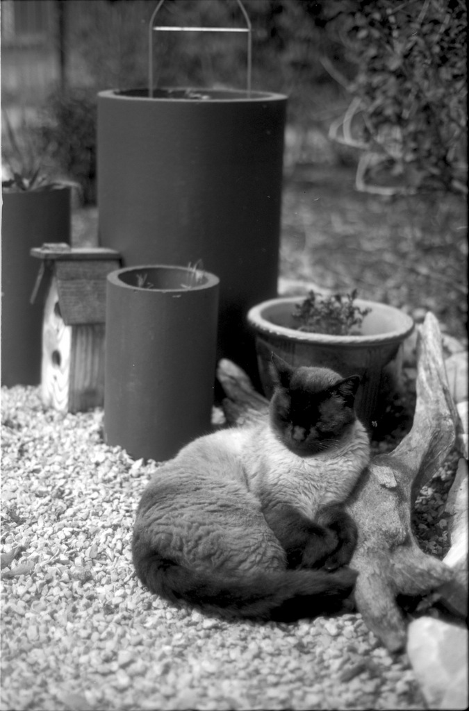

Success!!
Thanks to
jnanian and Agulliver and drkrmike
Took a piece of film and processed as if I was making a print.
I was set up to print Ilfospeed RC3 for 15secs.
Did that and tray developed with Dektol 3:1 for 20min and fix for 15 min.
NOw would that translate to the camera settings... Mmmmm

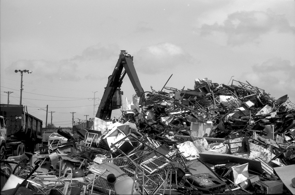

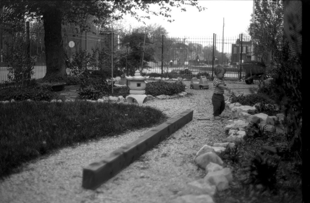

I will throw in my opinion as Kodalith Ortho
This is that same film shot at EI 12. It was probably developed in D76 since that is what I was using in 2014
At the bottom of this http://wp.me/p2ZmXf-3p8 52rolls.net post I did back in 2014 you can see some more examples. This is one of my favorite films because it renders metal perfectly.
